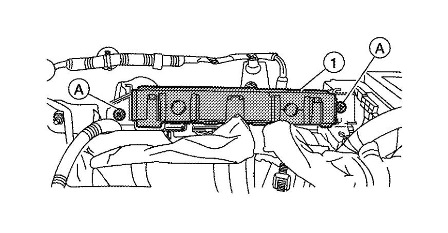

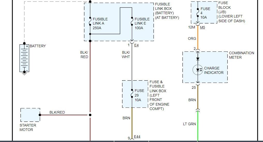

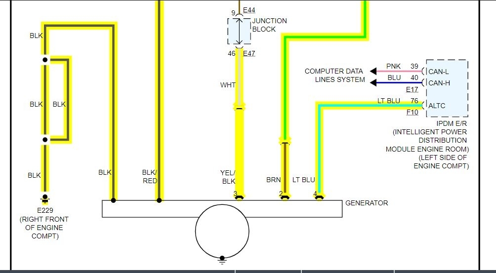

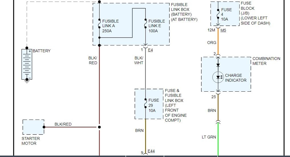

Good evening,
There is a module called the intelligent module which also is called a body control module. It does have an influence on the alternator system. It turns the alternator on and off based on load.
This could be the issue but needs to be verified.
My suggestion is to tell him that if you give him the okay to replace it, it must fix the issue. If it does not, tell him you will not pay the bill.
I attached diagrams for you to view.
