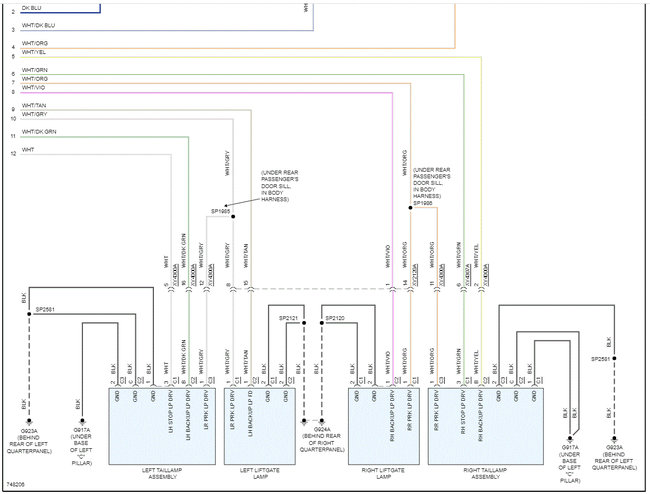

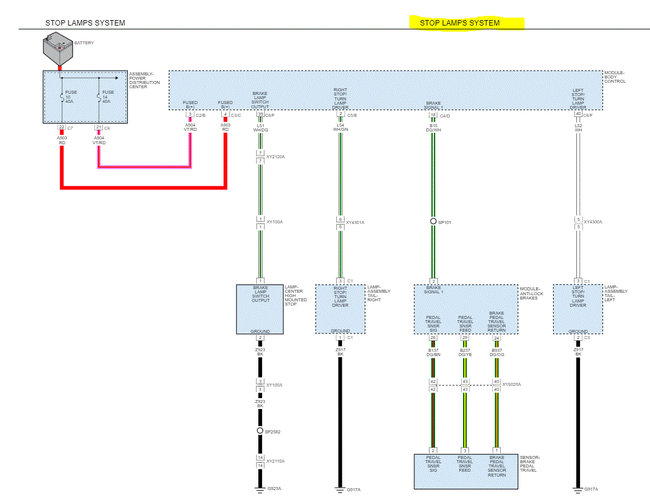

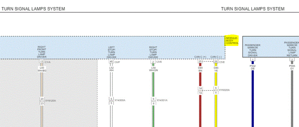

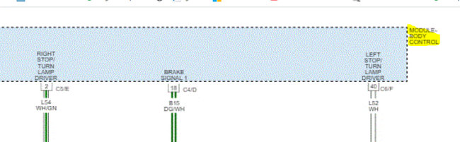

I have a problem with BCM some of the backlights do not work and after checking it was found that it was a malfunction in BCM. my question is, how do i find the backlight lines in the BCM map specifically stop lamp and the turn signal. Help

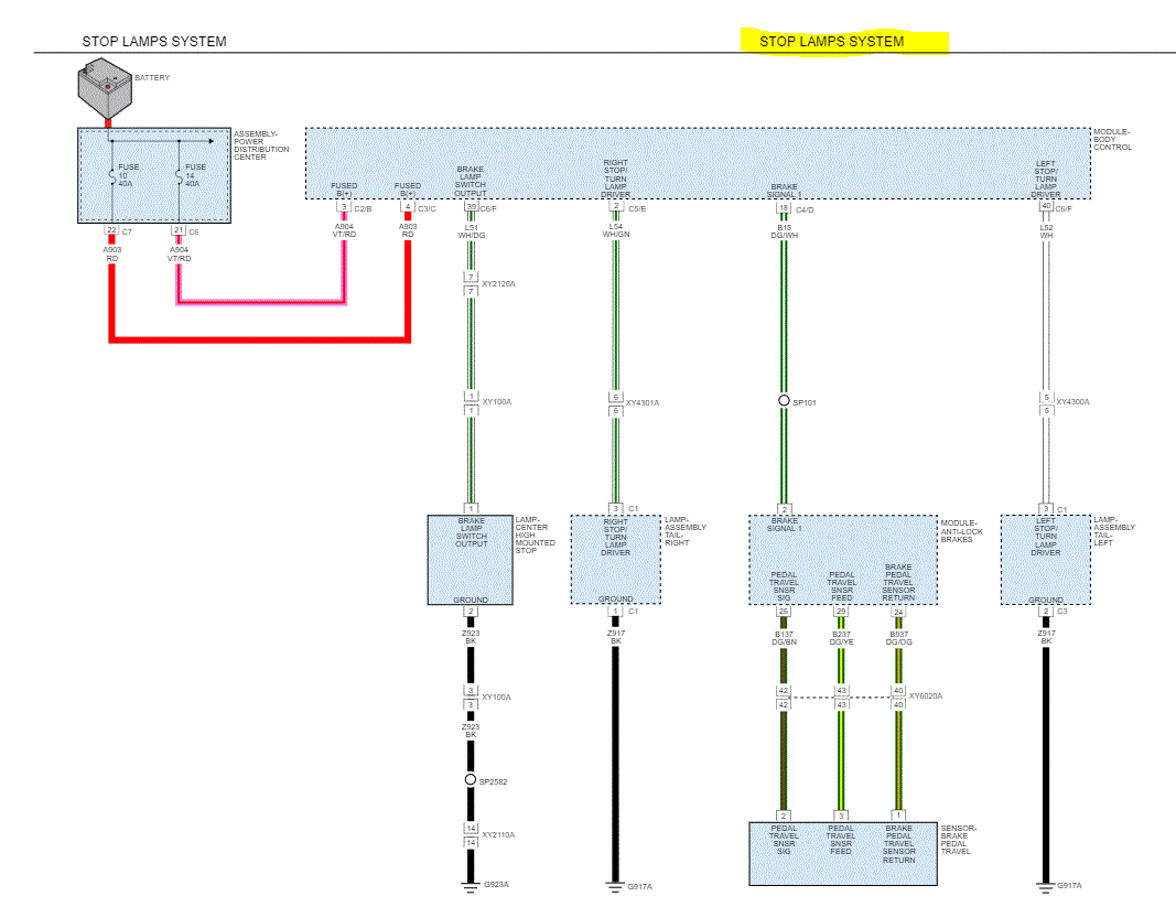

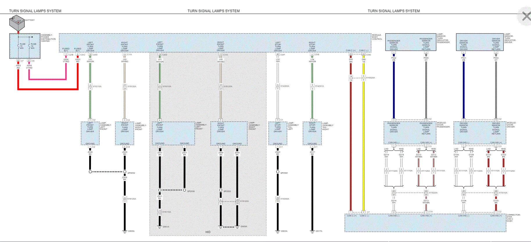

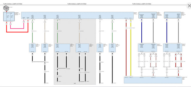

Regardless, I have attached the wiring schematics requested. One pic is of the signal circuit and the other is for the stop lamps.
Here is a link you may find helpful when testing:
Let me know if this is what you needed.
See pics below.

Are these diagrams for BCM on the vehicle listed above?
Mar 11, 2022 at 5:54 AM

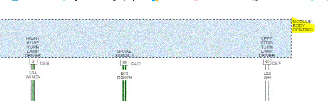

Yes, they are the specific circuits you requested and how they work with the BCM.
See pics below.

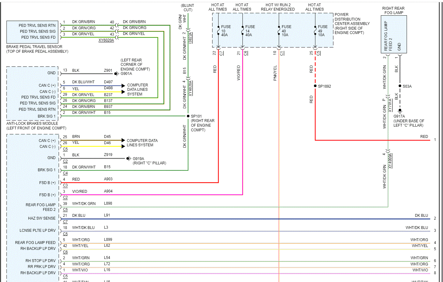

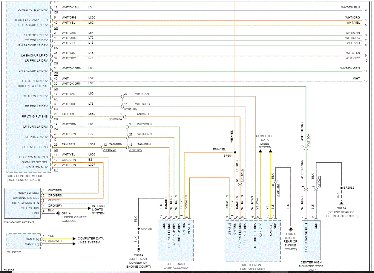

Thank you very much. You helped me. Can you provide me with a complete schematic of the taillights inside the BCM of my vehicle listed above?
Mar 11, 2022 at 1:57 PM
Are you referring to the printed circuit board in the BCM? That isn't something I would have. I do have the wiring schematics for the exterior lighting, but I need to know if you have an HID or non-HID lighting system.
Let me know if that will help you.
Mar 11, 2022 at 3:41 PM
DHEYAA
  • 4 POSTS

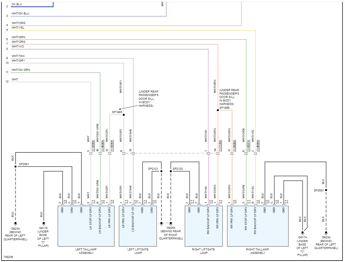

I need just for exterior lighting. Or for taillight.
Yes, hid light system. This number BCM 68438 337AD.
Mar 11, 2022 at 9:12 PM

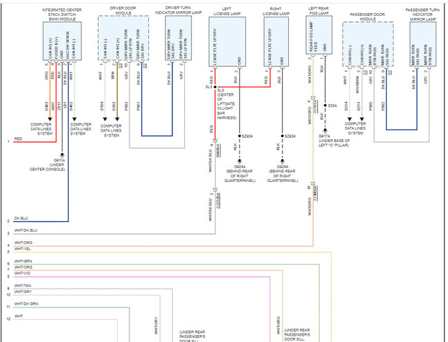

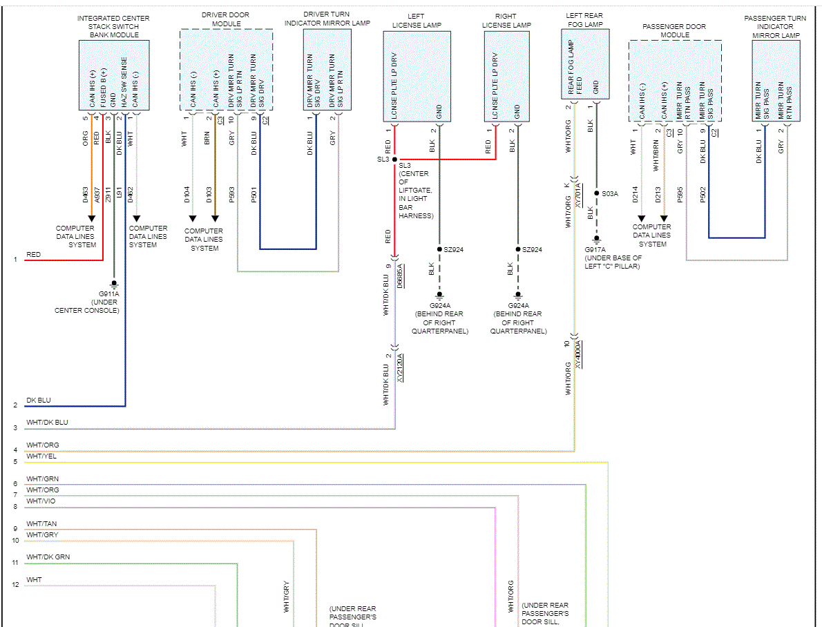

No problem. I attached the schematic below for the HID system. Note that the schematic is two pages long in my manual. I had to check each in half to make it readable for you. However, I did overlap them so you can follow from one to the next.
Let me know if this helps or if you have questions.
See pics below.
