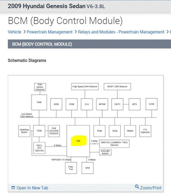

Based on the VIN, you have the V6. Is that correct? If so, the reason you are likely having trouble is that they refer to the BCM as the instrument panel module. See pic 1 below.
I suspect you are looking for part number 954003M022. However, I would like that confirmed with a dealer.
Let me know if that helps.
See pic below.

I wouldn't recommend it. The parts are different internally and likely you won't be able to program it to your vehicle.
