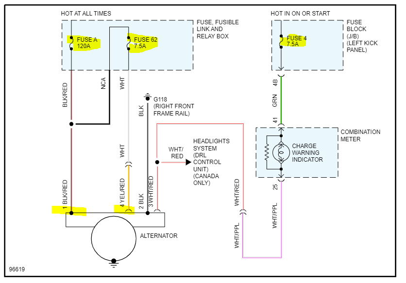

If the alternator isn't charging, it can be caused by a few things. First, we need to check if the alternator is getting power from the battery.

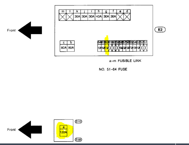

There are three fuses to consider. If you look below, I attached the wiring schematic for the charging system and highlighted the fuses to check. If the fuses are good and have power to and from them, move to the alternator and check the wires indicated for power. They should have power at all times.
Let me know what you find.
