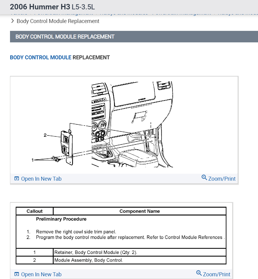

It is common when this problem happens that the BCM has shorted out. But to be sure we should do a CAN scan; you can get a CAN scanner (Controller Area Network) which will work on most cars from Amazon.
Here is a video to show you how:
https://youtu.be/u-4syLc-ifQ
and
https://www.2carpros.com/articles/resolving-reverse-battery-connection-in-cars-a-step-by-step-repair-guide
Here is how to change the BCM out, you can get a preprogrammed unit by searching Google or Ebay. Check out the images (below). Please let us know what happens.
