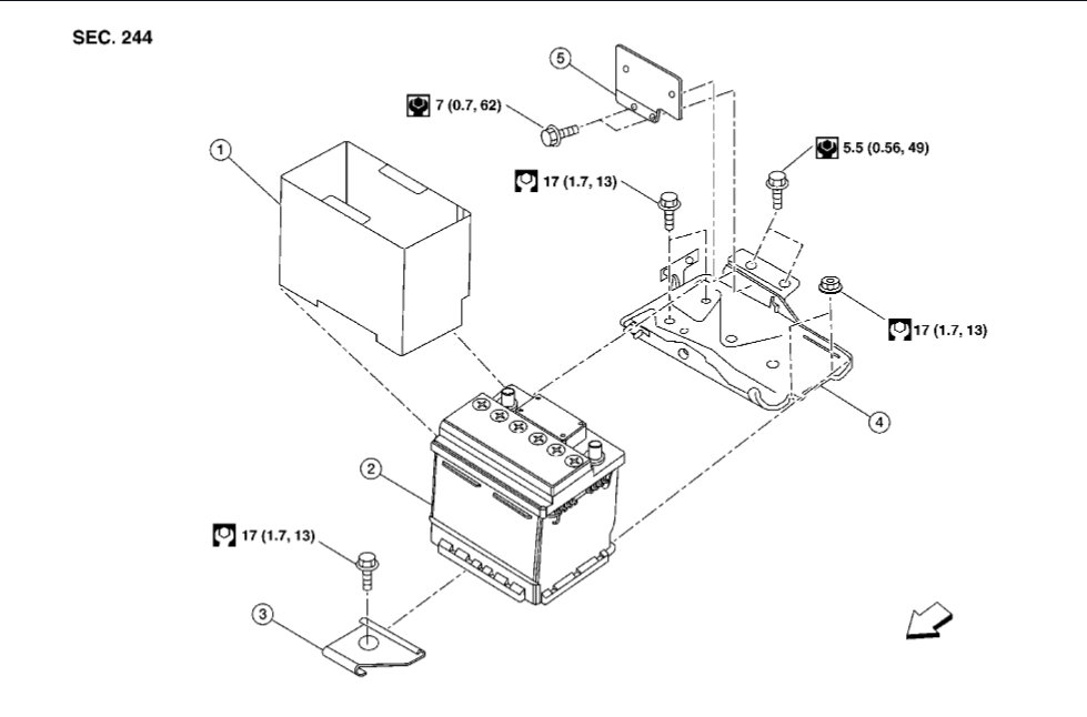

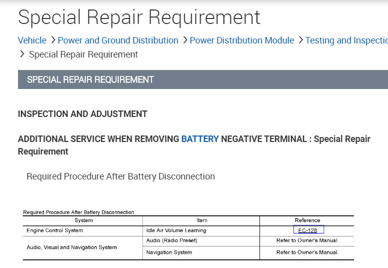

I have a 2015 Versa Note with manual transmission and ordinary ignition key and need to replace the battery. What battery do I need? Does the 2015 Versa have multiple different batteries depending on the transmission? What is the difference between the batteries? I was told that using the incorrect battery would result in the Engine Fail light to remain on. No help from the Owner's Manual re type of battery. Thanks for any help.
