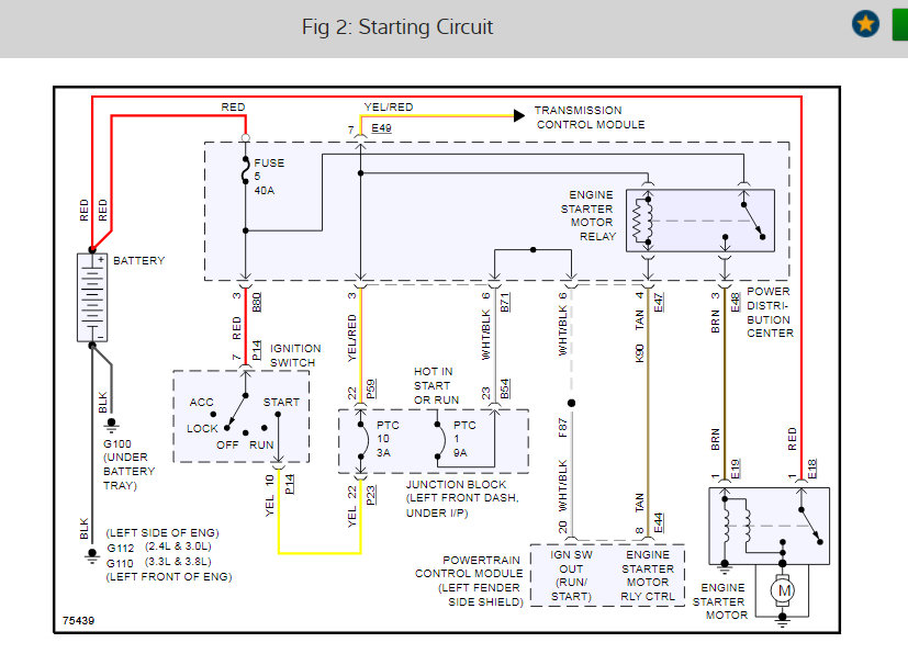

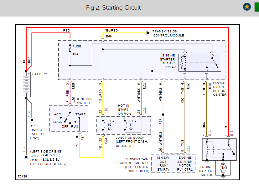

Vehicle runs fine, but suddenly won't start yesterday. Battery is 100% but there no crank. Whenever you turn the ignition to start, you will hear click sound in the relay module underneath the dashboard. A tower was able to start it though when he put the gear on neutral, pushed it forward a bit, then backward, and started to start it, and it started in one try. When i drove the van home, i turned the engine off and tried to re-start the engine, the same thing happened,, seems like there's no contact in the ignition switch to start the engine, but the relays make a click sound each time the ignition switch is turned to start the engine.
