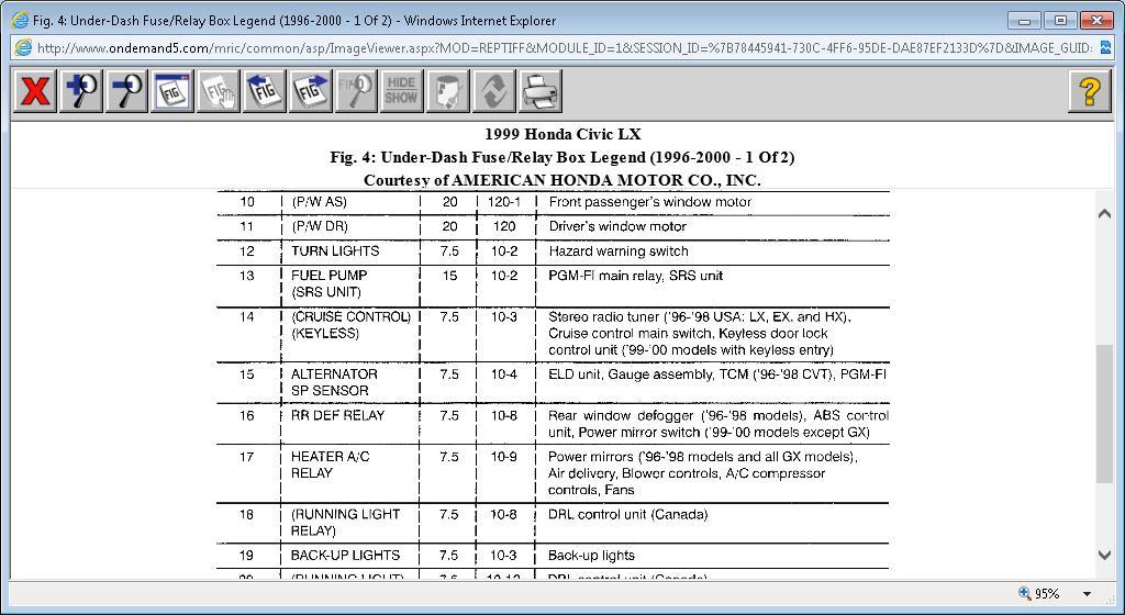

Yep tried that. Do you know if the oxygen sensor is on that same fuse as the alternator for a 1999 Honda civic? Still trying to find the problem.

Which exact fuse is blowing?
Jun 30, 2013 at 5:53 PM
AUGMAN3
  • 8 POSTS

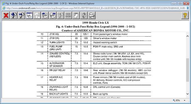

7.5 amp fuse number 15
Jun 30, 2013 at 9:08 PM
AUGMAN3
  • 8 POSTS
which is labeled alternator and vehicle speed sensor but I am wording if it is in the same circuit as the oxygen sensor because that is the computer code that is coming up.
Jun 30, 2013 at 9:11 PM
SATURNTECH9
  • 30,869 POSTS
sorry for the long delay I didn't get a email alert you responded I just saw your reply I posted what that fuse powers doesn't power the o2 sensor.
