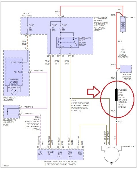

Sending you a diagram.
It shows fuse numbers and their locations to check.
I also circled a much overlooked item that leaves folks scratching their heads. "Mr. Fusible link"
Many times a fusible link will show bubbled up insulation, be burnt slap into, or since the wire inside maybe burnt in half and not really show externally, if you pull on the (empty) insulation it will stretch out like a rubber band.
You might also perform a continuity test through it.
If indeed you need to replace it, replace it with the same size/rated fusible link. Cheating and just tying the wires together, might leave you watching your vehicle burn to a crisp on the side of the road!
