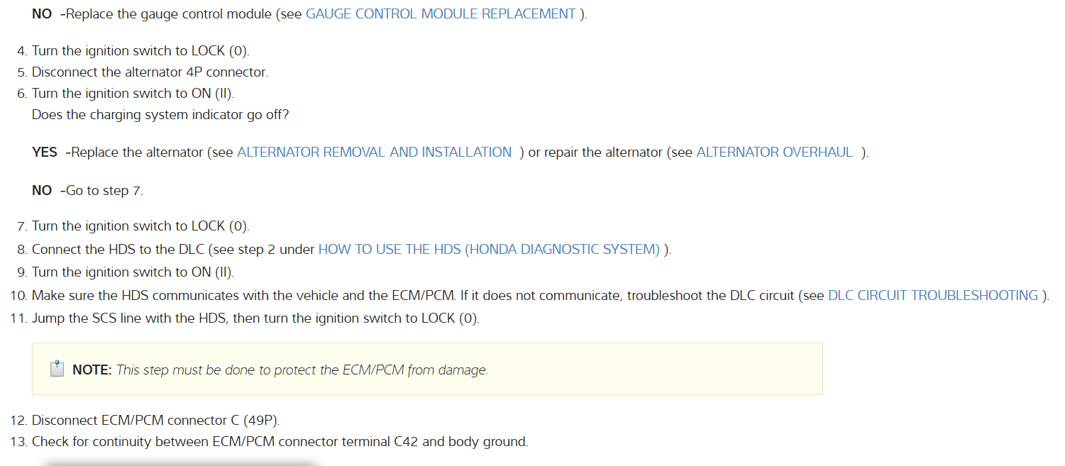

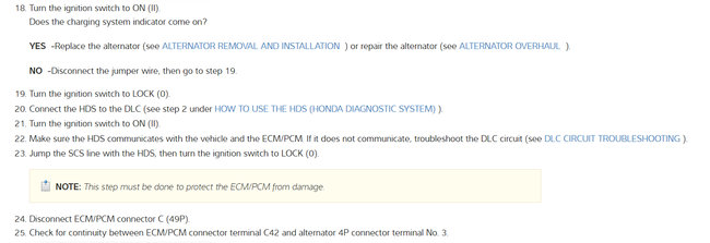

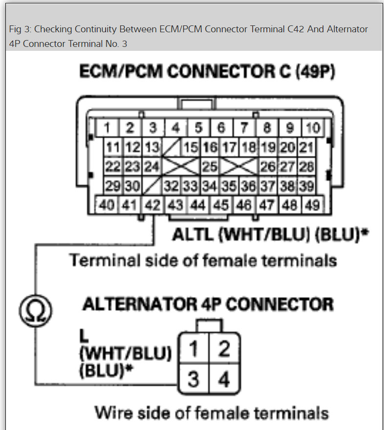

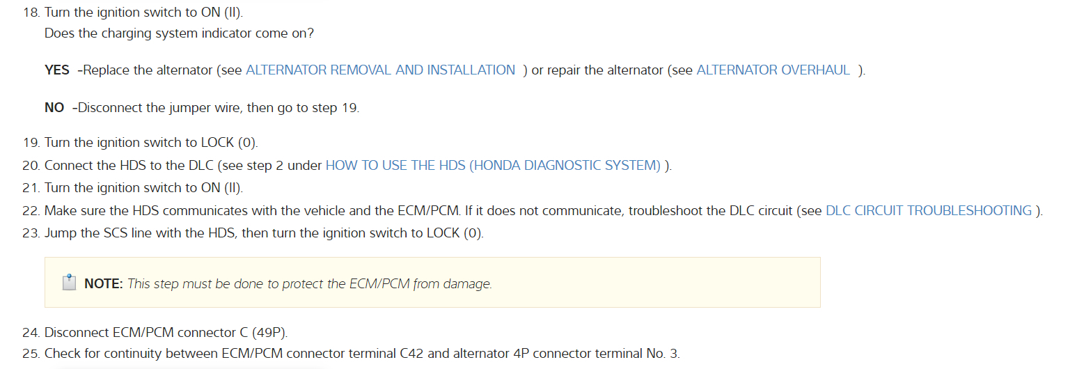

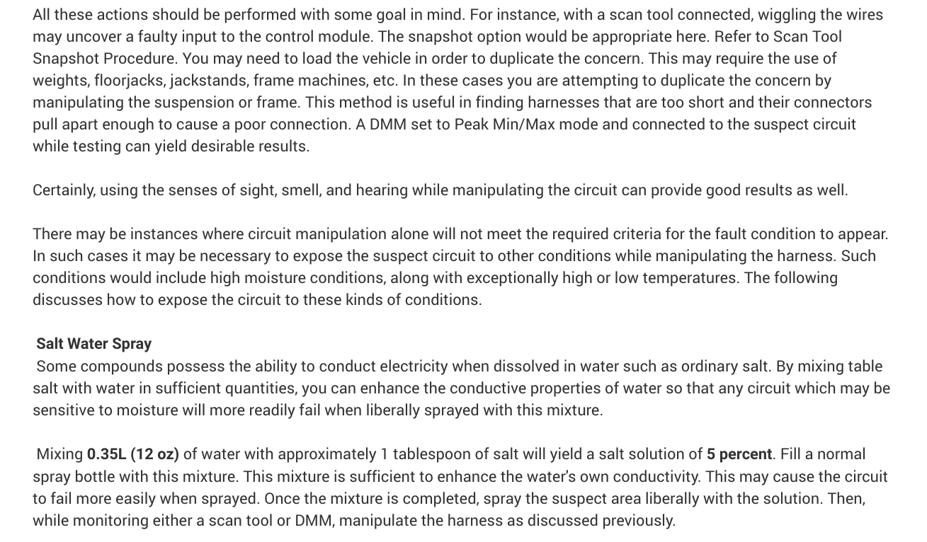

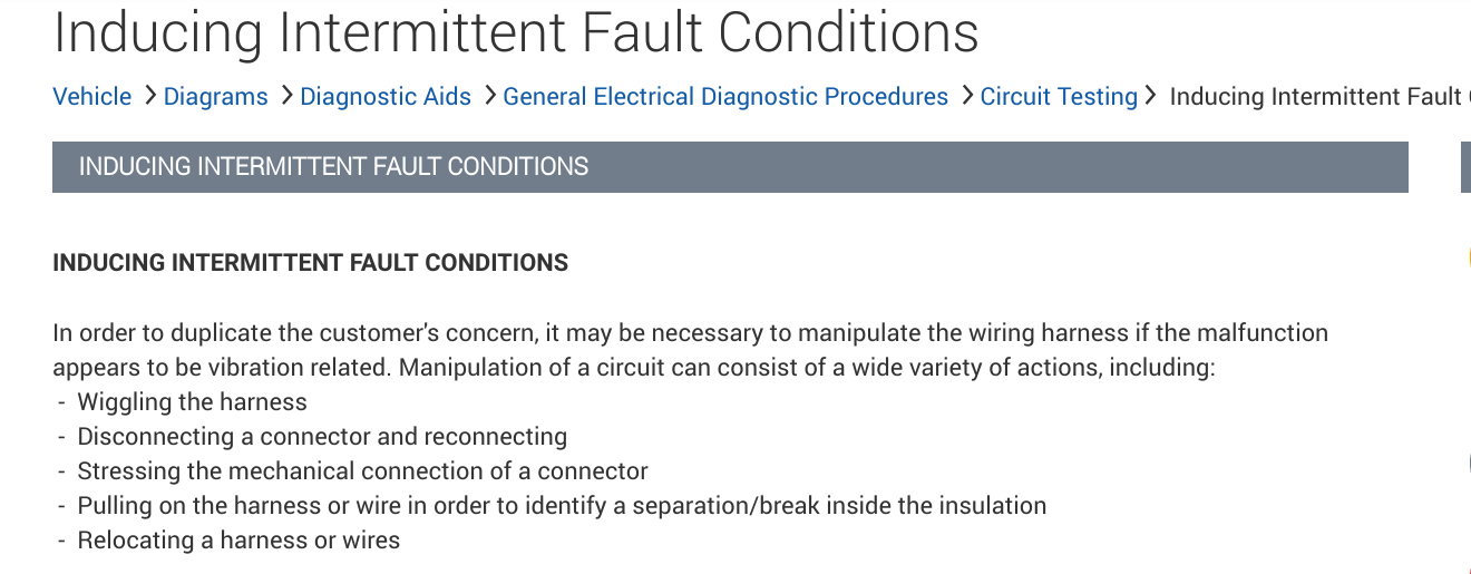

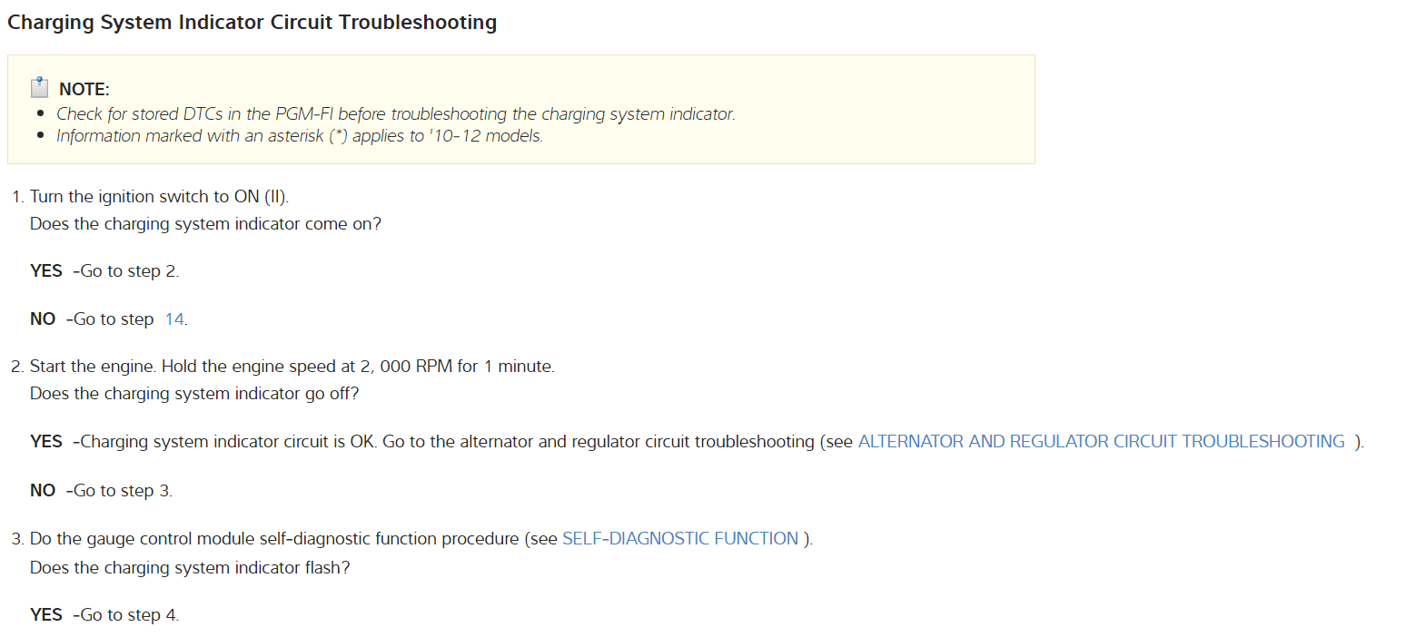

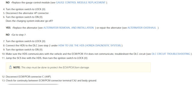

This might be a problem with the serpentine belt tensioner. I have included a guide and a the diagrams below a charging system flowchart that should enable you to track down the problem. Go through it and let us know what you find out.
Check out the diagrams (Below). Please let us know what you find. We are interested to see what it is.

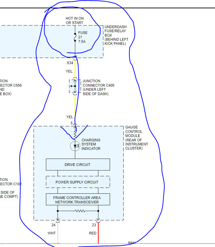

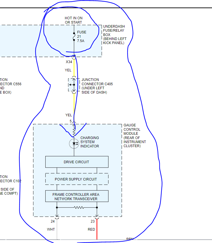

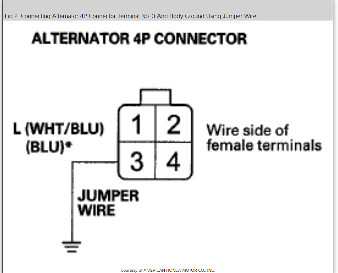

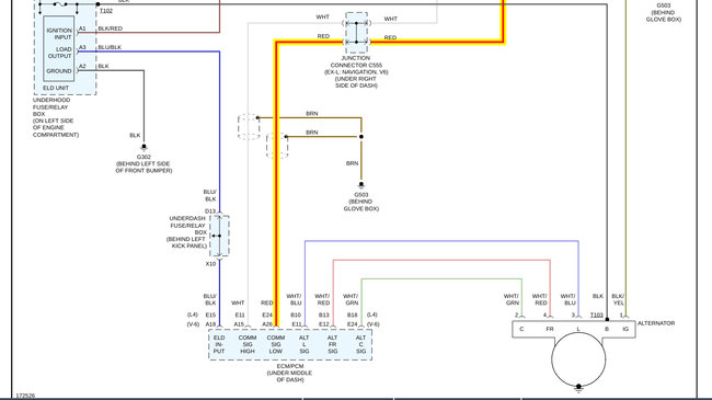

Tim, check fuse 21 in the under dash fuse box. It is a 7.5 amp fuse that most likely blew when it was over charging.
See the attached schematic and let me know what you find.
Aug 25, 2020 at 12:03 PM (Merged)

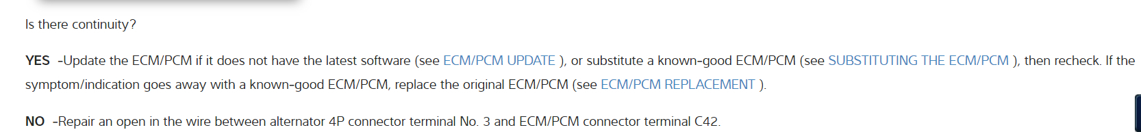

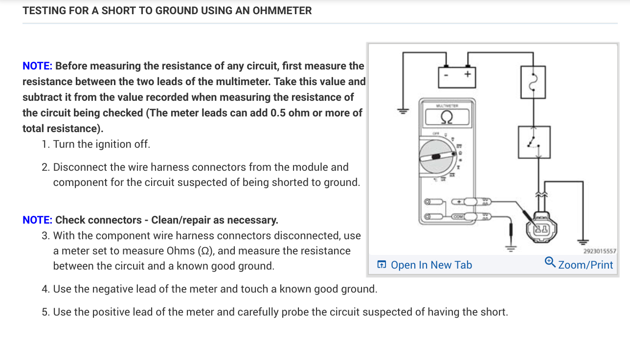

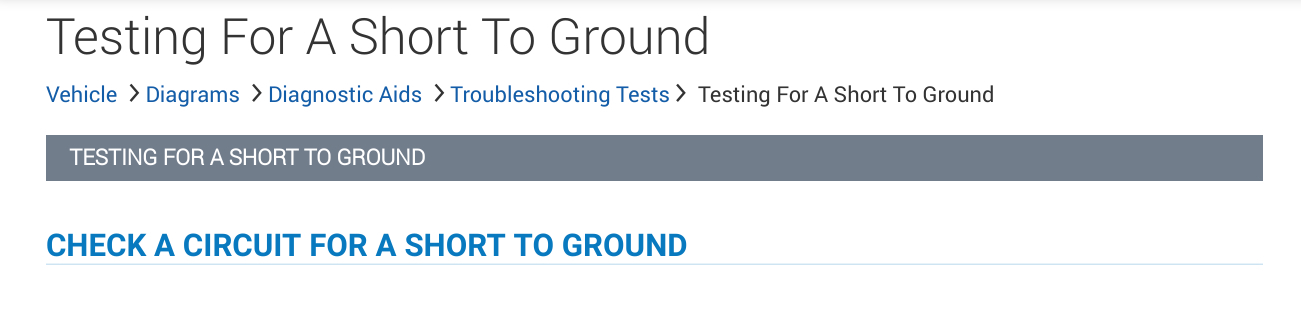

SCGRANTURISMO
  • 4,897 POSTS

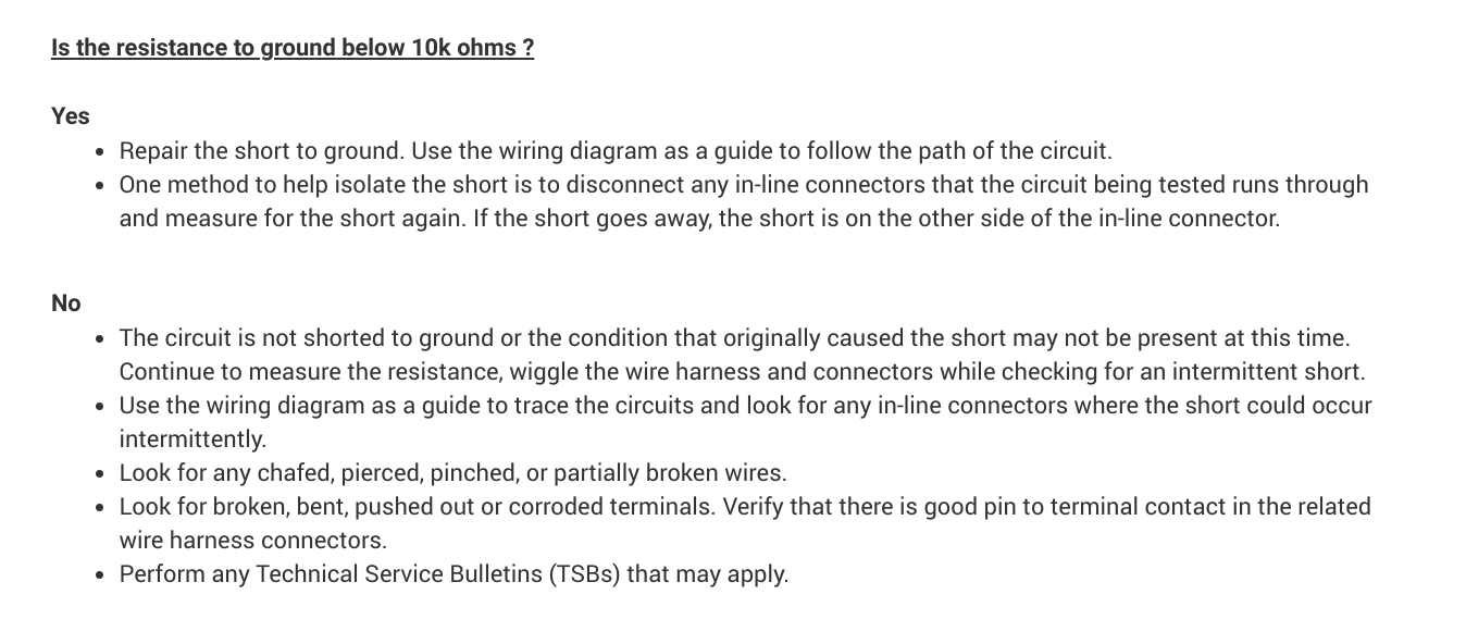

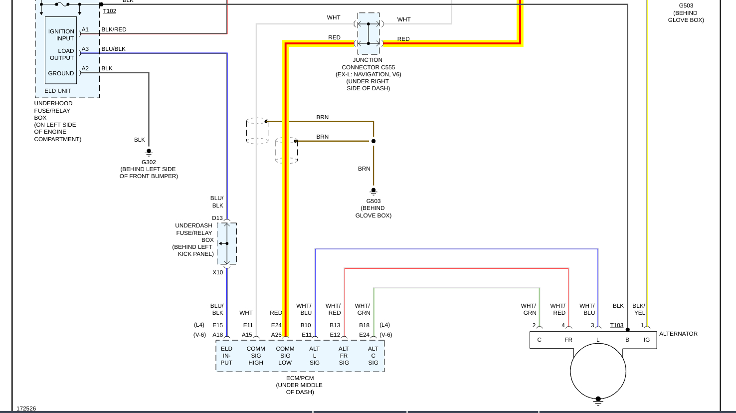

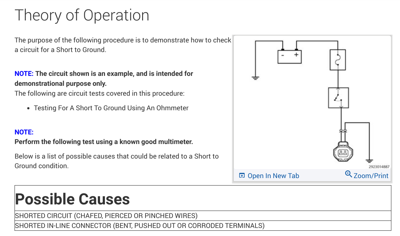

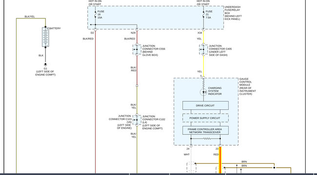

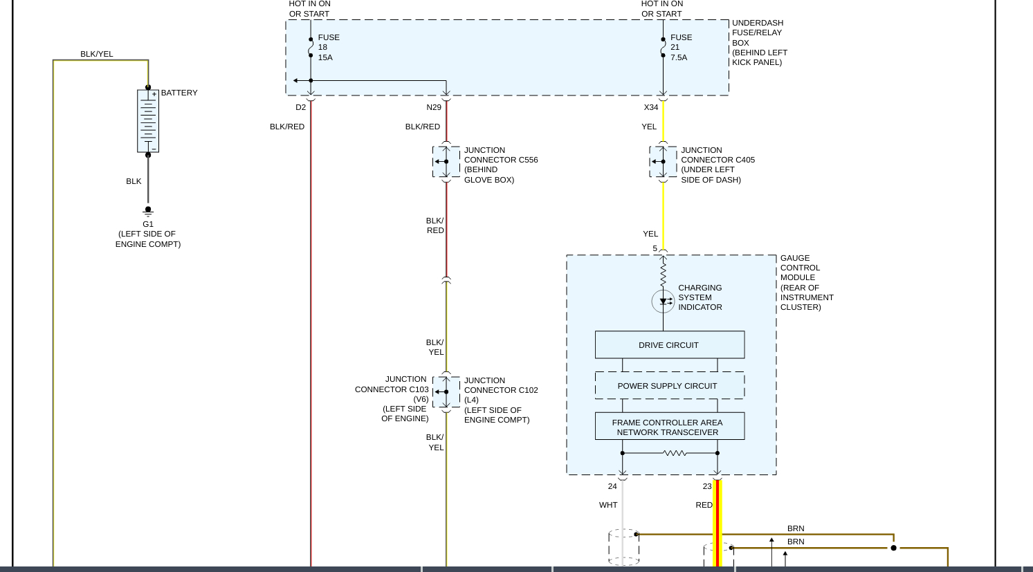

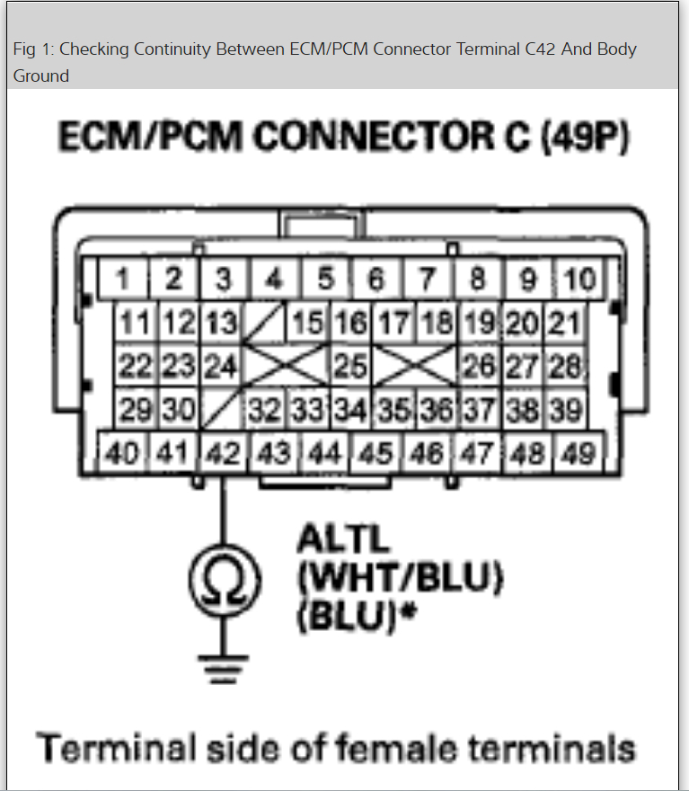

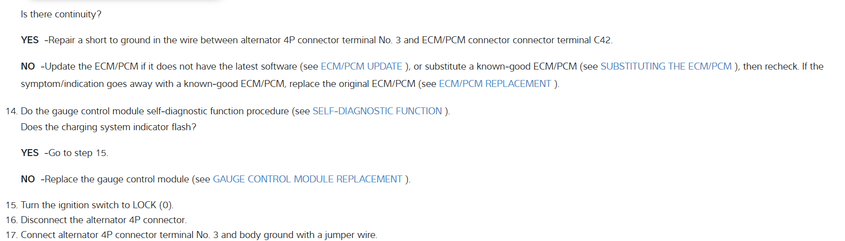

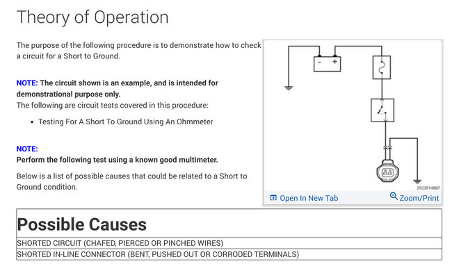

This could be a problem with the shielding on the highlighted wire that is on the charging circuit wiring diagram that I have included for you in the diagrams down below. I have also included a guide on how to find a short to ground and how to induce intermittent conditions in an automotive electrical circuit for you as well. You will need to use a Digital Multi-meter to use these guides, so here is a link below explaining how to use one, if needed:
If the shielding around the wire is okay then there is also a possibility of an intermittent short to ground in the highlighted wire in between ECM/PCM and the gauge control module causing the warning light to illuminate. Please go through these guides and get back to us with what you are able to find out.

TIM MILLER2
I checked the #21 fuse and it was not blown. I will look at the other items you suggested next. Thank you.
