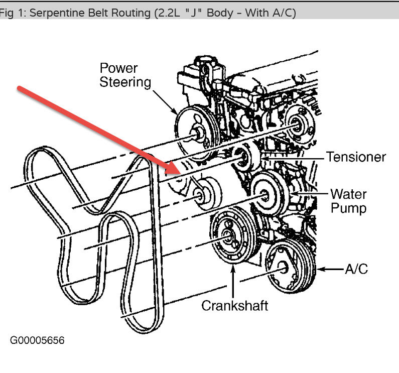

Where is the belt tensioner on my car?
Jan 18, 2017 at 8:41 AM
HMAC300
  • 48,601 POSTS
see picture arrow points to it.

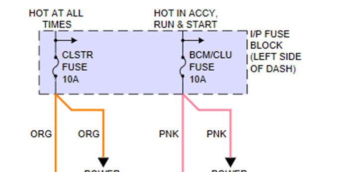

Which fuses should I check first to see what causes the battery light to come on?
Jan 18, 2017 at 12:09 PM
HMAC300
  • 48,601 POSTS
the fusible link off of starter like I said in first reply and the two in picture.
