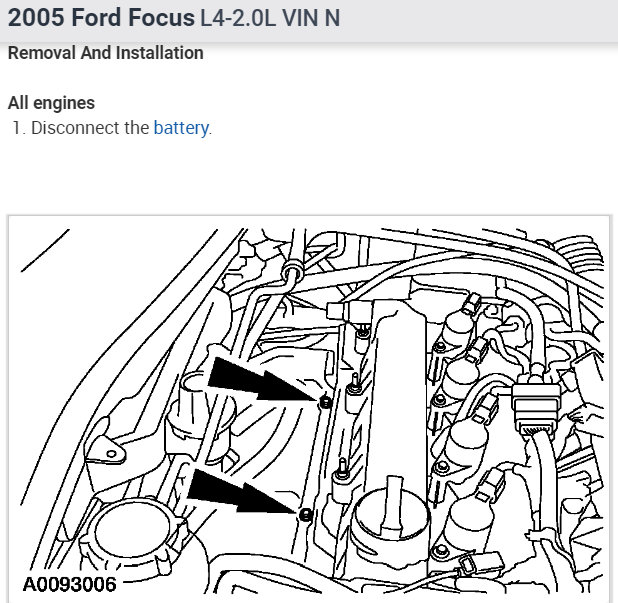

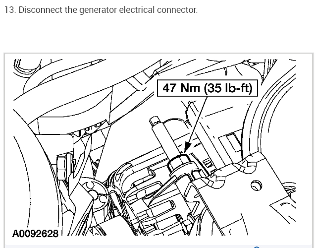

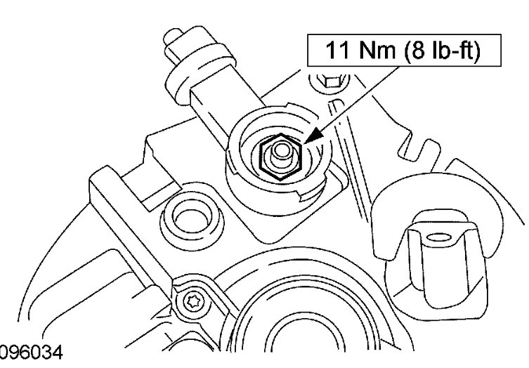

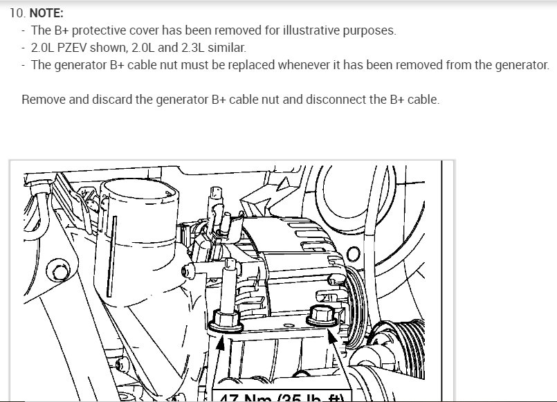

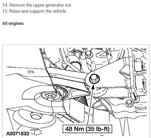

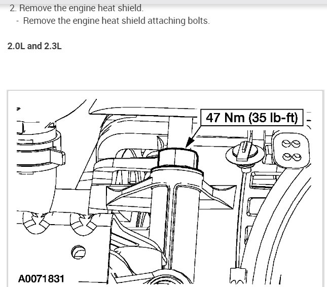

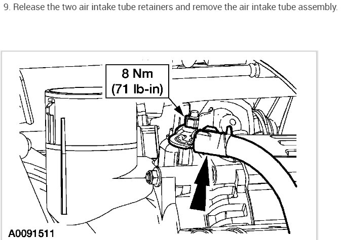

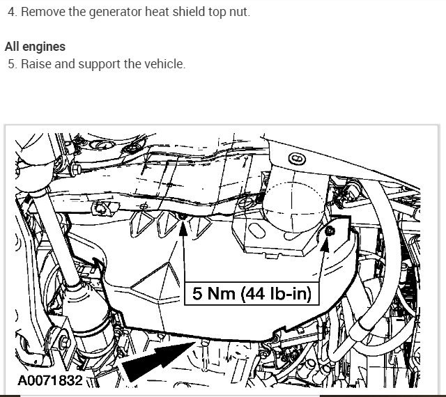

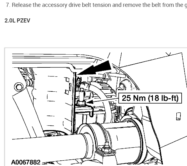

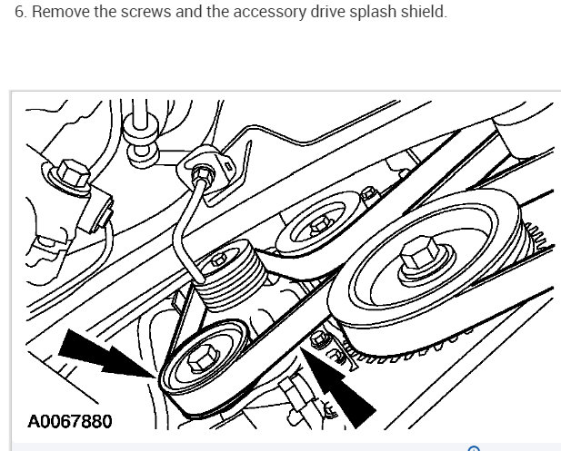

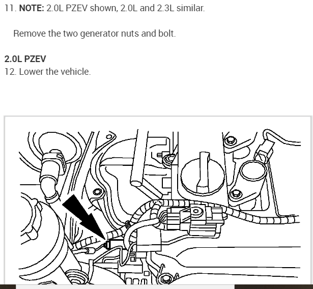

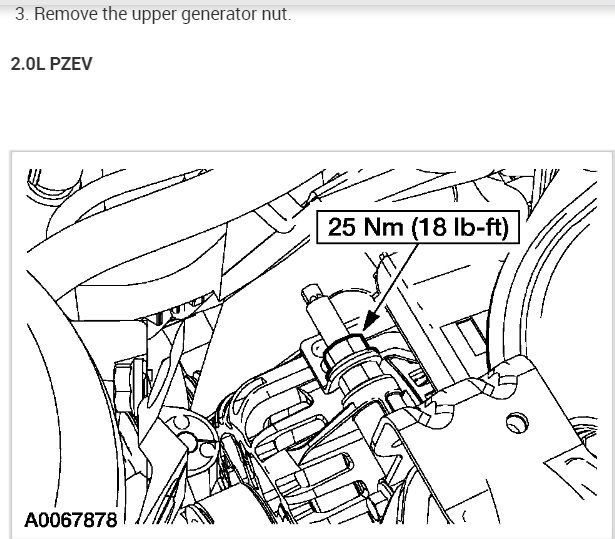

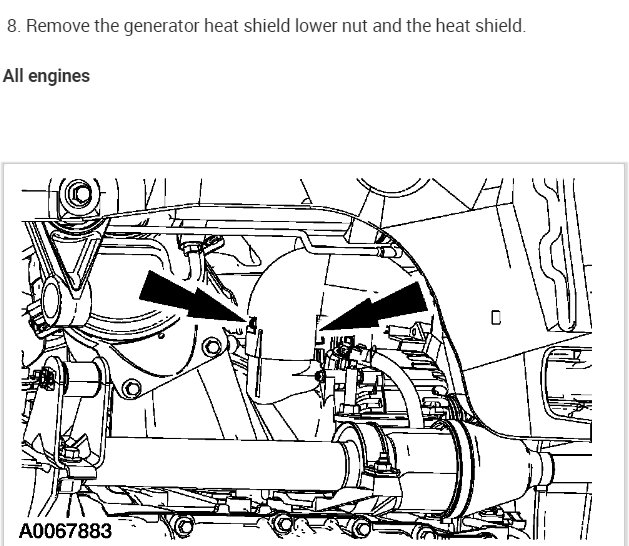

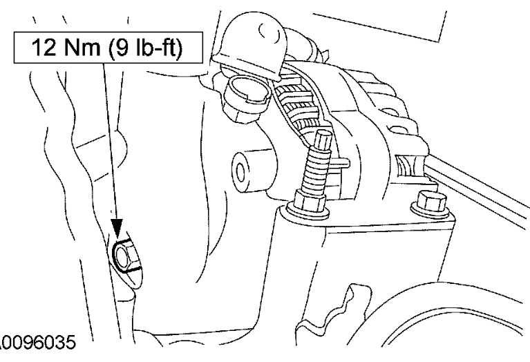

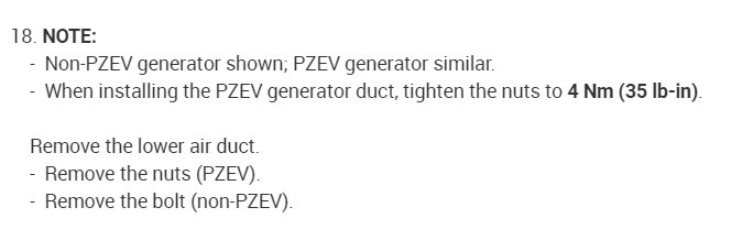

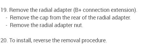

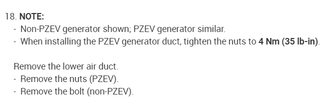

It sounds like you have a weak or defective alternator. Most local auto parts stores will test for free.Here are tutorials for showing you how to remove the belt and the alternator:
https://www.2carpros.com/articles/replace-serpentine-belt
The output of the alternator should be between 12.5-14.5 volts. I've attached picture steps below on how to remove and replace for your Focus.Hope this helps and thanks for using 2CarPros.
