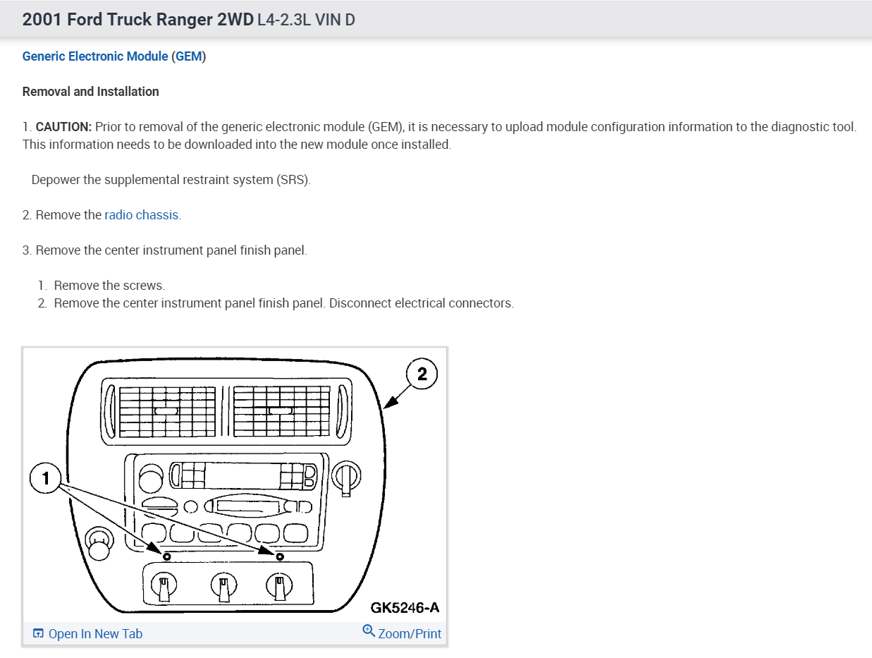

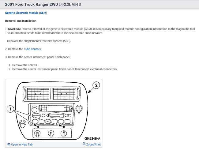

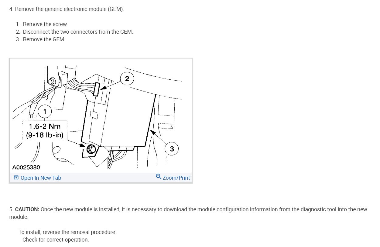

I have seen the GEM module cause this due to lack of shut down ability. This guide can help as well with the GEM module location in the diagrams below:
https://www.2carpros.com/articles/car-battery-dead-overnight
