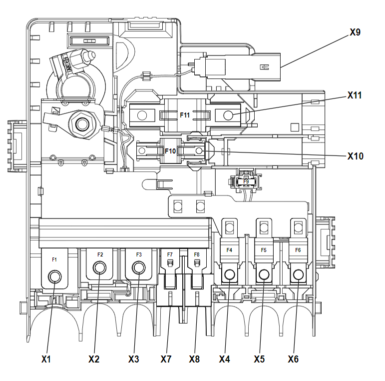

I have a question, "Connect both jumper cables to positive?" Do you mean both negative and positive were hooked to the positive side of the battery? Here is a guide to help test for power at the maxi fuses so you can see which one needs to be jumped/replaced:
Test at the arrows in the diagrams to make your jumper to it and the positive side of the battery. Check out the images (below). Let us know what happens and please upload pictures or videos of the problem so we can see what's going on.

I have a question, "Connect both jumper cables to positive?" do you mean both negative and positive were hooked to the positive side of the battery? Here is a guide to help test for power at the maxi fuses so you can see which one needs to be jumped/replaced.
Test at the arrows in the diagrams to make your jumper to it and the positive side of the battery. Check out the images (Below). Let us know what happens and please upload pictures or videos of the problem so we can see what's going on.
