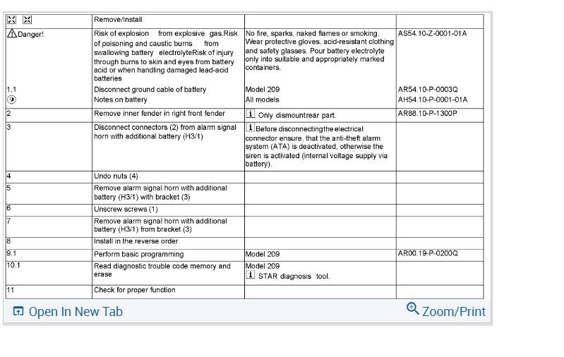

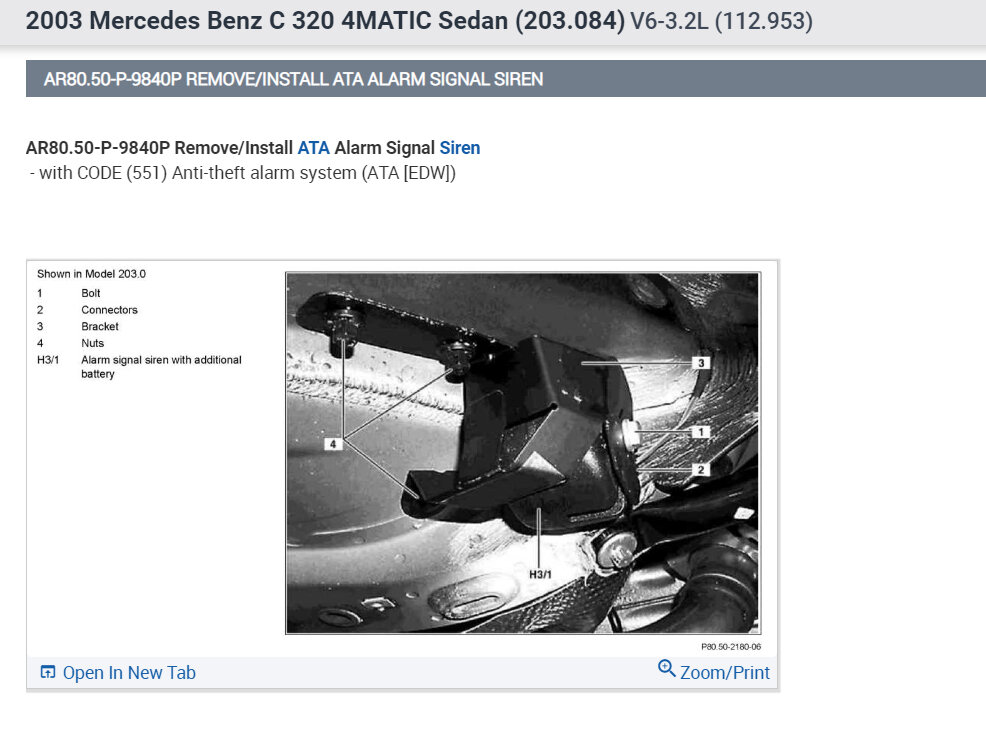

It sounds like you may have a weak battery, I would follow this guide to load test the battery
If the voltage of the battery is low, it will cause the systems to malfunction. If the battery is new or tests good, I have seen the battery in the alarm module leak and cause all kinds of weird problems, check out this video of the job being done in a similar merc:

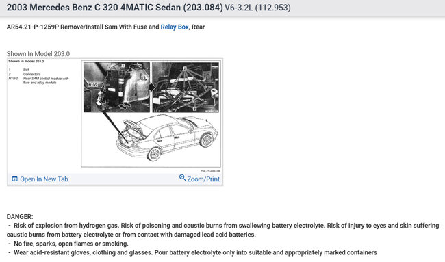

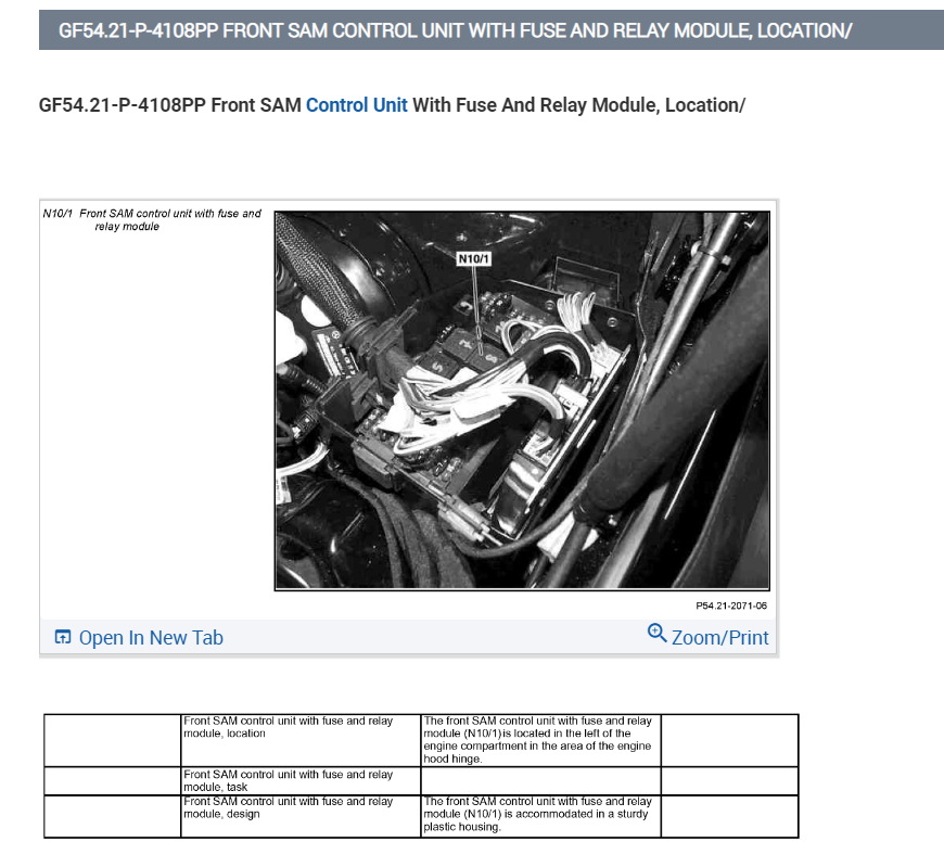

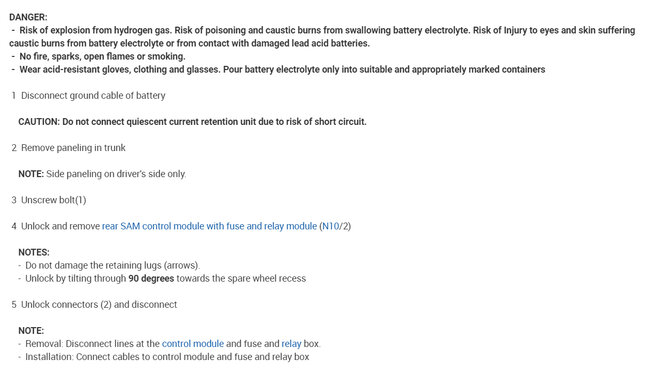

I have also seen the front or rear SAM module go out causing strange problems as well but to be sure we should do a CAN scan which is easy, you can get a CAN scanner (Controller Area Network) from Amazon from about $32.00 here is a video to show you how.

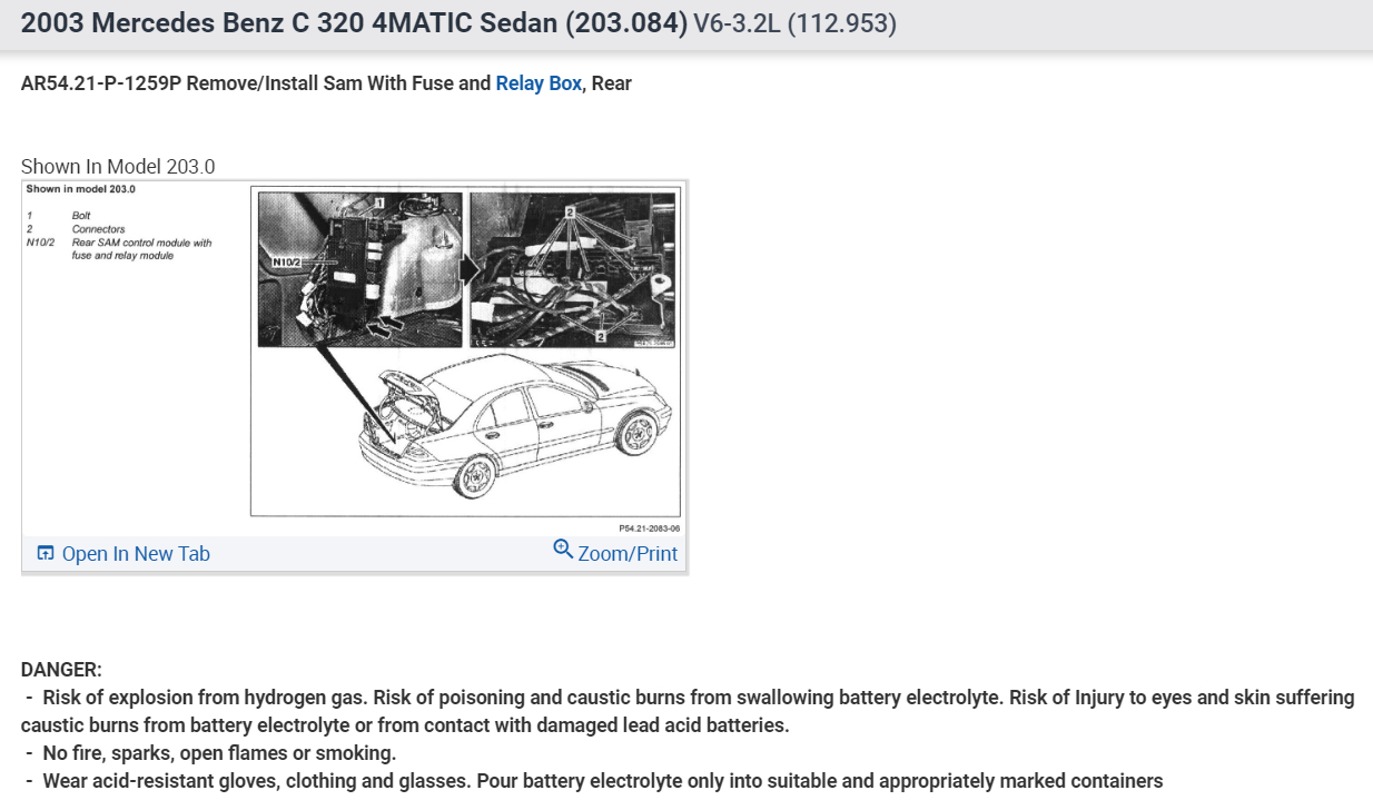

Check out the images (below). Please let us know what you find. We are interested to see what it is.
