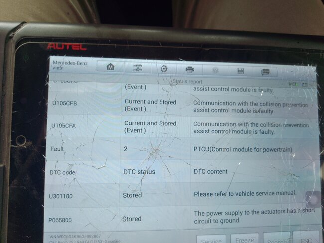

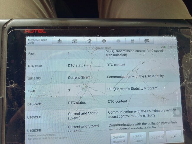

The following are the codes that were present when scanned.
Feb 26, 2025 at 8:26 AM

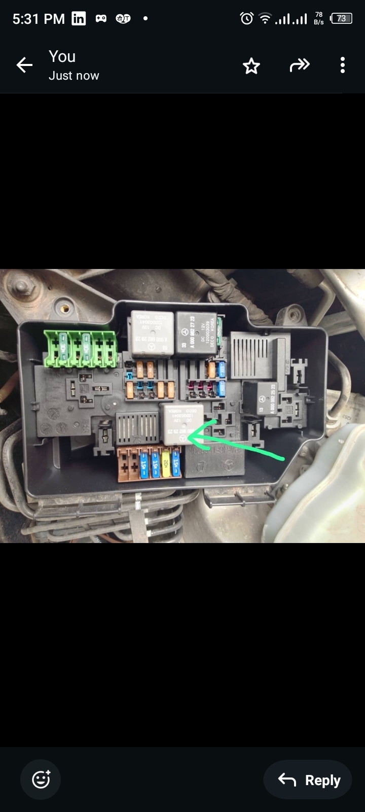

I observed that the relay clicks sometimes even when the Engine is off, and the doors are looked. I don't know what it is controlling. Is it how it supposed to be clicking sometimes?
Feb 26, 2025 at 8:35 AM
With all these codes it seems like a module is not working correctly, I would clear the codes and then turn the system on without starting the engine and then run the codes again. I believe the relay is for the start stop function, does the battery draw stop when you remove the relay?

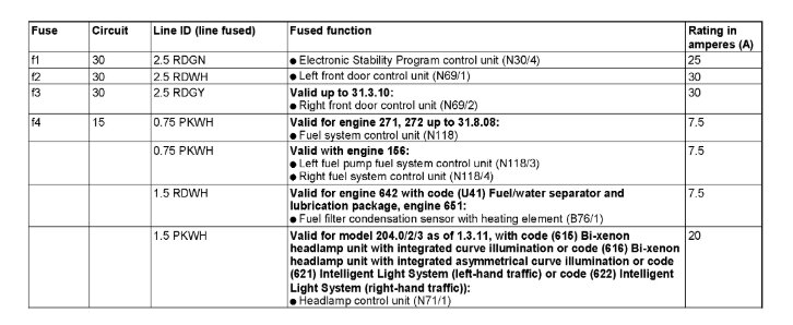

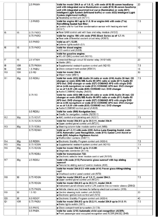

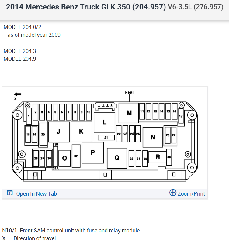

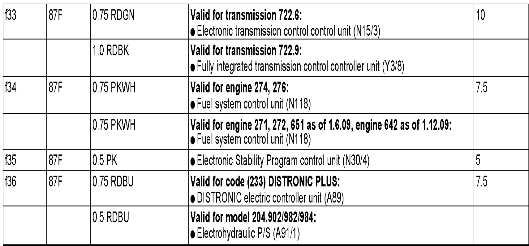

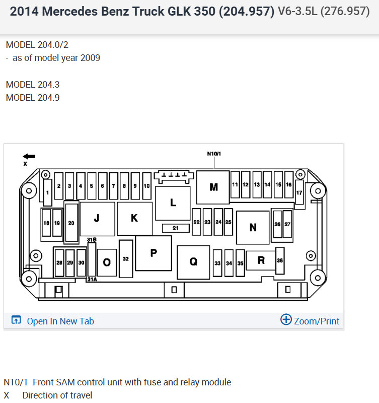

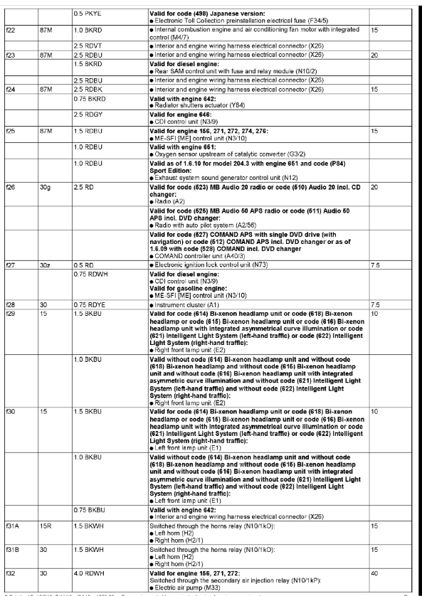

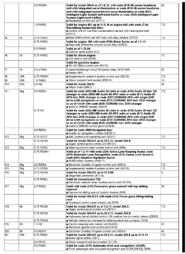

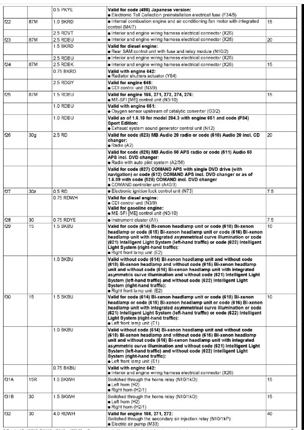

Here is the layout for the fuse panel. Check out the images (below). Please let us know what happens.
Feb 28, 2025 at 8:42 AM
