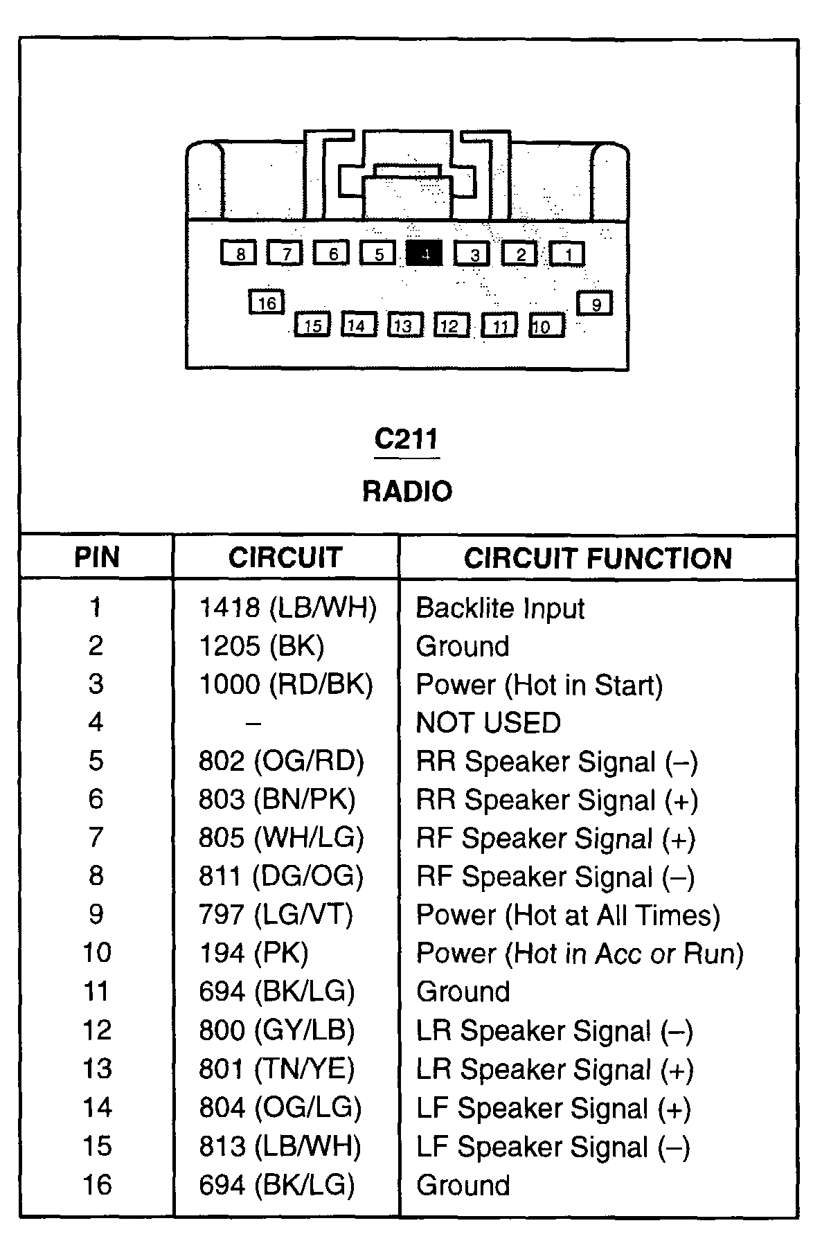

Hello, my name is McRoberts, my Ford van would drain battery. I have checked with an electrician over and again. They seem not to find the fault. And the radio would not hold memory. When car is off and start I will have to set the radio all over again. It is frustrating.
I would appreciate some help. Thanks
