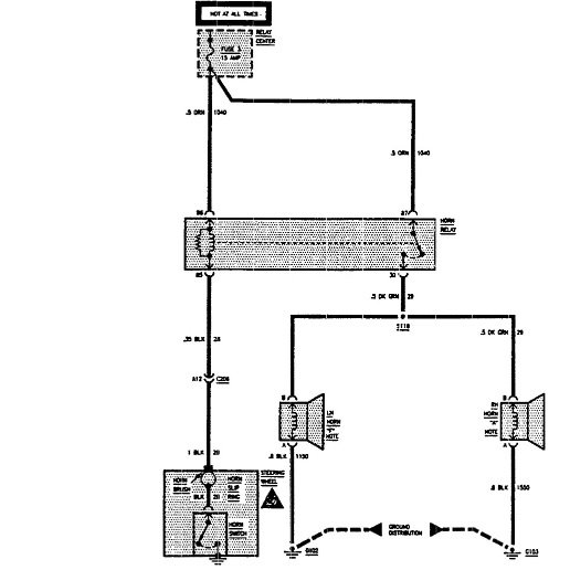

When the car sets for more than three or four days the battery goes completely dead, won't even charge unless I disconnect it and let it set for a day or so. Then I can charge it fully. The cars starts okay as long as I drive it every day. Not sure if this is a clue to the problem but I had to disconnect the horn because it was continually blowing. The relay has been checked so I have been told it is probably the switch in the steering wheel.

Is the horn draining your battery? If you pull that fuse in the diagram, the horn can't drain your battery. Make sure battery has a full charge and connections all good. Check your charging system. You could have too much drain, not related to horn, with everything off. A faulty generator might let the battery drain. Your not leaving lights on, anywhere, interior--under the hood--in the trunk, best time to check for lights left on is in the dark. Also, with too much drain, you can pull/replace fuses, one at a time. When you pull the fuse on the problem circuit, the drain goes away or returns to normal. Most digital multi-meters have a 10 amp setting, that is more than enough to check battery drain. You place the meter leads in series with a battery cable, the reading shouldn't even be a tenth of an amp, in my opinion. The repair guides link, at top of page, has a lot of good information about your battery and testing, check it out.
