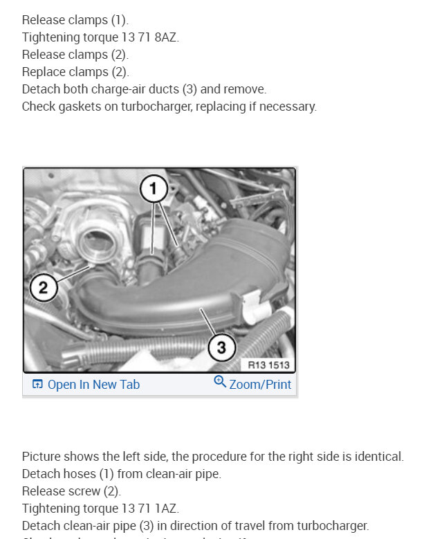

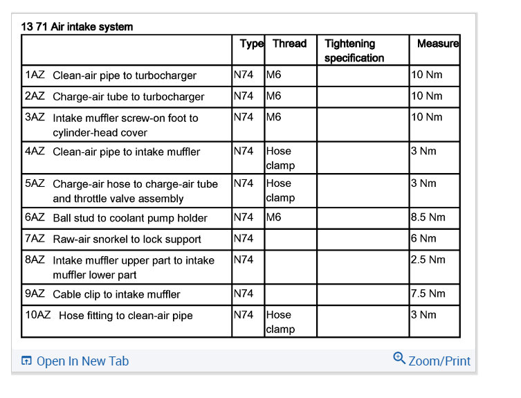

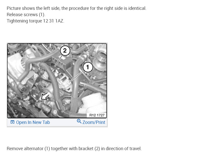

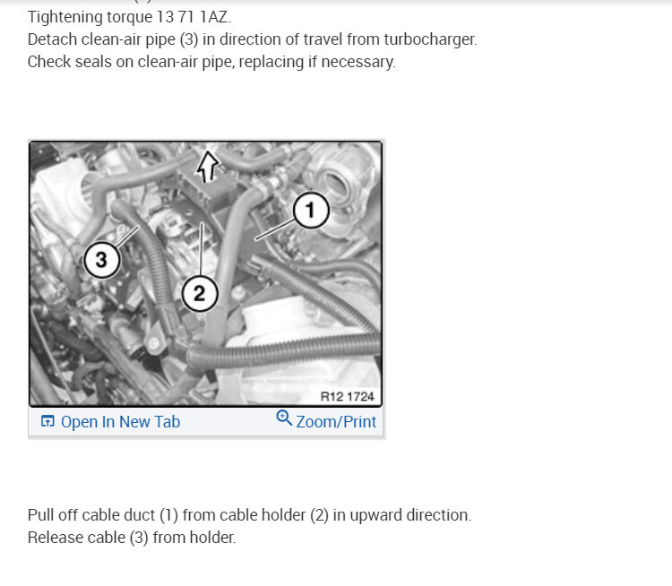

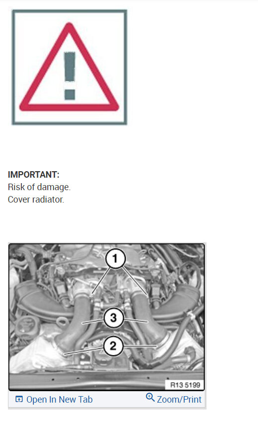

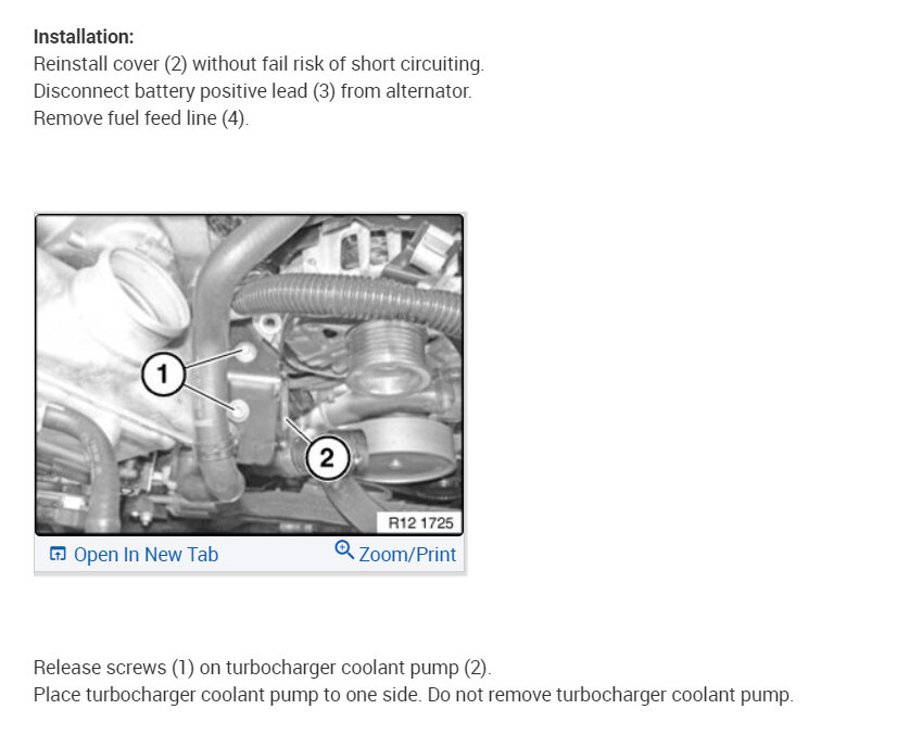

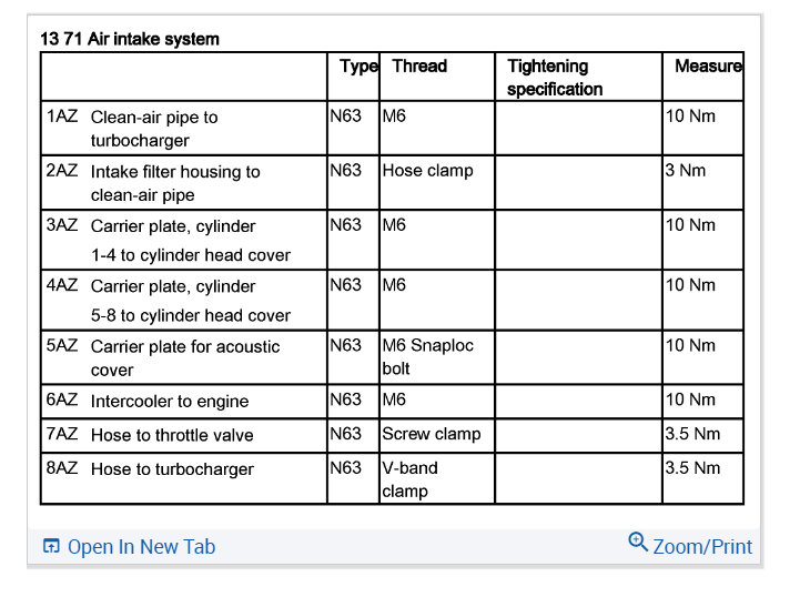

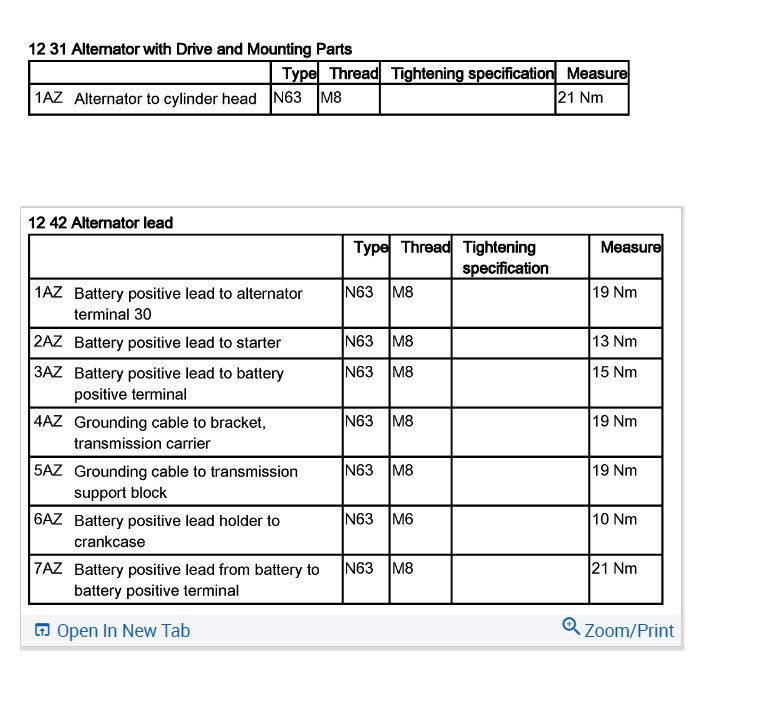

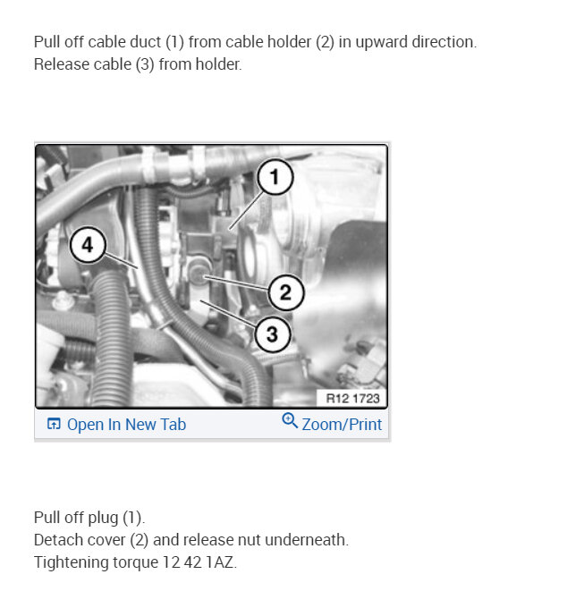

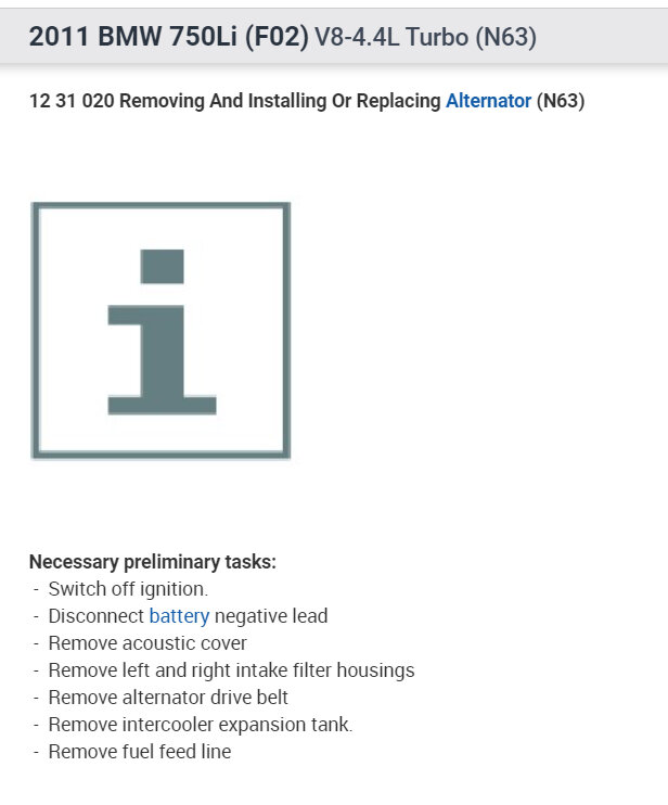

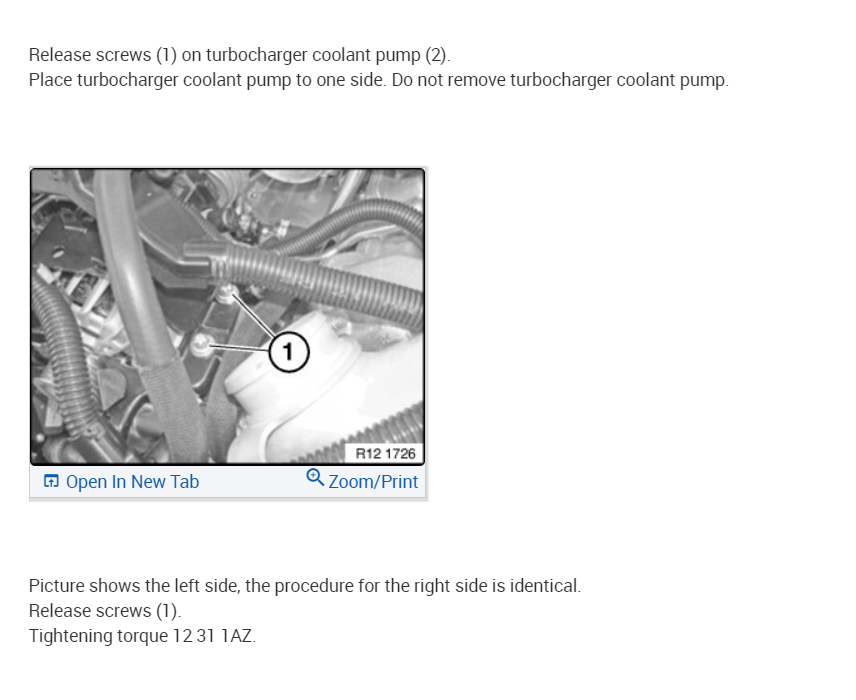

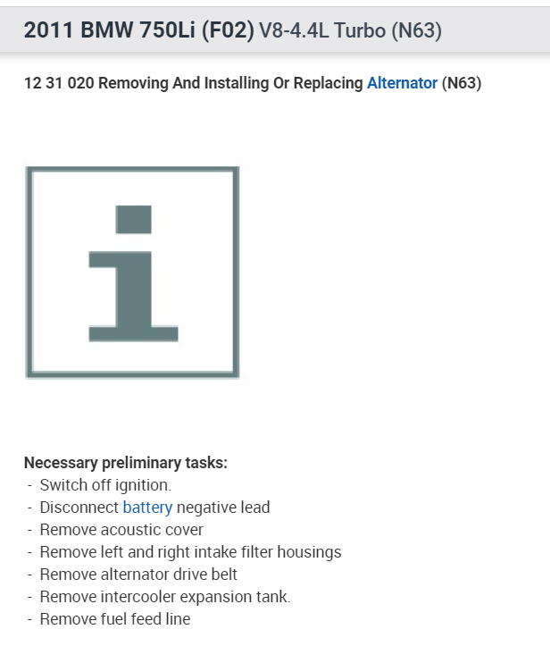

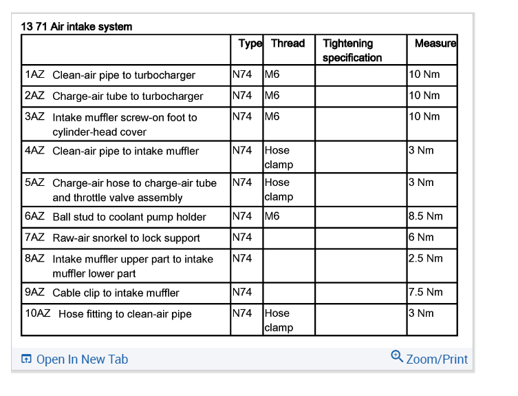

The battery drains while you drive if the alternator is no good is normal. Is the charge warning light on while driving? If so, the mechanic is correct but if you want to confirm the failure this guide will show you how to check the alternator. Also, I have included how to change the alternator out in the images below.
I don't know why it would be $3,000.00 to fix here is the part cost and labor time.
Alternator, R&R 4.5 @ shop rate.
https://amzn.to/3C2gz7x
For the part between $200 and $600.00.
Check out the images (below). Let us know what happens and please upload pictures or videos of the problem.
