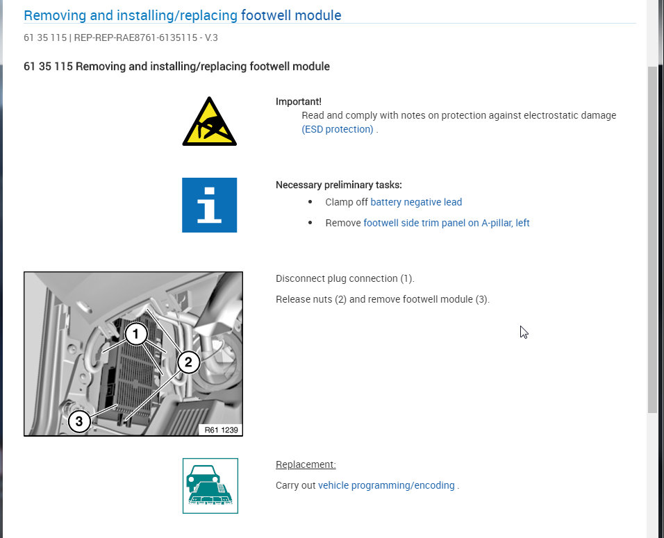

The footwell module has been replaced and program.

Yes, replacing this module did correct the problem. Thank each of you for your help.
