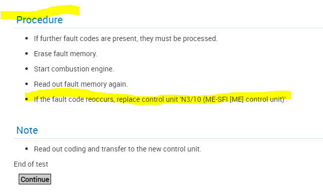

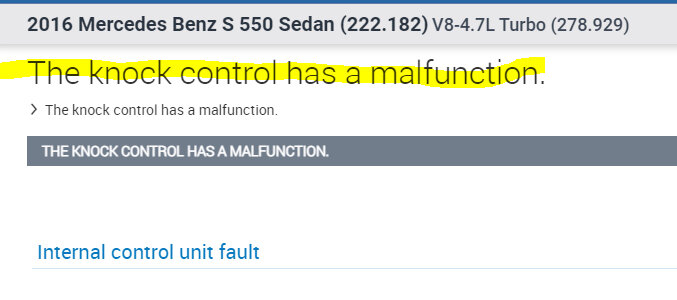

Both batteries are newer than 1 year. When the car is turned off, the speaker still makes popping and banging noises. This drains the battery overnight. After a jump start the car runs great. There is a p0641 code.
