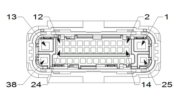

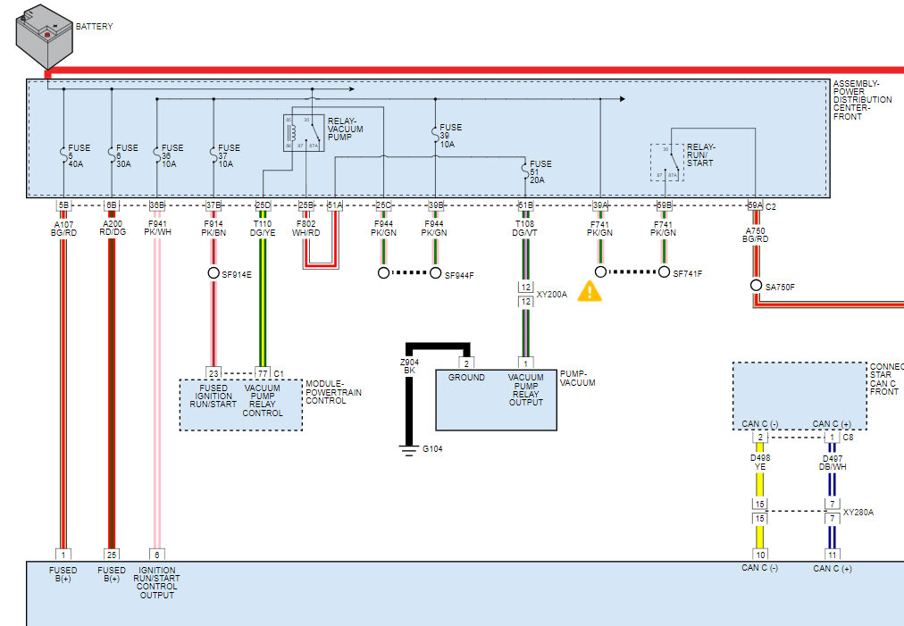

First, I would suggest checking the voltage at pins 1, 6, 25 at the ABS control module.
Pins 1+25 are constant 12V supply and pin 6 is ignition 12V supply from run/start relay.
It should show battery voltage.
This can be done using a voltmeter.
If in order next check the ground at pin 13, black wire.
Use a test light to load test the connection, the bulb should glow bright.
