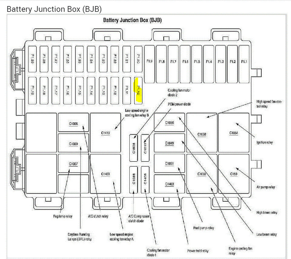

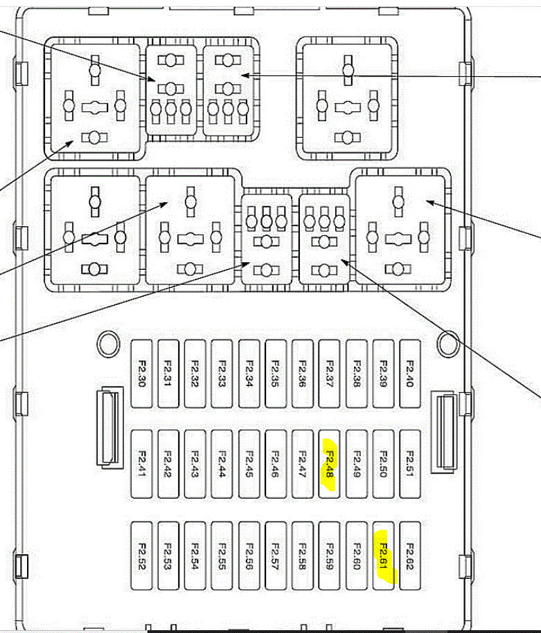

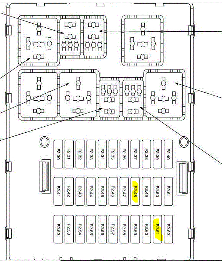

First, there are three fuses I need you to check. One is in the under-hood battery fuse box and two are in the central junction box. Fuse f2.48 is for the data link connector which may be causing issues with the scanner. The other two are for the alternator and the cluster. If you look at pics 2 and 3 below, they show the fuse locations in the boxes.
When you check these fuses, make sure the fuse is good and also make sure they have power to and from them. Here is a link you may find helpful:

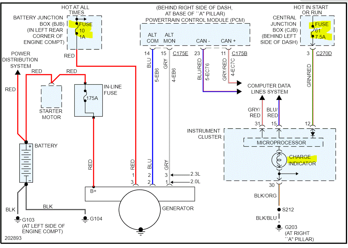

Pic 1 shows the wiring schematic for the charging system. I highlighted the two related fuses.
