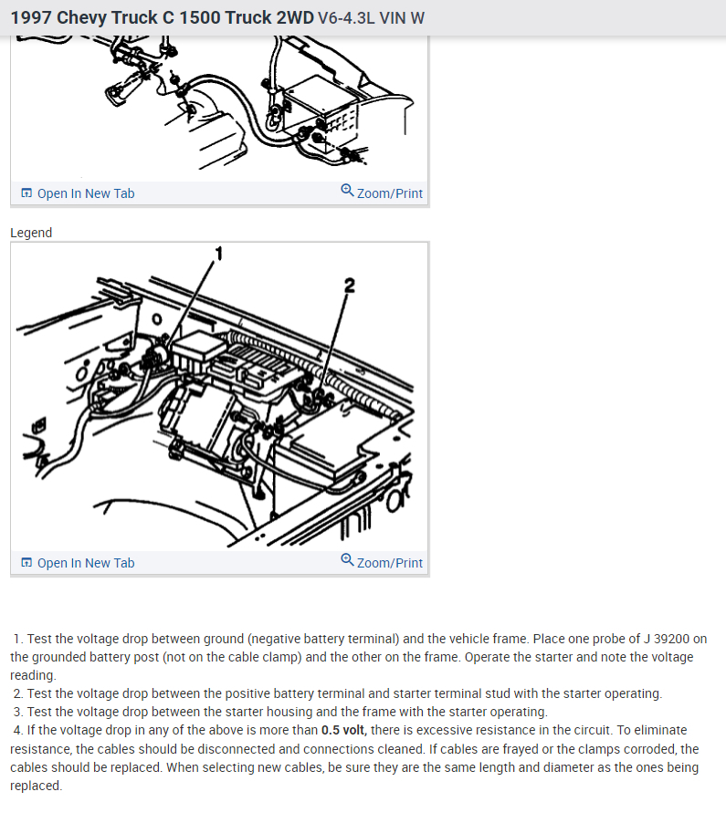

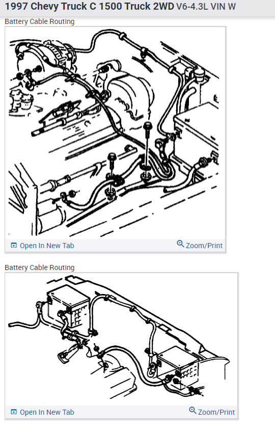

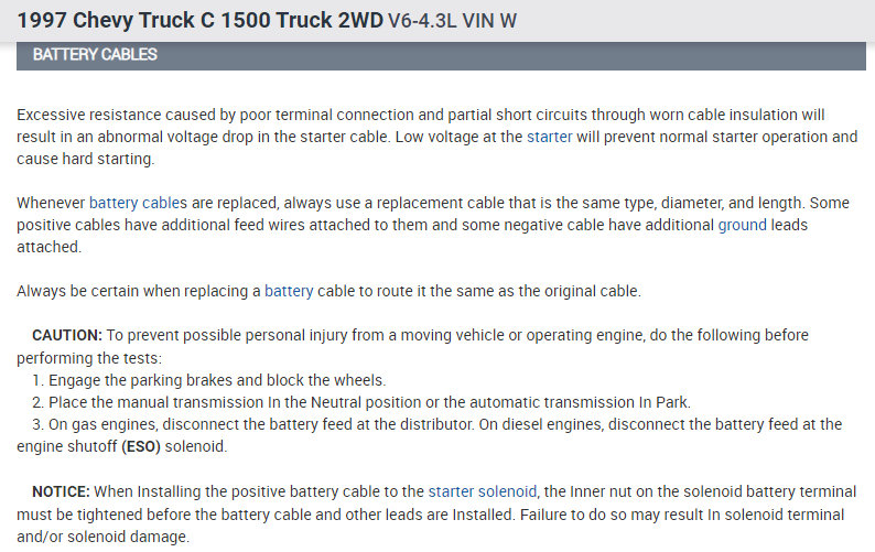

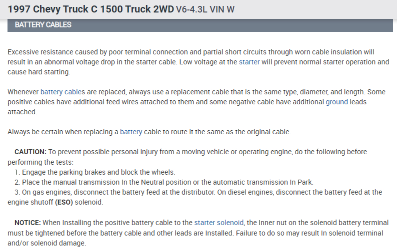

I have attached the cable diagrams for your reference.
Thank you.
