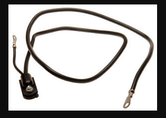

I need step by step directions to replace the battery cables. The negative cable I bought only has one cable with a little one that's capped off, but the one I my car seems to somehow connect to the positive? I Im confused!

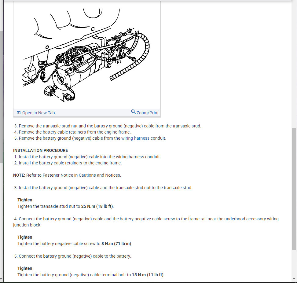

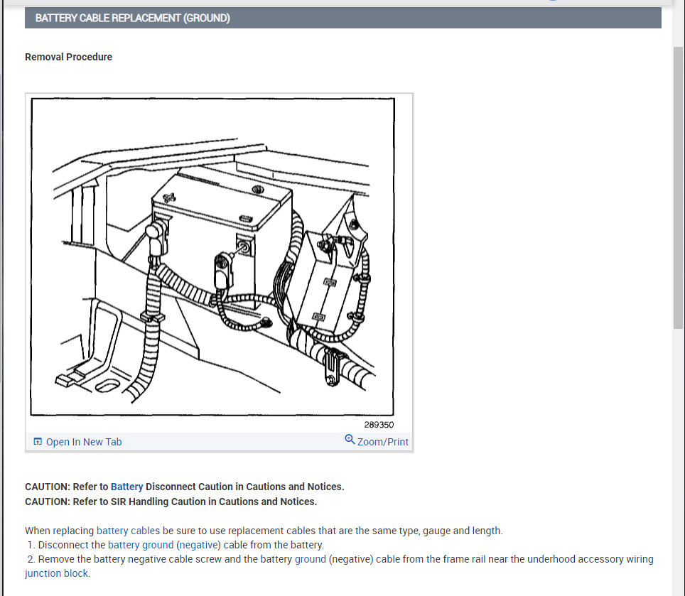

Sounds like this smaller wire that is capped is a redundant ground which is pretty common.
I am attaching the process from the manual on the negative cable plus a picture of what the cable should look like.

However, if the car runs then clearly the cable is working but we need to confirm that the replacement is the same as the one that is removed. If they are the same then clearly each connection needs to go on in the same place.
The fact that you are seeing something different on the replacement cable makes me think it is not the right part.
