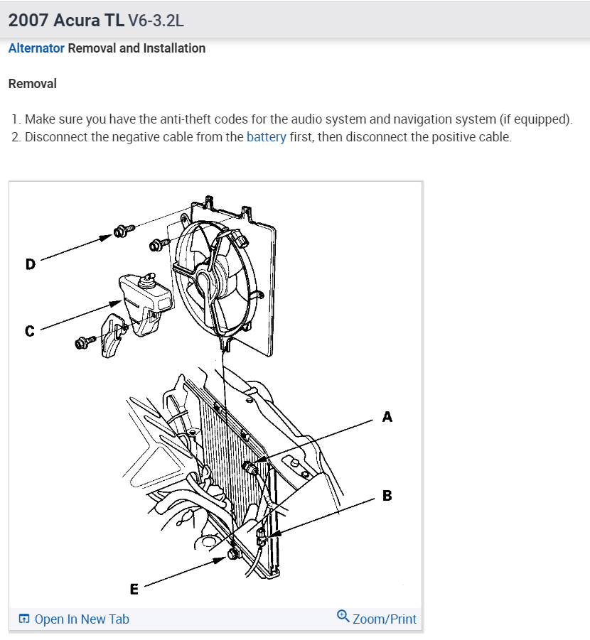

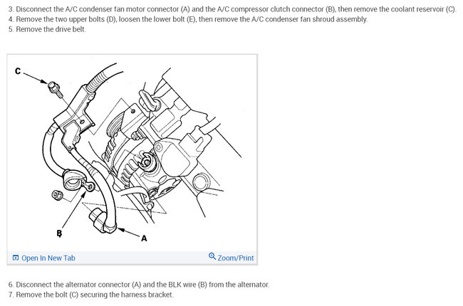

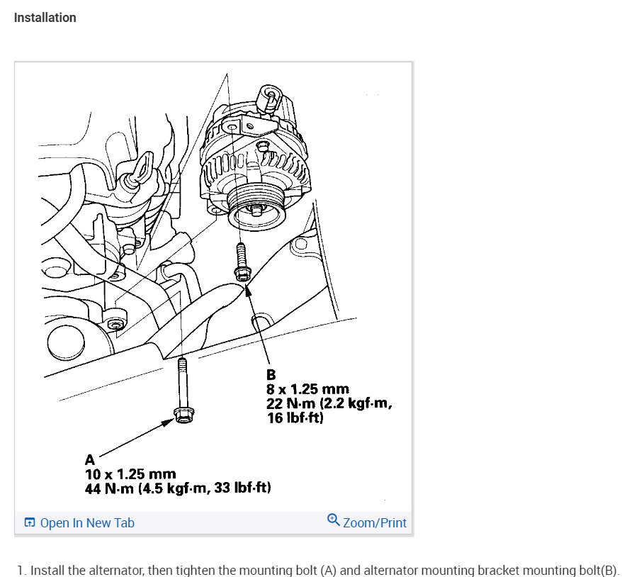

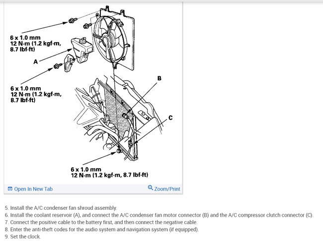

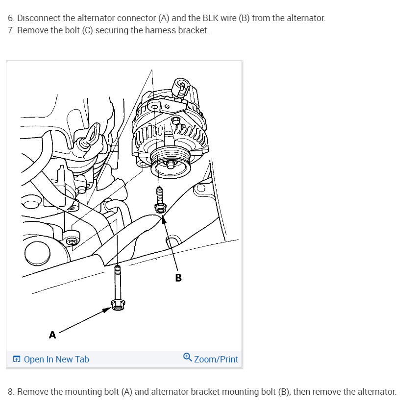

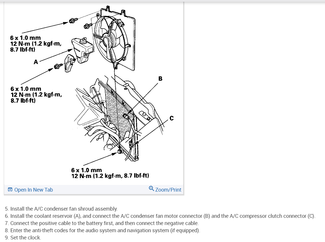

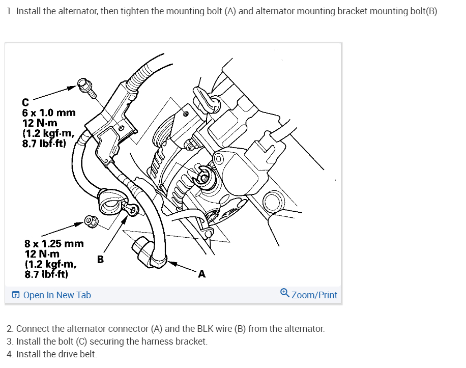

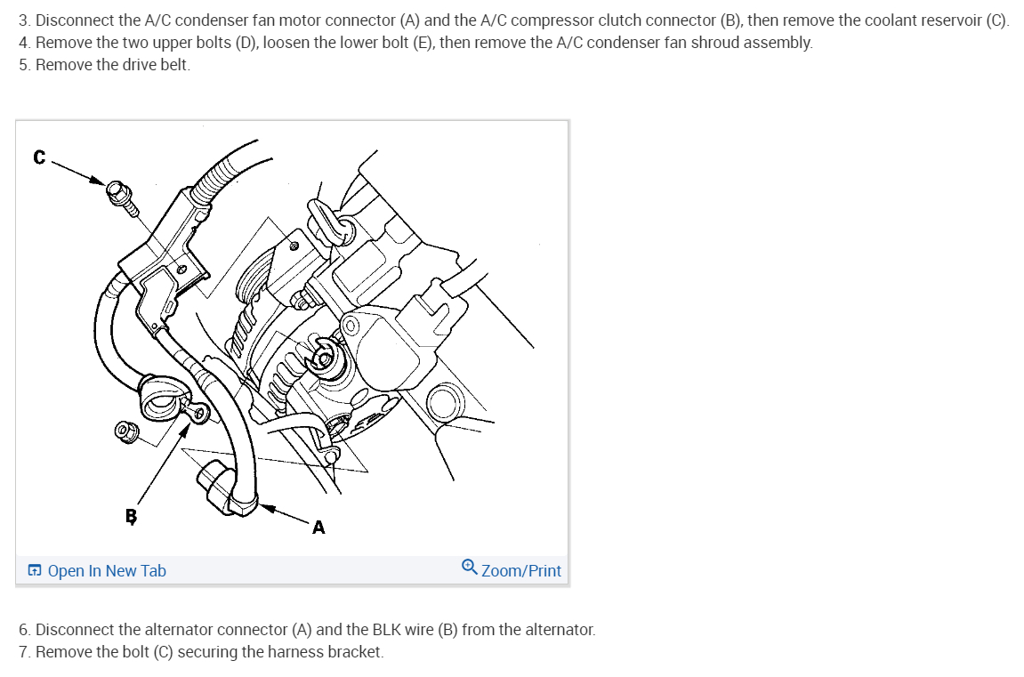

When the battery light comes on it means the alternator has stopped charging so that will be job #1, but if the battery is more than 3 years old, I would replace that as well. Here is how to change the alternator and battery out to fix the problem:
https://www.2carpros.com/articles/how-to-replace-a-car-battery
Check out the images (below). Please let us know if you need anything else to get the problem fixed.
