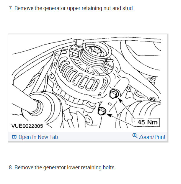

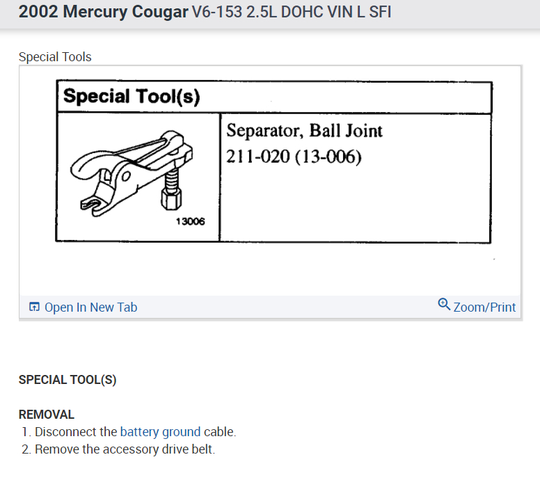

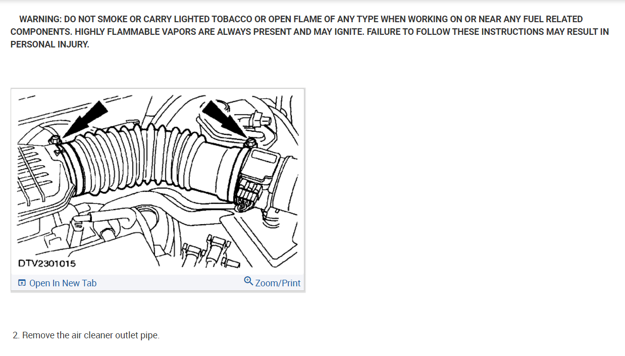

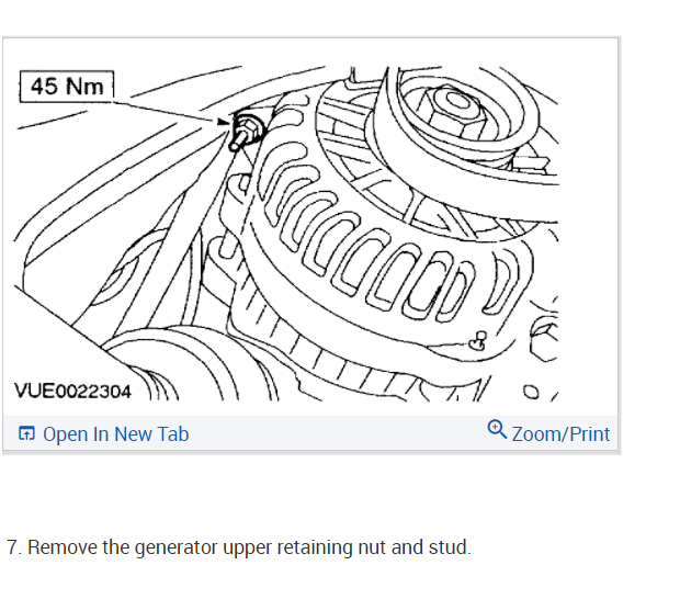

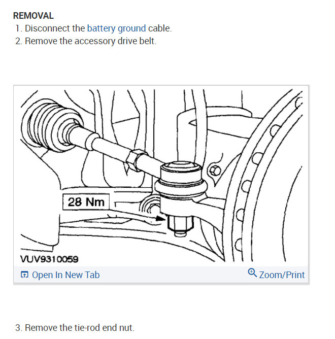

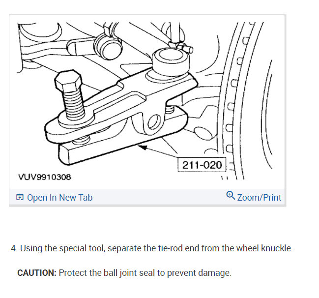

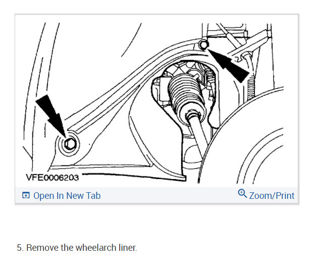

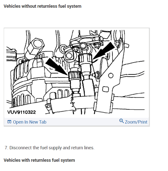

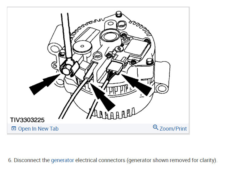

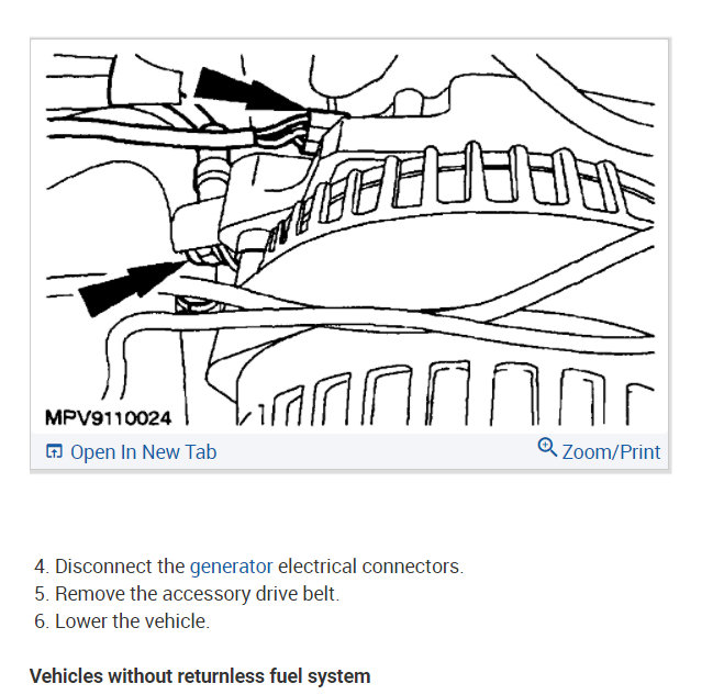

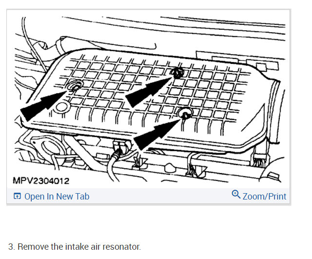

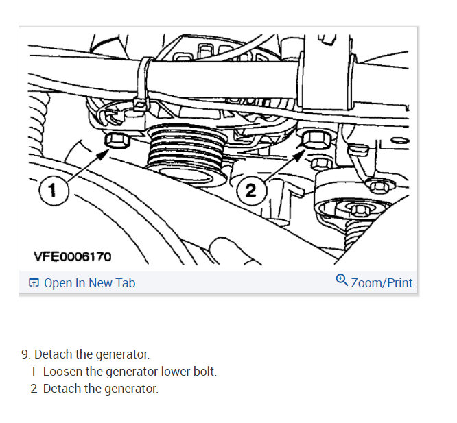

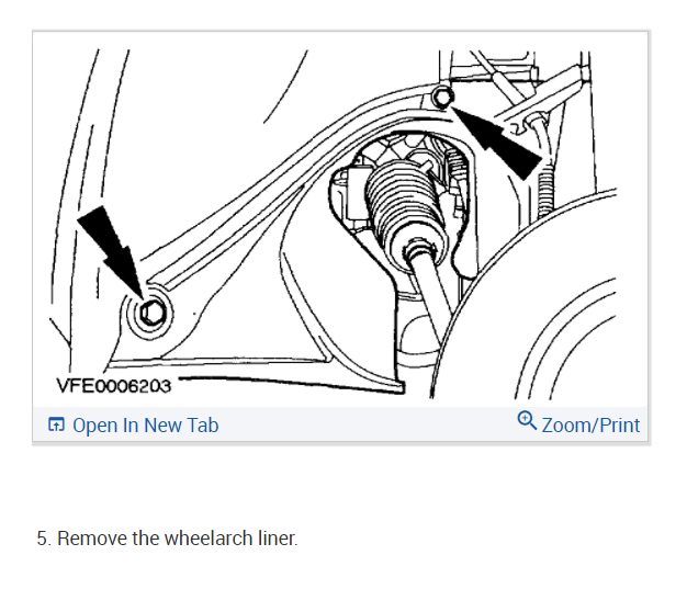

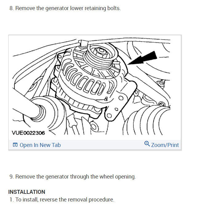

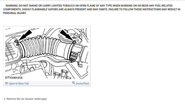

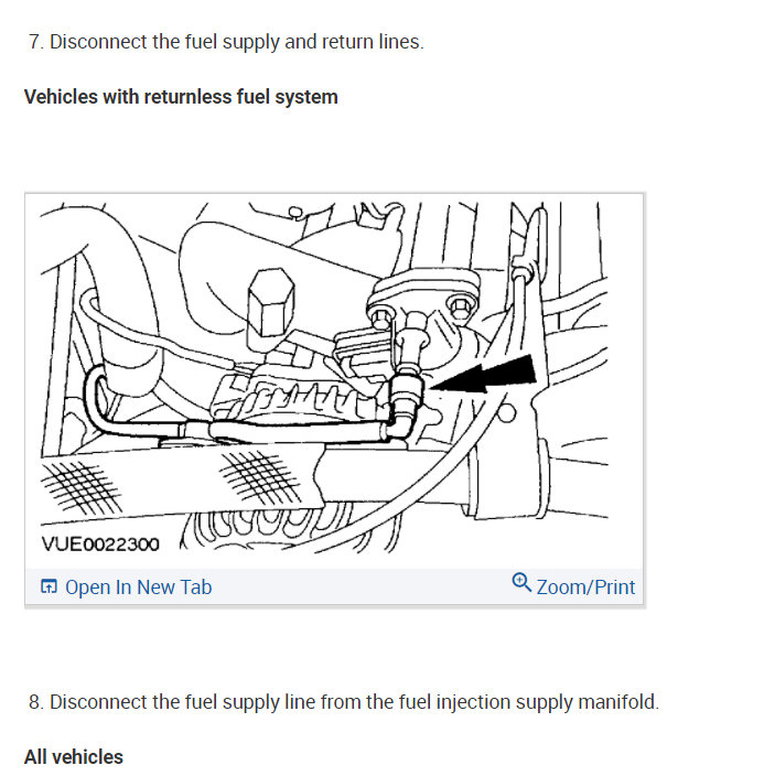

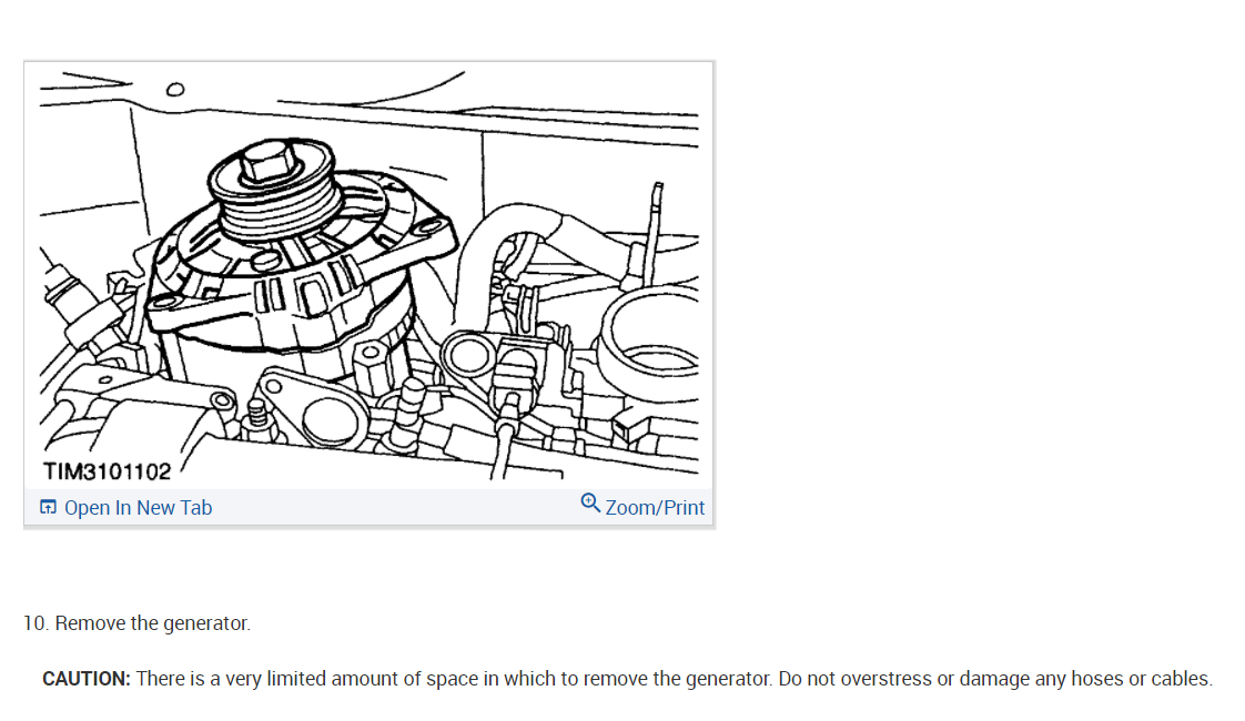

Here is a guide to help you step by step with instructions in the diagrams below to show you how on your car. I have included both 4 and 6 cylinder engine in the diagrams below.
https://www.2carpros.com/articles/how-to-replace-an-alternator
Check out the diagrams (Below). Please let us know what happens.
