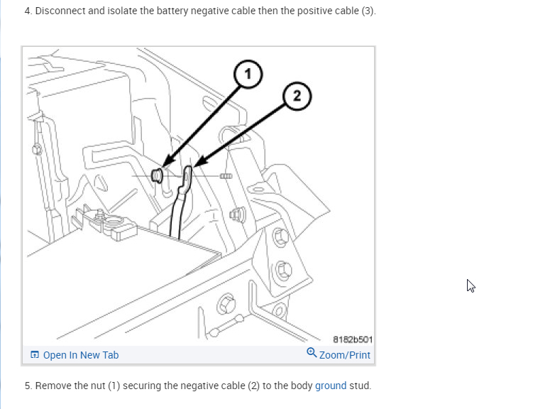

Where does the battery ground wire connect?

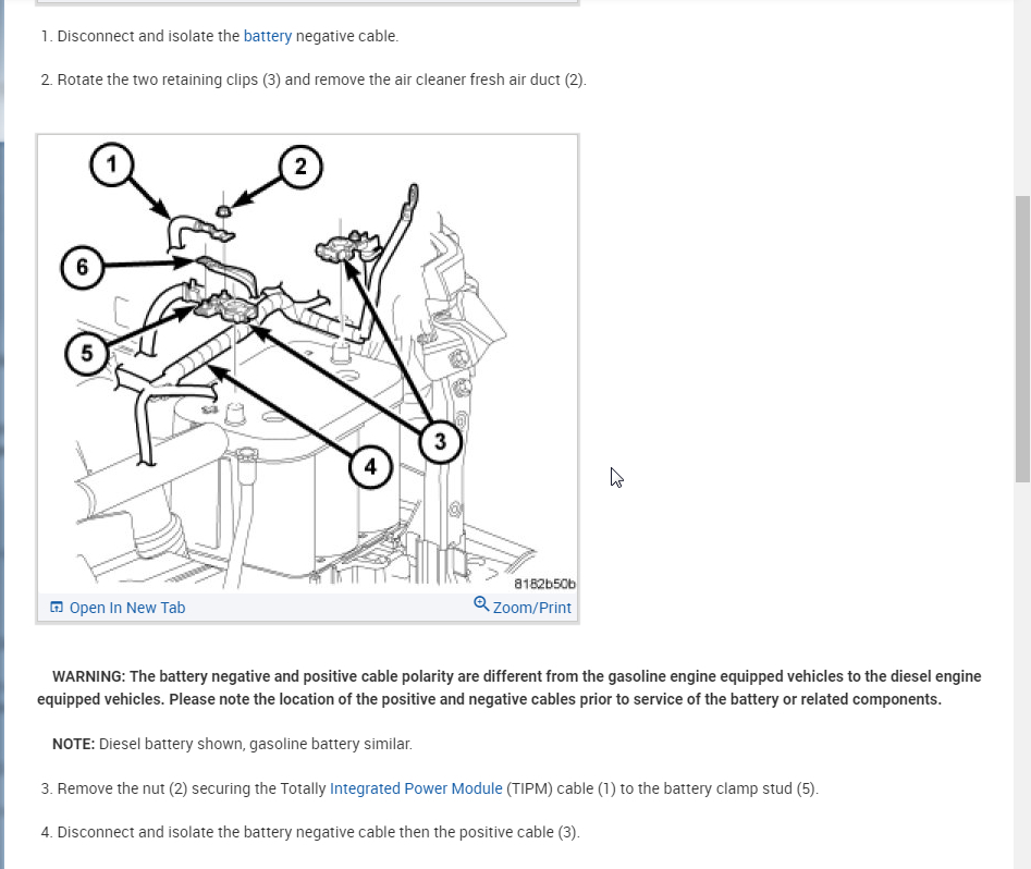

I attached the process to remove the cable. There is a ground stud under the battery on the front support. Take a look at the pictures and instructions and let us know if you have more questions. Thanks
