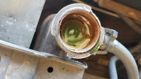

This truck had a complaint that the heat stopped getting warm. It barely gets lukewarm now. The water pump went out on it so we replaced the pump and the thermostat, and also the heater core. I let the car run with the radiator cap off until it just overflows and makes a mess, both hoses on the core are hot, but still no heat

There are no bubbles in the radiator, also the coolant doesn't move dramatically with each rotation of the engine, I was running it with the cap off and much like the tide at the beach, the coolant made its way up to the top of the radiator, overflowed, then went back down, and again made its way back up to overflow again. This was what I thought an "old school" way for the radiator to push air out of the system.

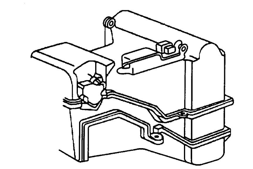

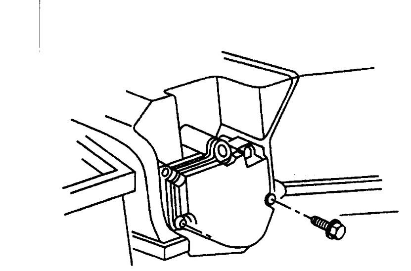

The procedure below with some pictures.
Collision Roy
Phone
5
Change Vehicle Bookmarks Library Request Conversion Calculator Technician's Reference - Collision
Search vehicle information
Community 3 Create Quote
1995 Chevy Truck C 1500 Truck 2WD V8-305 5.0L VIN H TBI
Temperature Door Actuator
Vehicle Heating and Air Conditioning Air Door Actuator / Motor Service and Repair Procedures Temperature Door Actuator
TEMPERATURE DOOR ACTUATOR
Temperature Actuator Location
Temperature Actuator Replacment
Remove or Disconnect
1. Negative battery cable.
2. Roll instrument panel forward.
3. Electrical connector.
4. Screws.
5. Actuator.
Adjust
A. Electrical connector to the actuator.
B. Turn the ignition key to the run position and let the actuator position itself.
C. Turn off the ignition key.
D. Remove the actuator from the electrical connector.
Install or Connect
1. Actuator.
2. Screws.
3. Electrical connectors.
4. Instrument panel compartment.
5. Negative battery cable.
^Check circuit operation.
Sep 11, 2019 at 3:20 AM

That one in the picture looks like the floor mode actuator.
Sep 11, 2019 at 3:59 AM
That is the temperature actuator listed in Alldata.
Sep 11, 2019 at 4:07 AM
CANNON1349
  • 861 POSTS
Is that attached to the heater core box?
Sep 11, 2019 at 4:15 AM
Correct. It is attached to the blend door for heat and cool air.
Sep 11, 2019 at 4:25 AM

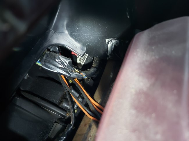

See the red rag? That's it. Removing the door for the heater core will do nothing but reveal the heater core. I don't know what it means to "roll back" the instrument cluster. Looks like the entire dash needs to move. I wish the instructions were more clear
Sep 14, 2019 at 3:37 PM
What is that picture?
It says to release it and roll it forward.
You remove the actuator, not the case. Then move the door by hand from cold to hot.
Sep 16, 2019 at 3:53 AM
CANNON1349
  • 861 POSTS
That's shining a light behind the ash tray. What I did was remove the glove box, the panel around the glove box, and the panel around the ashtray and removed the ashtray. I could move the glove panel out enough to get an elbow extension to reach it and replace it. Heat works now.

Returning to this thread because I still have some coolant loss. But no obvious leaks.
Roy mentioned a possible head gasket issue. I attached here a bubbling video to describe what I wrote above. It will slowly rise until it just comes out of the radiator.
Apr 9, 2020 at 6:16 AM
Yep, I see.
I would have the leak down test done to check the head gasket.
Apr 9, 2020 at 6:18 AM
