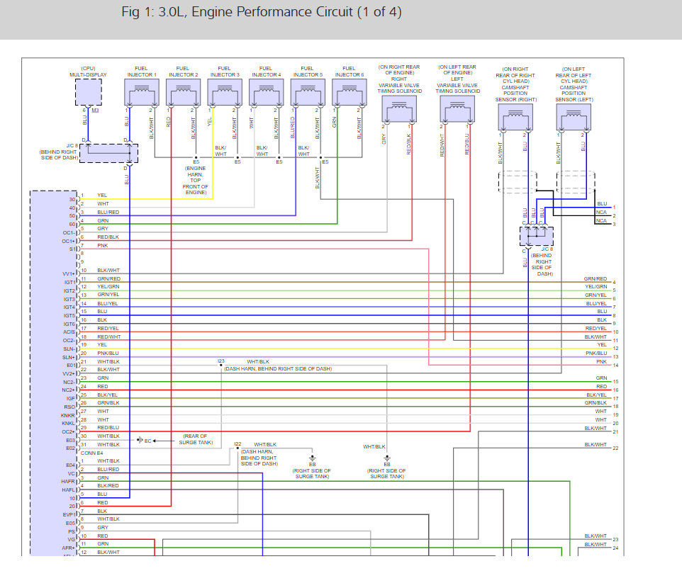

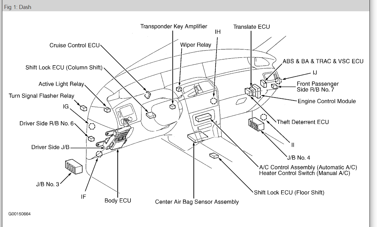

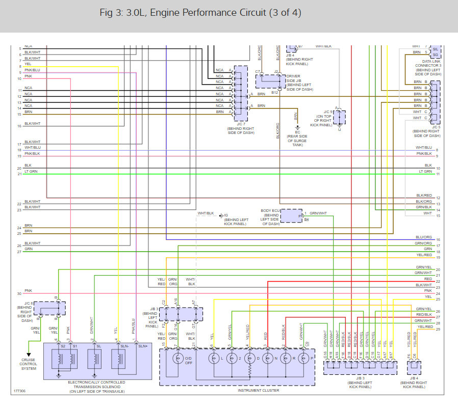

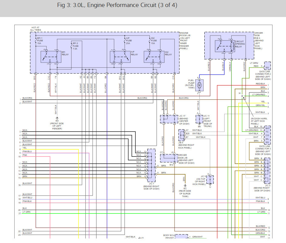

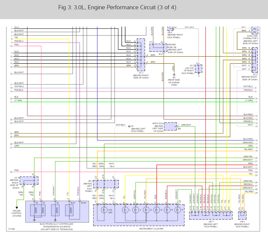

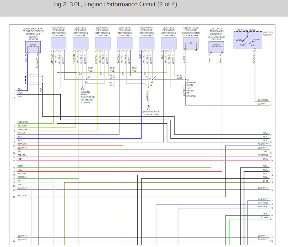

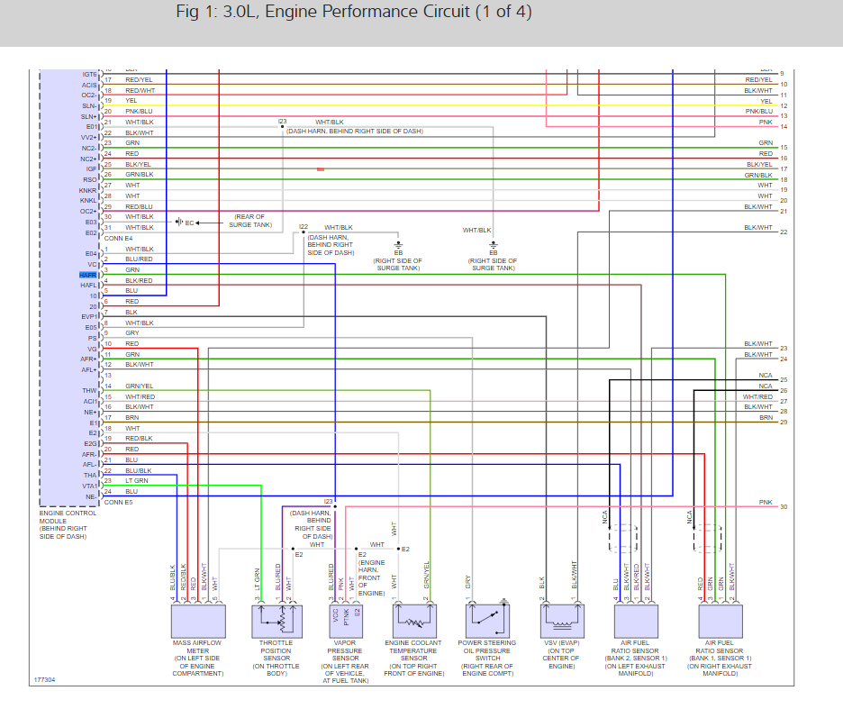

It sounds like you have a wiring issue or the PCM has gone out be to be sure we will need to do some testing here is the engine wiring diagrams and guide to go over them with the location of the PCM which I would check for water damage.
Check out the diagrams (Below). Please let us know what you find. We are interested to see what it is.

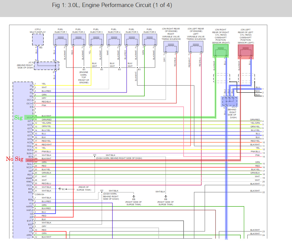

I appreciate the reply and thank you for the Diagram/Schematics as it is not easy to find them online... I will most certainly let you know what I can find … I suspect the ECU if that is what you meant by PCM... Upon further testing yesterday(Sunday) … it seems that both Cam/VVT sensors along with Crank Sensor are directly connected to the ECU without any breaks prior to ECU... there is a junction somewhere for the ground connections but grounds look solid based on various continuity checks...

Please let me know, yes the PCM and the ECU, check for water damage. We are interested to see what it is.

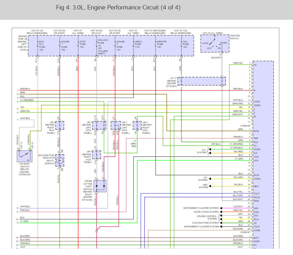

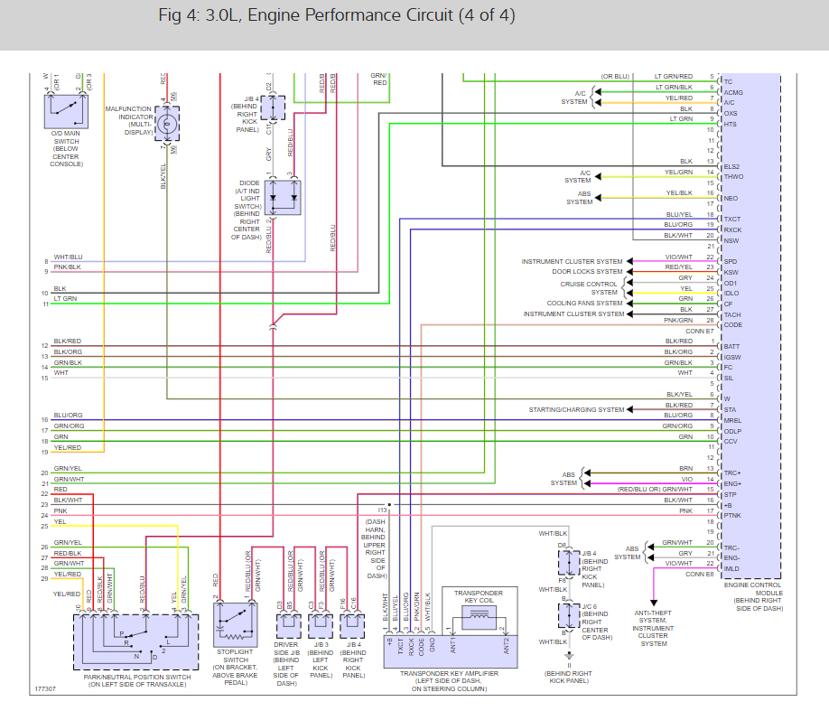

Apologies for the delay.
I have performed many continuity checks between both cam sensors and the crank shaft sensor. The diagram attached shows where there is no signal. There seems to be no shorts or breaks with all three sensors and no visible water damage of any kind..

As stated, i have performed many continuity checks with the determination that there is no signal at e4 pin 22 of the ECU since there is a 24,000 resistance value from pin 22 of connector e4 and pin 25 of connector e5, it has been determined that the connection is solid through to the ECU board itself(internally, there is a 24,000 resistor that is across the two connections... I have traced the circuit for both sensors to an IC that has no distinguishable number).
There is signal at the other two sensors (cam and crank sensor)… the ne- at pin 25 is labeled as e2 ground in the service manual-not case ground.. There is a 100ohms between e2 and case/body ground so there is some form of power inversion within the ecu to create AC based frequency signals...
