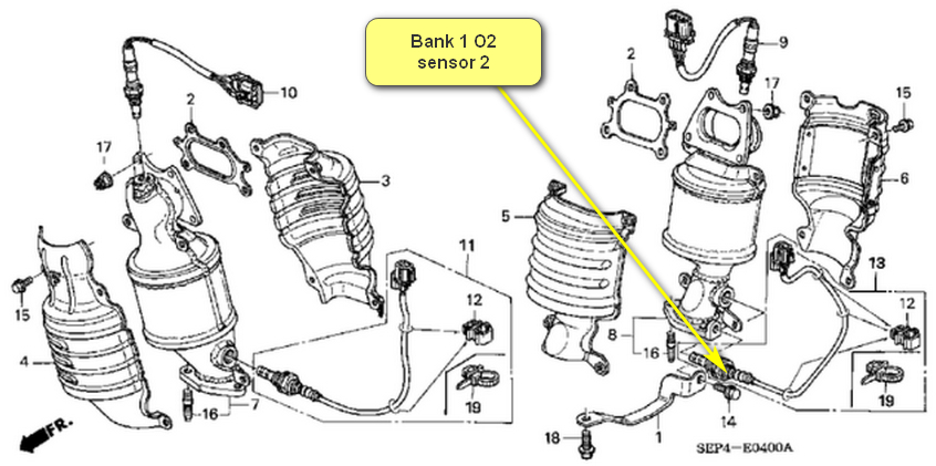

Where is the bank 1 sensor 2 located?
Is the bank 1 sensor 2 the "downstream" sensor?

Bank 1 on your vehicle is the rear bank facing the firewall.
O2 sensor 2 is the downstream sensor from the catalytic converter.
To replace the sensor, you should use an O2 sensor socket which has a special cut out for the wiring. See picture below.

Location of the O2 sensor 2 is in the 1st picture below
