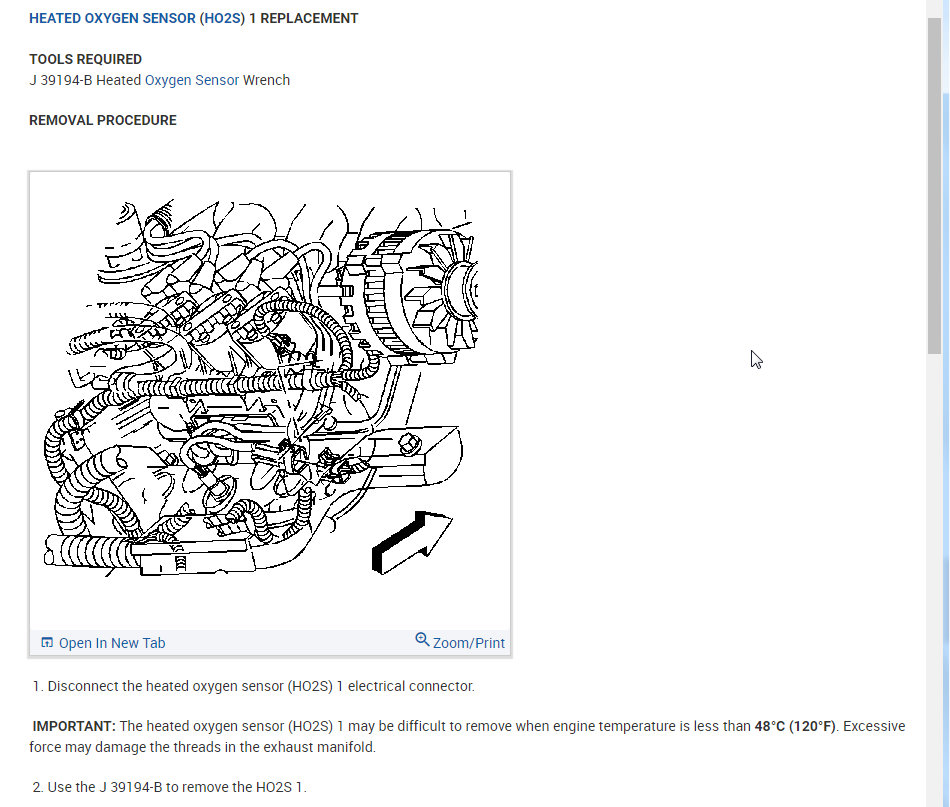

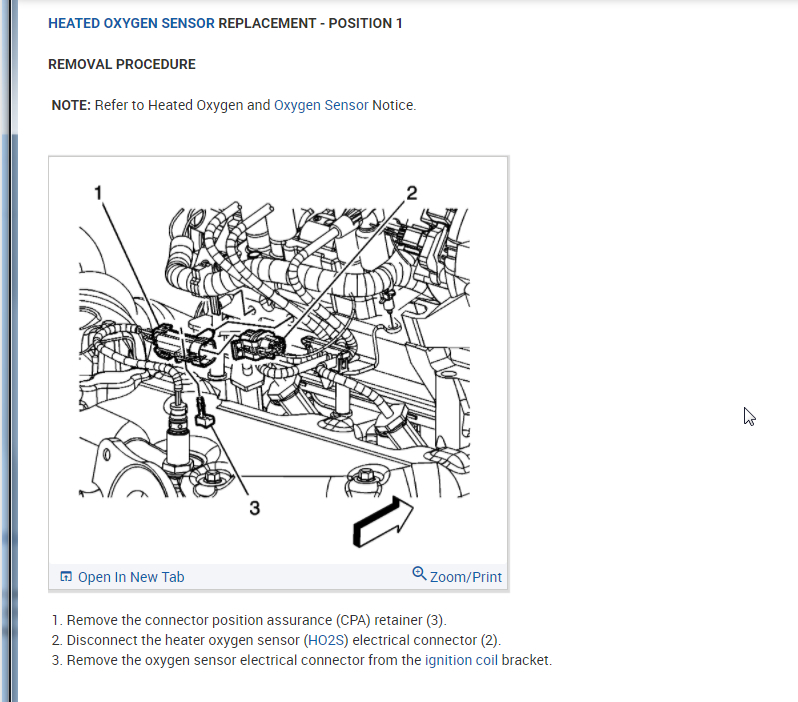

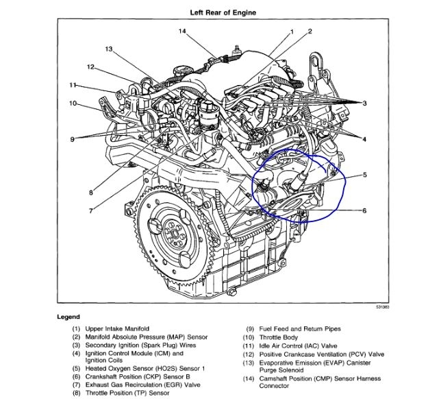

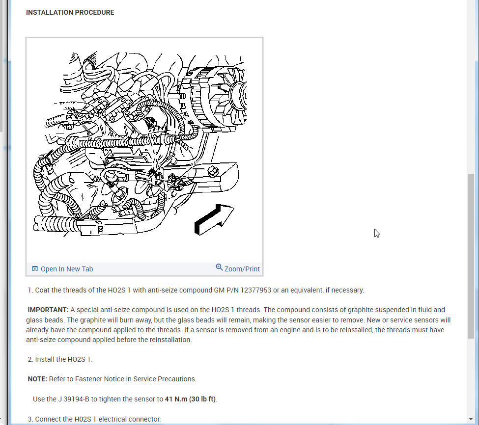

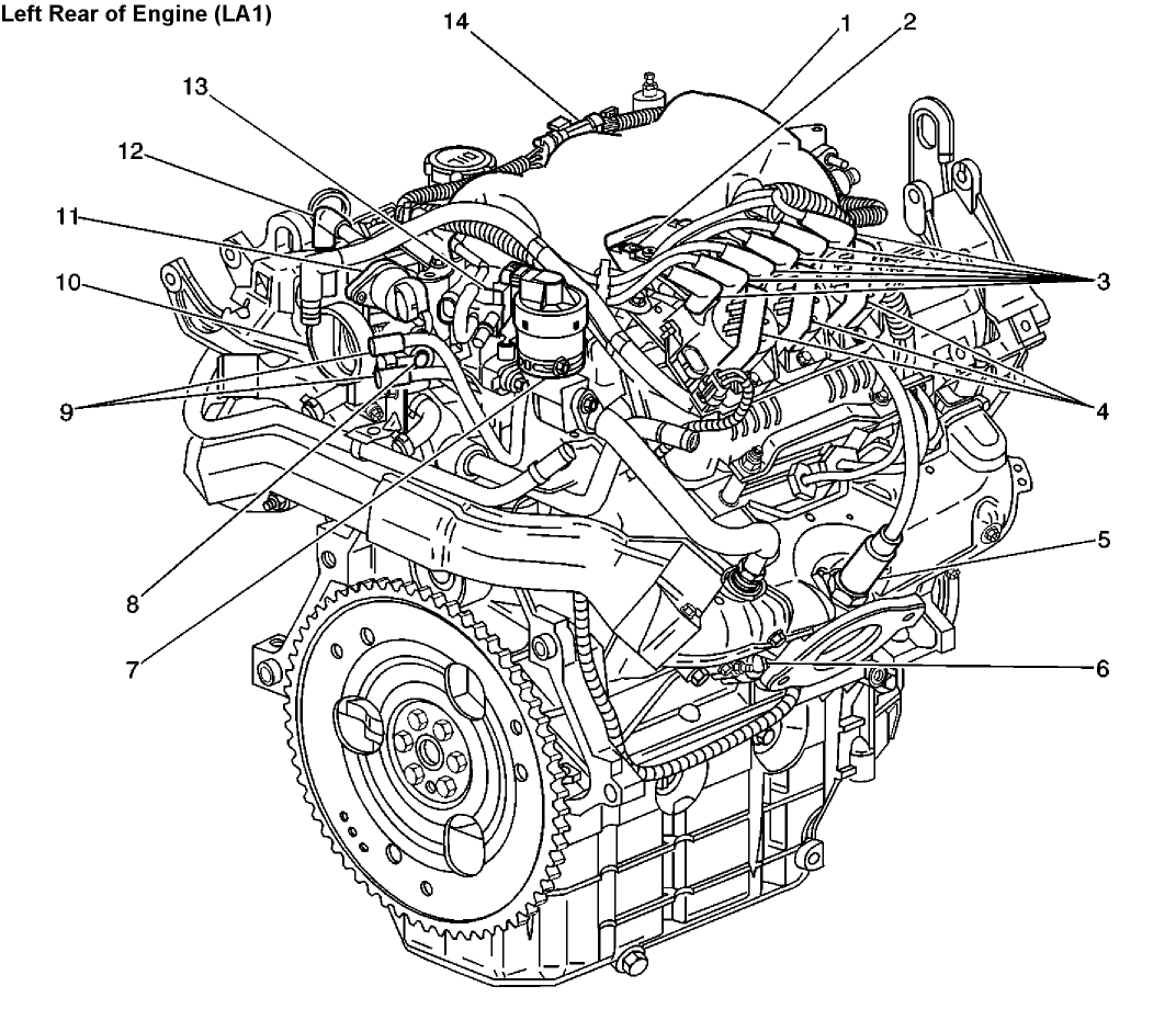

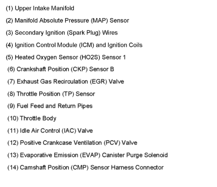

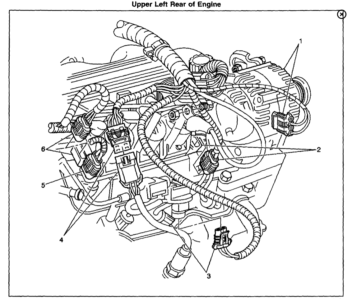

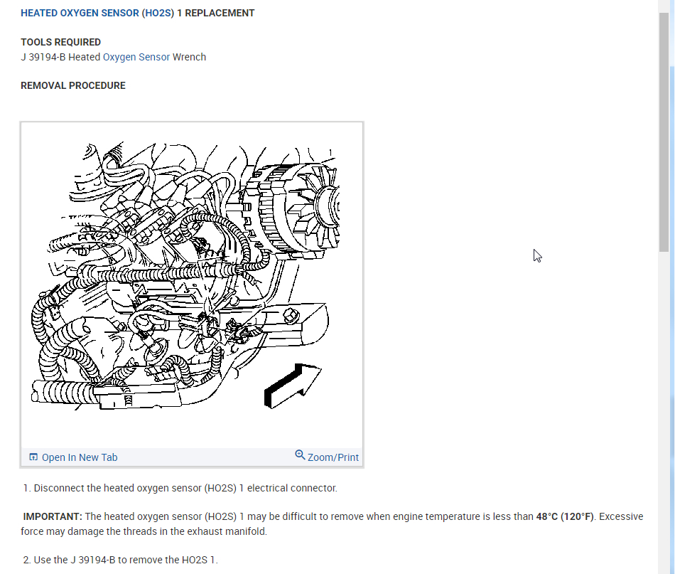

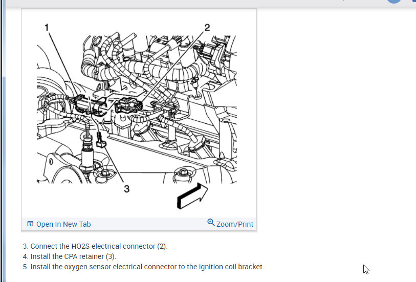

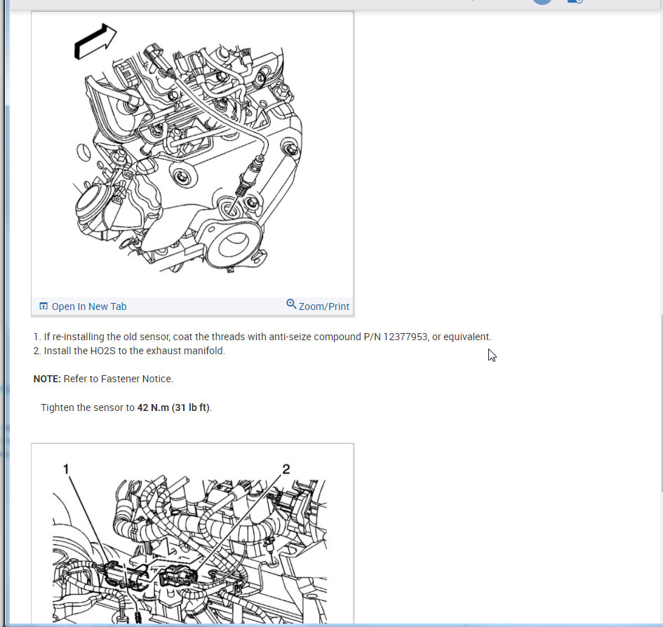

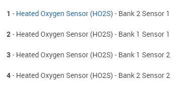

Heated Oxygen Sensor (HO2S) Sensor 1 (3.4L VIN E)In exhaust manifold, rear of engine compartment. See Fig. 36.

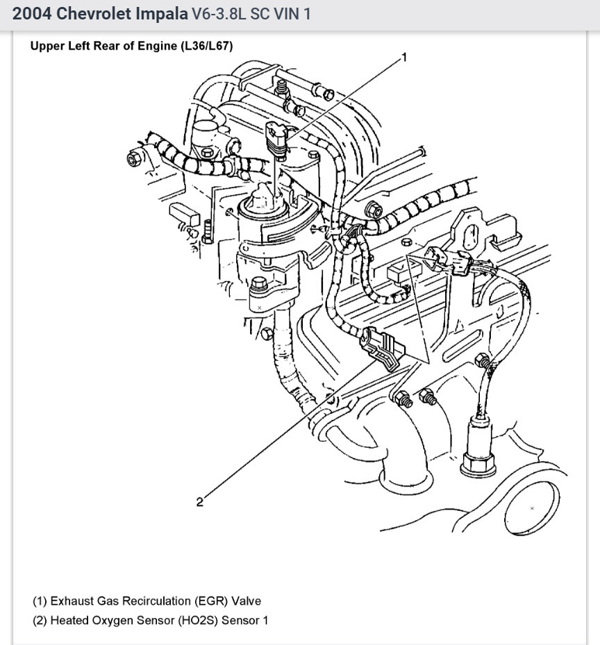

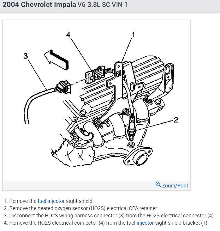

Heated Oxygen Sensor (HO2S) Sensor 1 (3.8L VIN K & VIN 1)Above exhaust manifold. See Fig. 56.

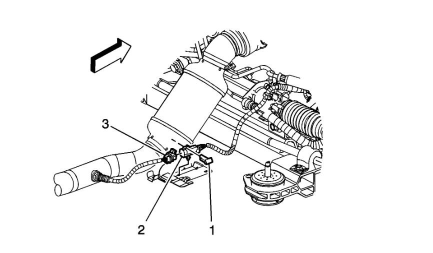

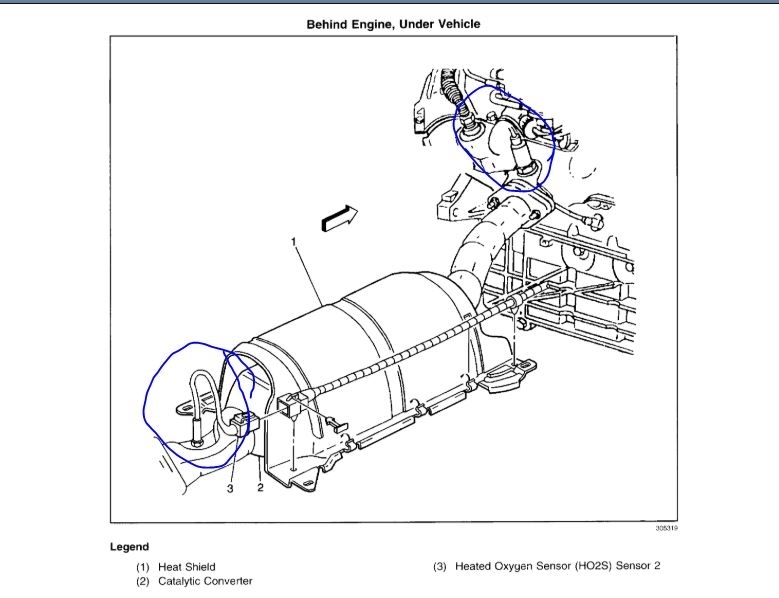

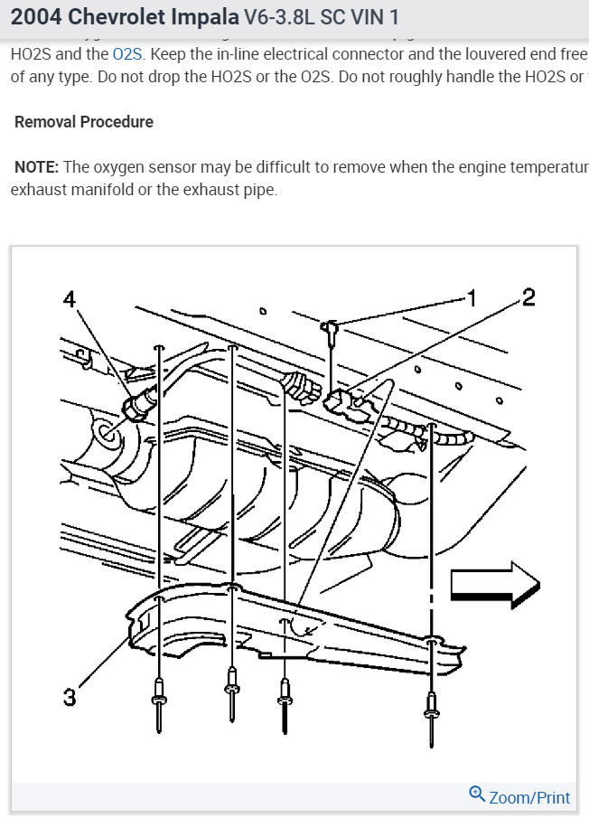

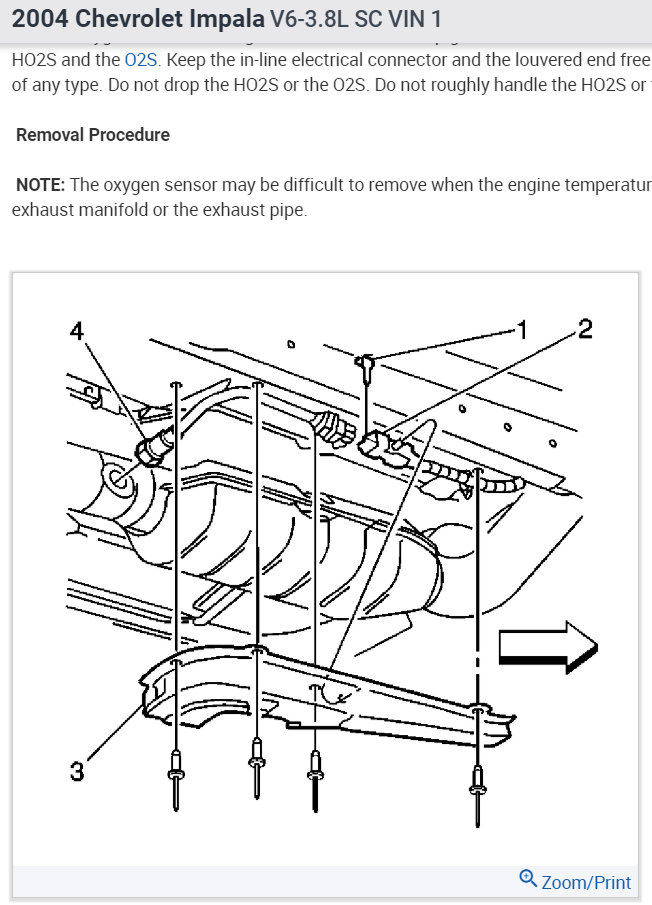

Heated Oxygen Sensor (HO2S) Sensor 2 (3.4L VIN E)In exhaust system, behind catalytic converter. See Fig. 45.
Heated Oxygen Sensor (HO2S) 1 (3.8L VIN 1)In exhaust manifold, rear of engine compartment. See Fig. 31.
Heated Oxygen Sensor No. 2 (3.8L VIN K)In exhaust system, behind catalytic converter.
