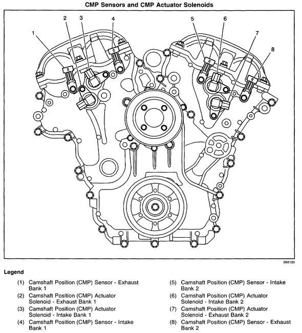

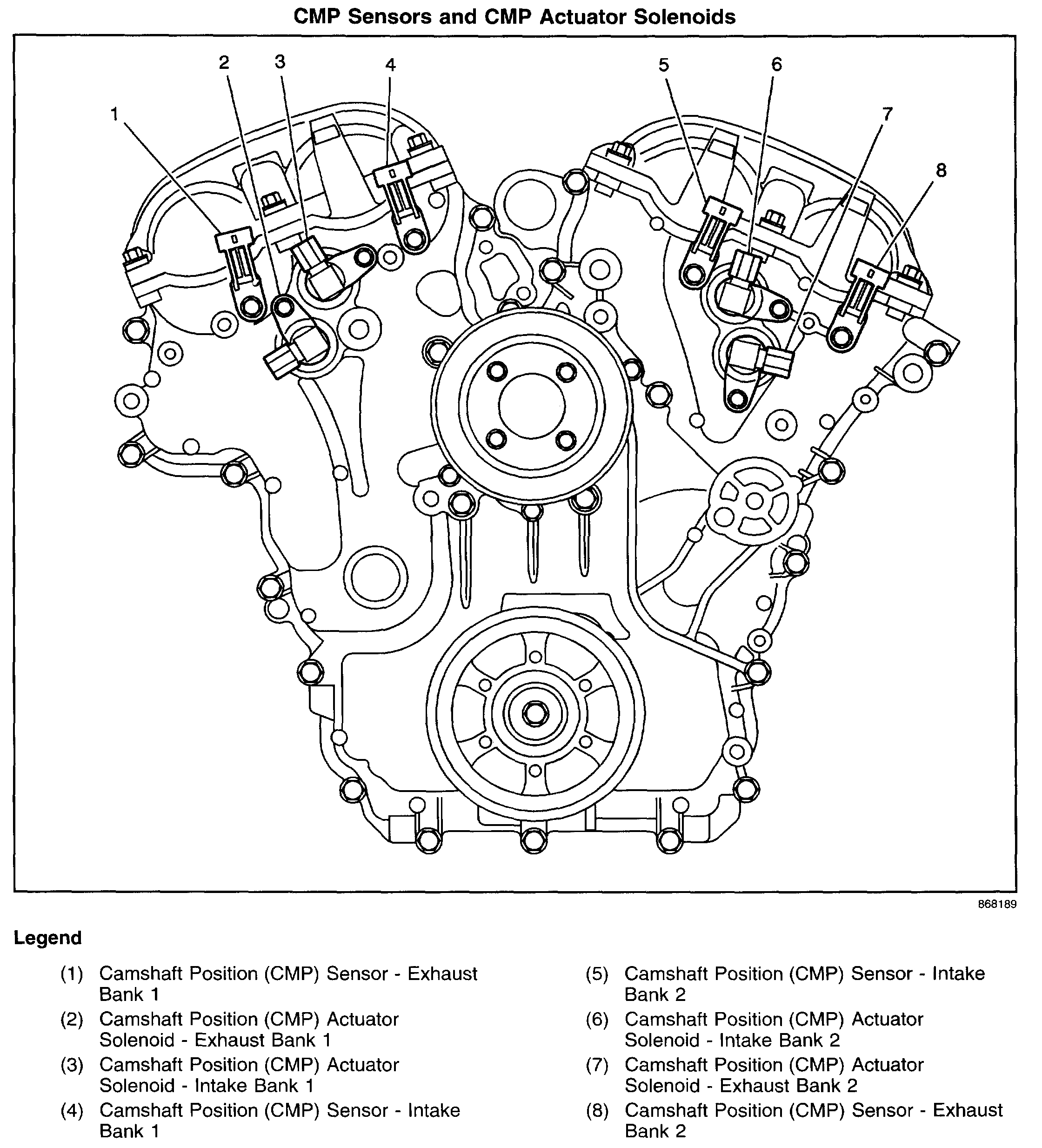

So there are two on the left side up front. I had an error code P0021 Bank 2 camshaft timimg over advanced bank 2
Apr 29, 2019 at 2:43 PM
CERTIFIED EXPERT
110,175 POSTS
Welcome back:
Take a look at the attached picture. It shows where the sensors are located. Bank 2 is on the right side of the engine when facing the front of the engine. There is a legend at the bottom of the picture identifying each component
Let me know if this helps. By the way, the pic is specific to your vehicle.
Image (Click to enlarge)
