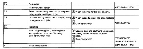

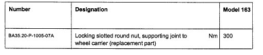

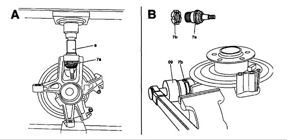

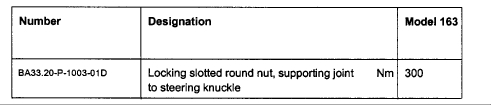

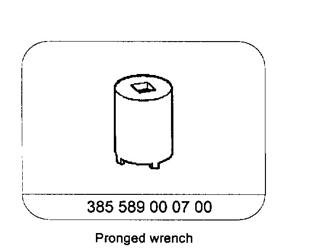

As far as a cost, this is not a cheap vehicle to maintain. Additionally, I do not know which ball joints are bad or how many are bad. Regardless, if only one needed replaced, I would expect the price to be around $250.00 which can vary based on your location and where you take it. If you want to try to replace them yourself, I have attached the directions. However, make sure this is something you feel comfortable doing. If a ball joint fails. you may lose steering.

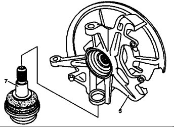

NOTE: Picture 2 contains the replacement procedures from Alldata.
____________________________________________

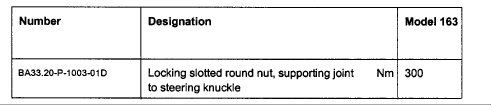

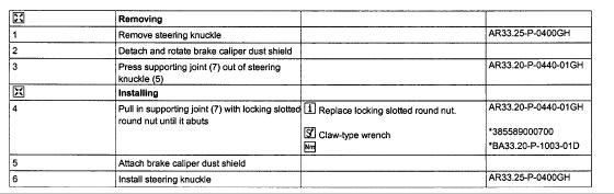

The next pictures are for the wheel carrier joints. Picture 6 lists those directions.
