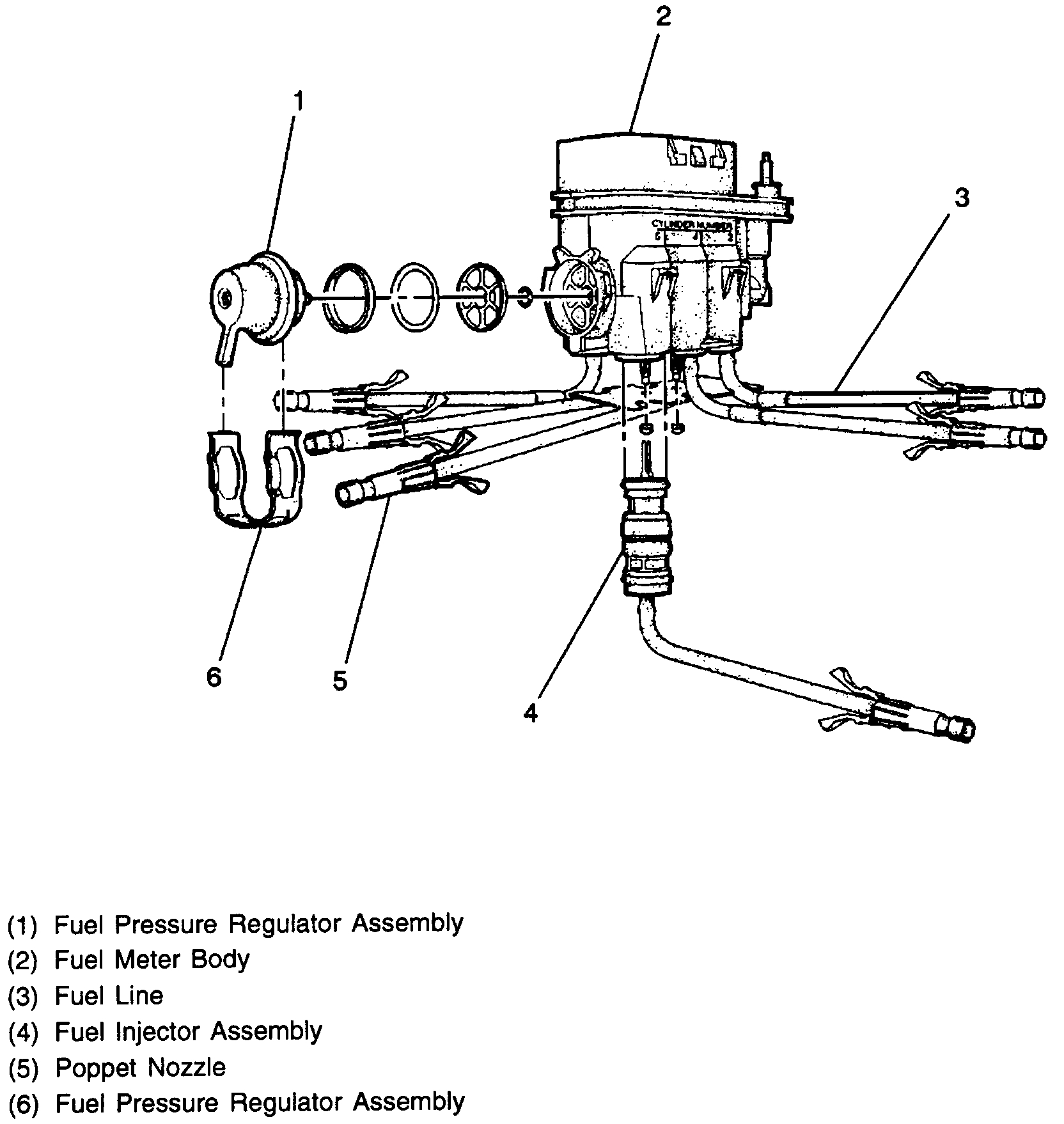

After thought. See if you can turn the engine by hand. If you cannot remove the spark plugs and try. I question if he filled the cylinders with gas. Check to see if the engine oil smells like gas. I attached a picture of the regulator. Did he put everything back together with it correctly?

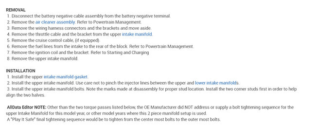

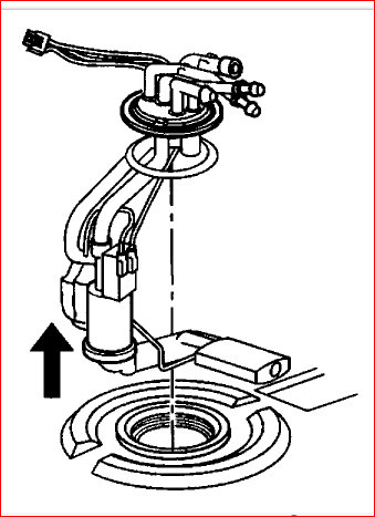

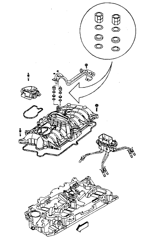

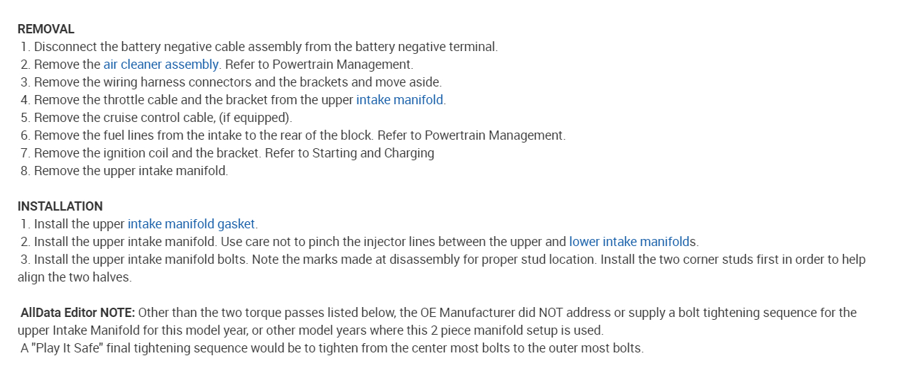

Yep, there is a seal that goes back there to stop vacuum from leaking. Can you take the upper intake back off to inspect? Here are diagrams to help. Check out the diagrams (below). Let us know what happens and please upload pictures or videos of the problem.
Aug 20, 2018 at 8:59 AM

Yes, it sounds like your fuel pump is on its way out. It should maintain 50-60 P.S.I at all times. To gain access to the in-tank pump you have to remove or drastically tilt the truck bed to gain access. Hope this helps and thanks again for using 2carPros.
