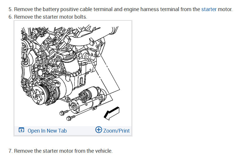

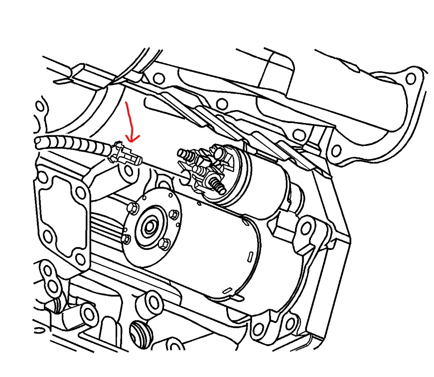

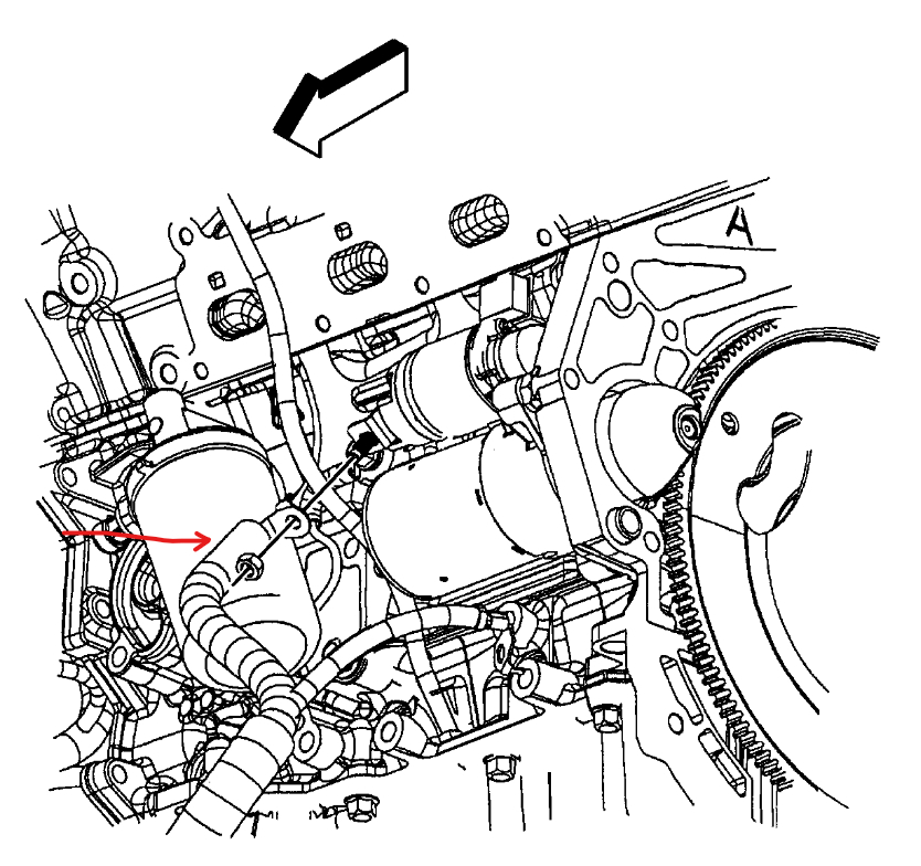

If the starter motor turns it should engage the flex plate unless the battery is weak, can this be the cause? I would take the battery to the auto parts store for testing, so we don't go in the wrong direction, here is how to change the starter out and where the wires go. Also, please go over this video as well:
https://www.youtube.com/watch?v=lXLJbuAZ4CE
Check out the images (below). Please let us know what happens. There are only two wires that go to the starter FYI. Please upload a short video of the starter making the noise so I can hear it.
