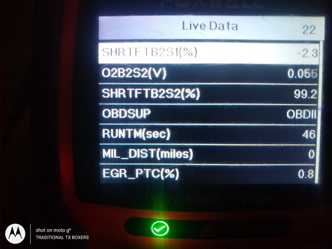

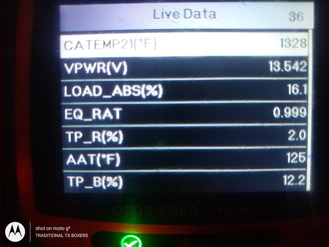

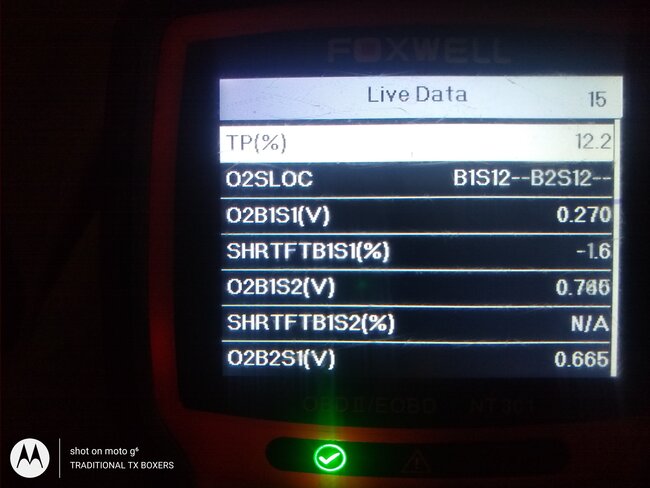

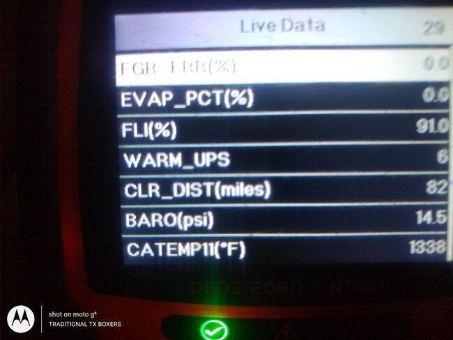

Hey Joe,

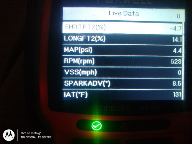

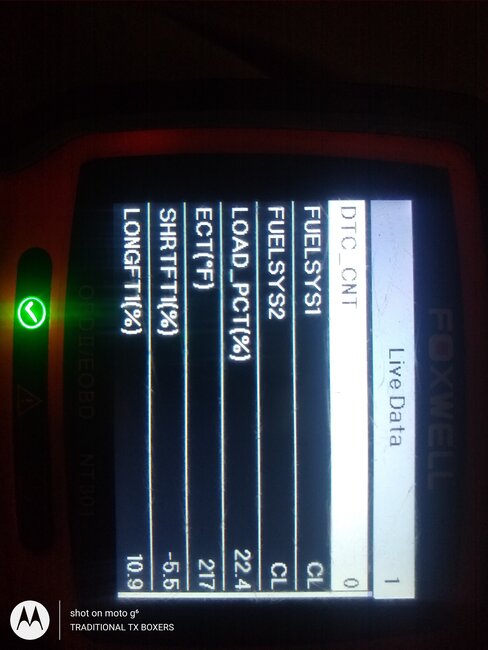

SHRTFTB2S2(%) 99.2
SHRTFTB1S1(%)-1.6
SHRTFB1S2(%)N/A
SHRTFT1(%)-5.5
SHRTFT2(%)-4.7
Yesterday i was under the hood and heard a loud air release like a big truck does letting air off the brakes, not as loud but loud! no codes. It came from drivers' side almost sounded like the intake gasket. i sprayed carb cleaner around and did not disrupt the idle at all? earlier today i got into traffic and had to get over but someone wouldn't let me. so, i gave her a little shove and she hiccupped but went! Also, yesterday i was checking for vacuum leaks and she just quit running, started back up no problem, but she did it again a little later but started right back up? She's not getting hot have bad MPGs though. about 2 MPG less than usual. i recently replaced the valve cover gaskets and plug o-rings because # 2 plug was under oil in the well. a couple times I've smelt bad smell like the cats were clogged but they are new. i did get codes last week for P2096 and PO153. They haven't come back yet. thanks Joe.
Jul 28, 2023 at 10:33 AM

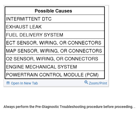

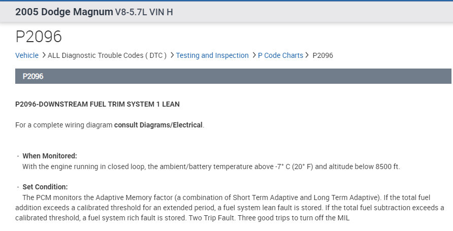

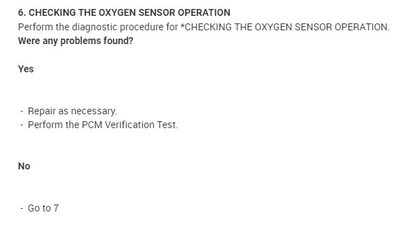

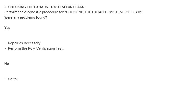

Is the STFT (B2S2) reading in pic 2 accurate? If that is, a significant vacuum leak in the intake system can result in unmetered air entering the engine. Also, a malfunctioning MAF sensor might provide incorrect readings of the incoming air, leading to improper fuel delivery and extremely positive fuel trim values or the fuel pressure regulator has failed.

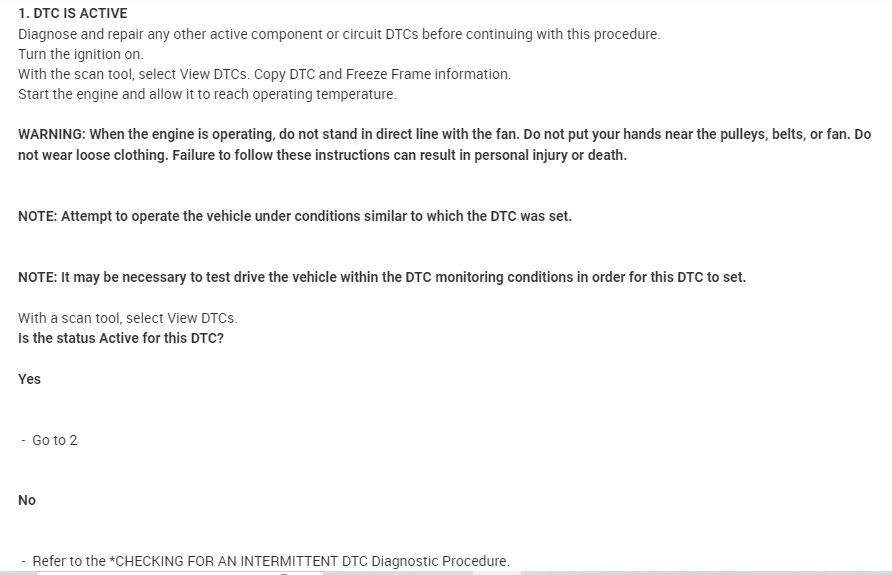

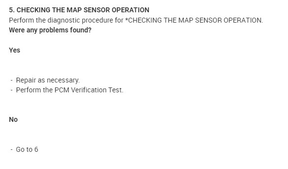

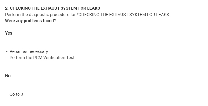

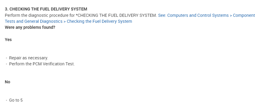

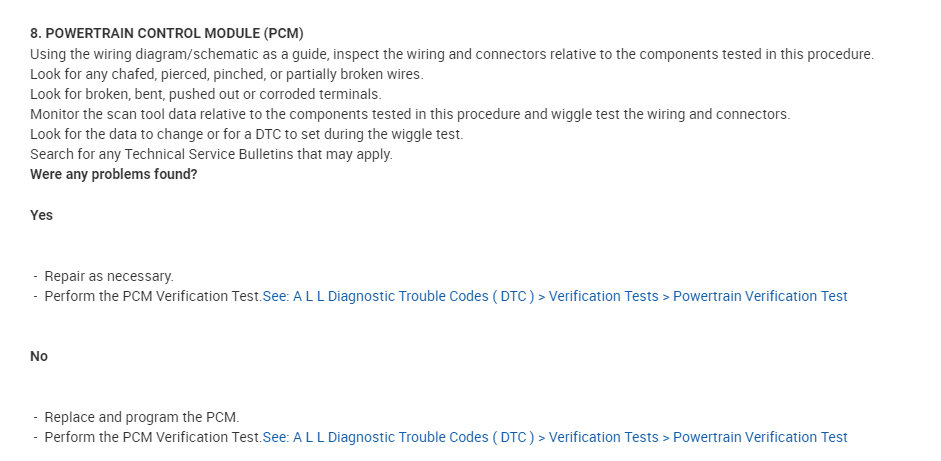

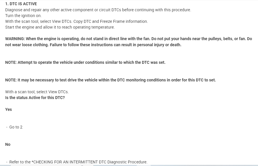

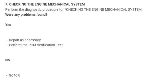

The P2096 is specific to a lean fuel mixture. So, I attached the diagnostics below specific to the code and your vehicle. You mentioned the converters are new. Are there any exhaust leaks pre-catalytic converter? Let me know.
Take a look through the diagnostics below and let me know if you are comfortable performing them.
See pics below.

There is an exhaust leak but it's not after the downstream, it's at the flange between the o2s! i changed the purge valve. it seems to be doing good, for now. It runs really good, real responsive throttle. better than it has ever been without a tune. i noticed on one of the parameters for the shrtft it had N/A, what's that about? it has always been like that, is it normal?

Where is the exhaust leak? Is it before the downstream sensor?
Jul 28, 2023 at 10:21 PM
WILLIE HURLOCKER
  • 83 POSTS
yes, between the up and down at the flange pretty sure on both sides.
Jul 28, 2023 at 11:45 PM
That is the likely cause of the lean fuel mixture. If you have an exhaust leak before the sensor, air enters (believe it or not) and the sensor sees it as a lean mixture.
I'm not sure what needs to be repaired, but that is where I would suggest starting. Let me know if I can help.

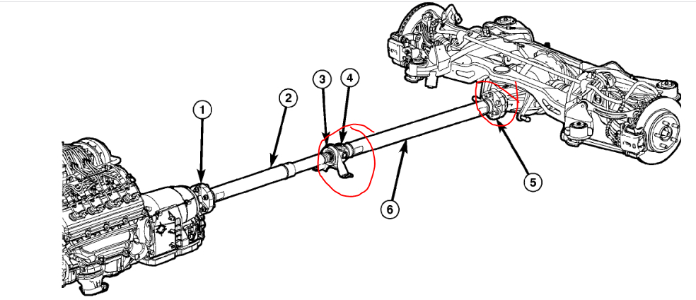

When you replaced the rear drive shaft, was it with a new one? I ask because the rear drive shaft service is limited to center support bearing and coupler replacement only. The rear segment single-cardan universal joint is not serviceable.
Did you replace the center support bearing? See pic below.
Also, if the noise is loud enough to record, do so and upload it for me to hear.
See pic below.

The flex disks and drive shaft i replaced are new so it's not the u joint also carrier bearing. there is slack in the rearend yoke, think that could make the sound? I've sent audio before, but I'll try to send more. i also marked the shaft before taking it off but it was pointless because it was all new. there is no vigratn at all so for once i got something right somehow the first time. The car rides really rough and hard like I'm rolling on just the rims with no tires on?
Jul 31, 2023 at 7:15 AM
As far as the rough ride, are there any suspension issues? Have there been any modifications to the suspension? Also, the noise you described is likely a bearing in the differential. The pinion bearing would be my first suspect. Do you have any gear oil leaking where the pinion seal is located?

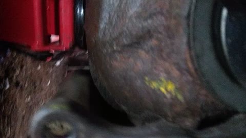

Is there supposed to be this much play?
Aug 1, 2023 at 2:27 AM
WILLIE HURLOCKER
  • 83 POSTS
is there supppose to beeeee this much play?
In a perfect world, there shouldn't be that much play. It is a bit excessive. I assume I am looking at the rear pinion shaft. It's a little hard to see in the video. That play is taken up when the ring and pinion are installed. Adjustment is made at that point.
