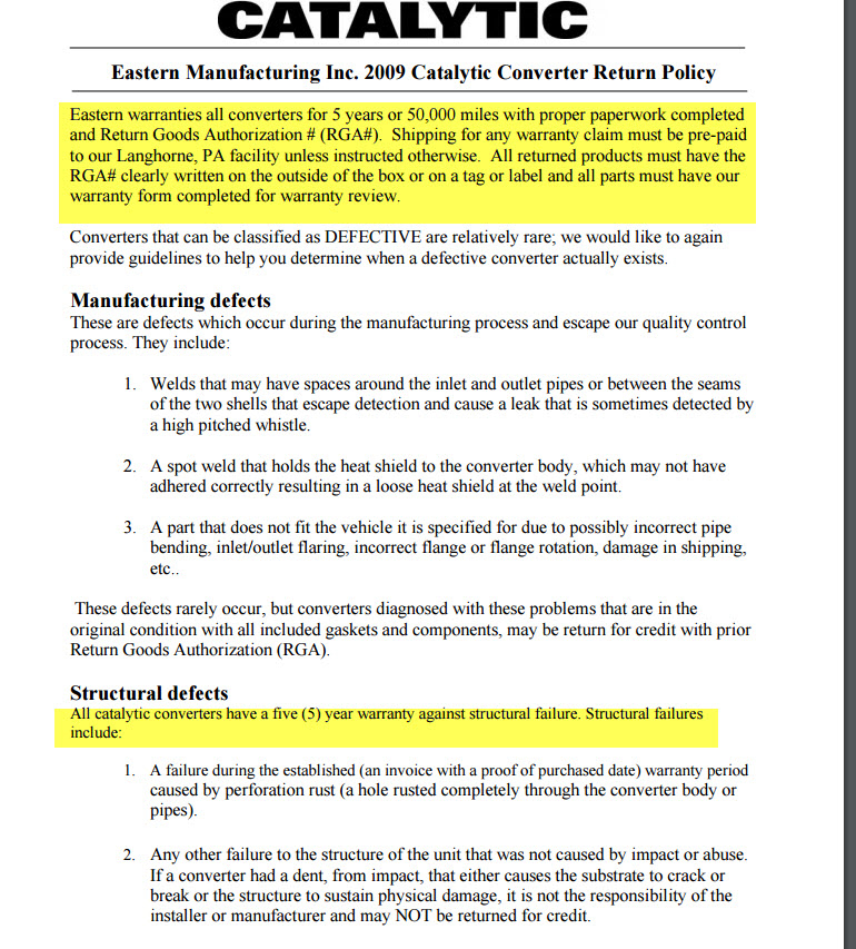

take this vehicle to another shop other than the one that it was repaired at. iforgot to send the pics I printed regarding converters. they are warrantied for that your problem should be tested with the information that I sent to you in previous replies. read this pic. I think you are asking for more trouble if you take this to the same shop. they shouldn't burn out like that . I don't know what else to tell you so I have no other comments or suggestions.

thank you very much. I appreciate your help! One last question...it is an aftermarket...is the warranty you attached good for aftermarket cats as well? I am taking it to another shop. Thank you!!

the warranty that I posted in the pic is from an aftermarket cat maker. and amen to what cardio doc is saying. that is only one maker others are different but most have a warranty they have to by law. I have nothing else to say.
