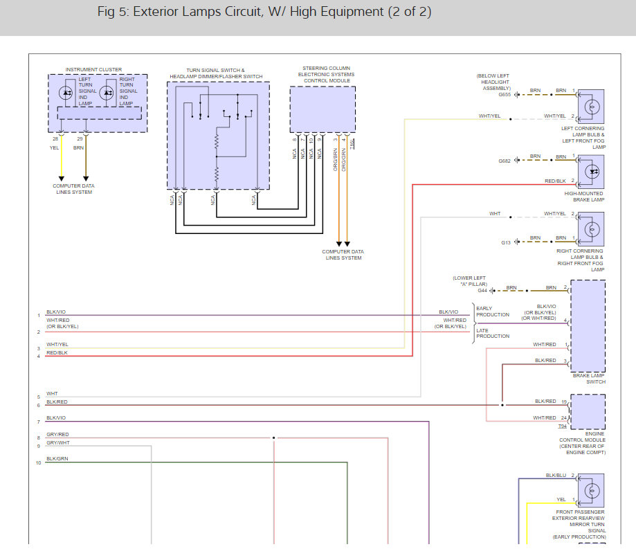

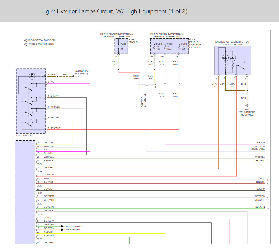

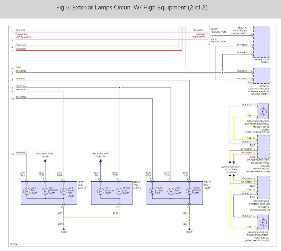

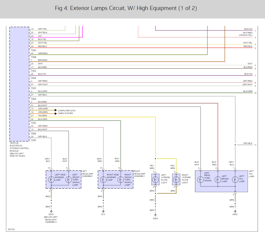

It sounds like you have a lighting module located on the under side of the dash on the right side that is going out but to be sure lets remove the electrical connector and check it for corrosion. Here is the wiring diagrams for the lights so you can see how they work.
