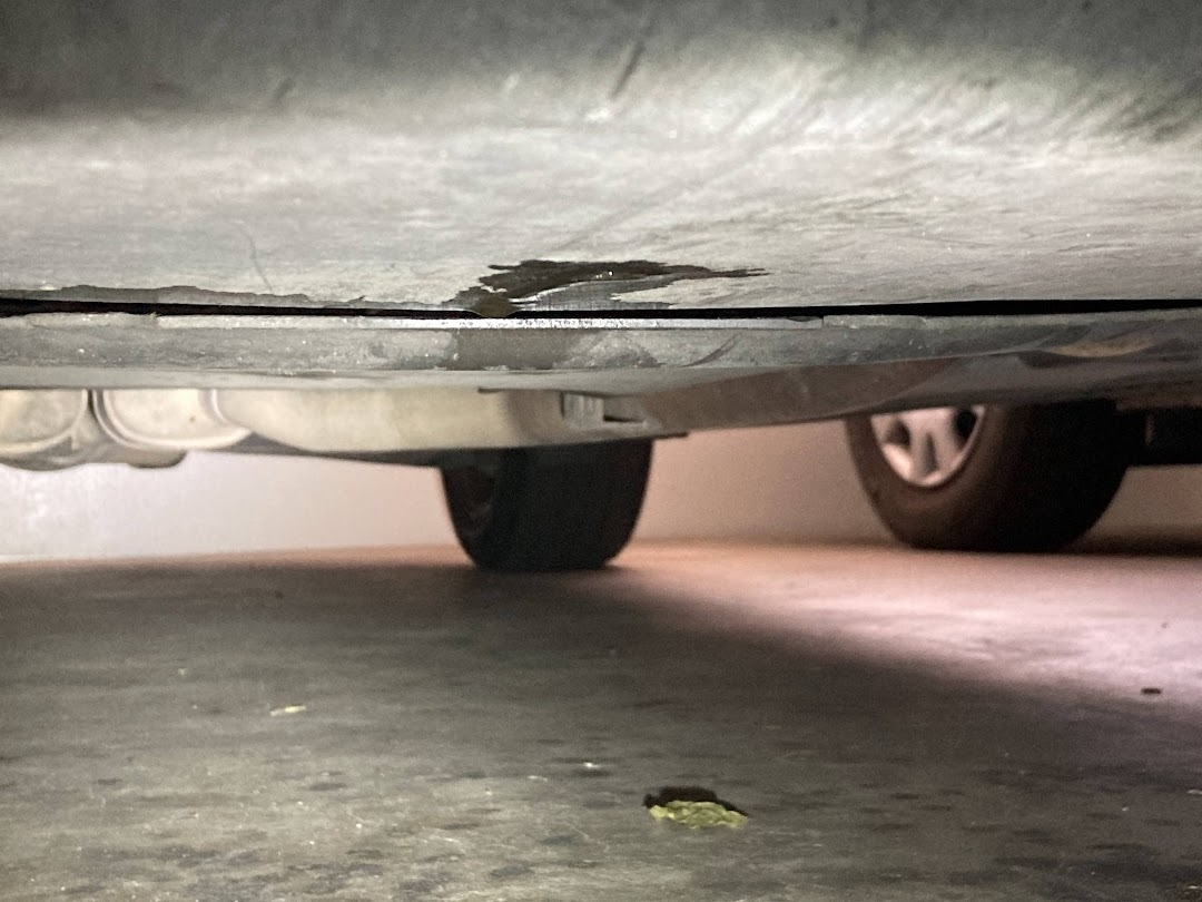

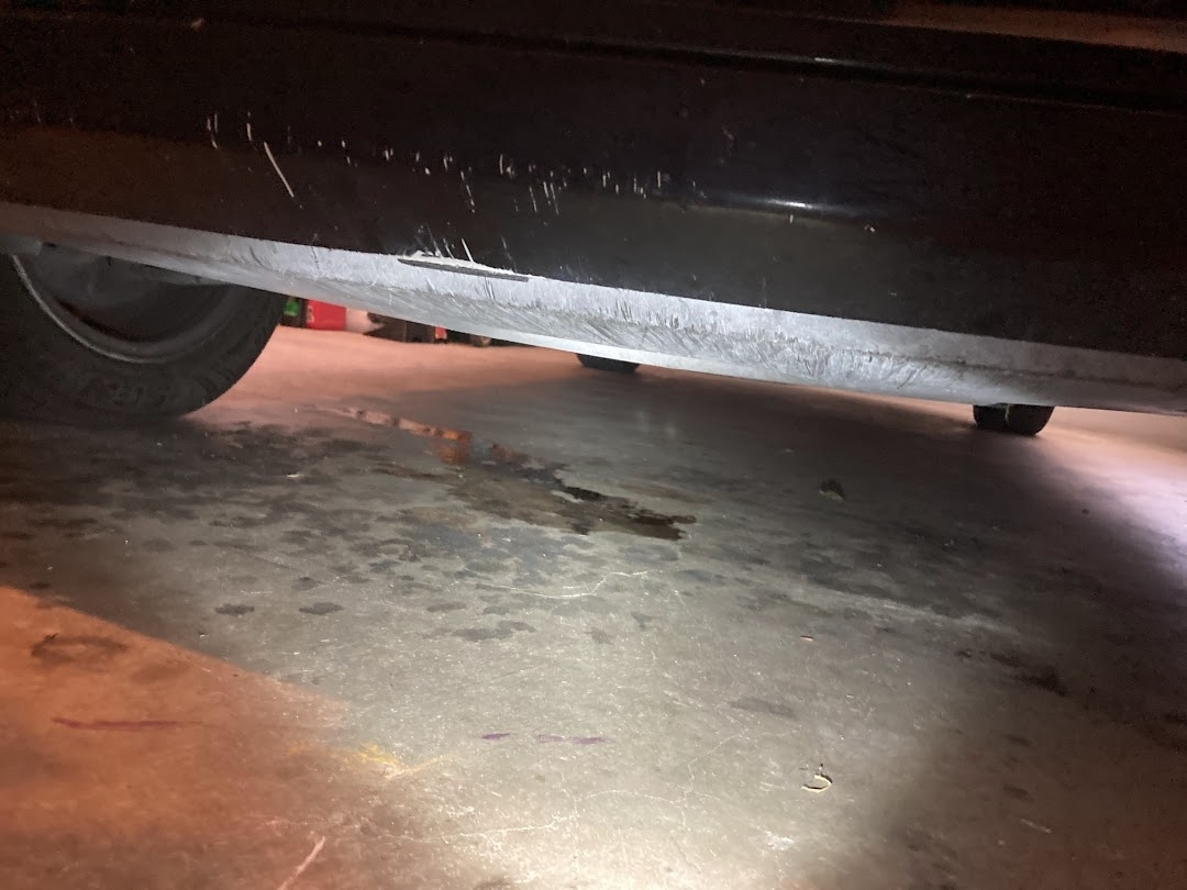

Recently, an oil leak has developed towards the bottom of my car. It has gotten really bad and has started leaving puddles everywhere.
I was wondering where it could possibly be leaking from? I've checked the valve cover gaskets so far and they are all good. I am suspecting it is possibly the oil pan gasket or the drain plug washer, but I am not sure.
I haven't jacked up the car yet. Before I do, is there some sort of common area that these Mercedes tend to leak oil from?
I have some images of the leak to hopefully give you guys a better idea of where it's leaking from.

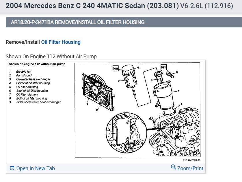

Thanks for the images. The oil filter and oil pan drain plug is a common place for the engine to leak oil. Here is a guide that can help find the leak as well:

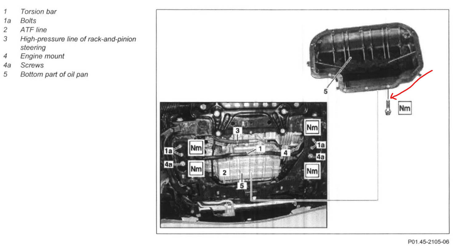

I would raise the car up and remove the bottoms skid pan. Use a flashlight to see if you can find the source of the leak. This guide can help:
