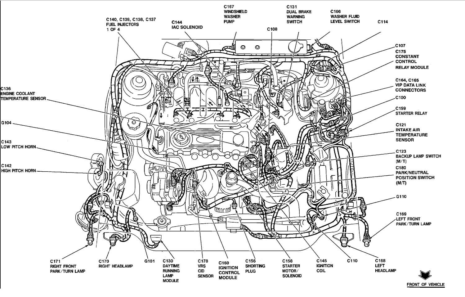

It sounds like you have an engine coolant temperature sensor issue. I would try changing the sensor.
Here is a guide and the location (below) to get the job done:
https://www.2carpros.com/articles/coolant-temperature-sensor-cts-replacement
Here is the location.
