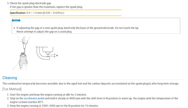

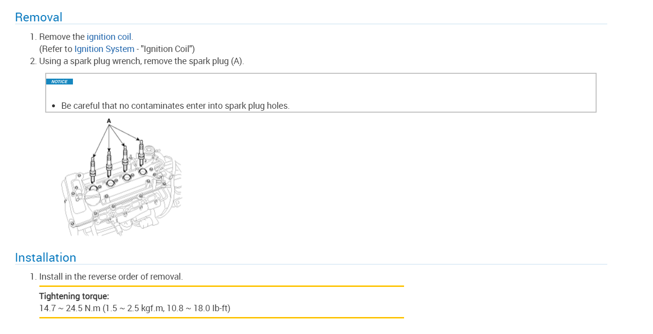

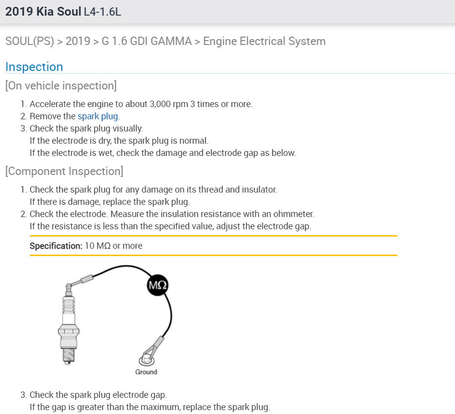

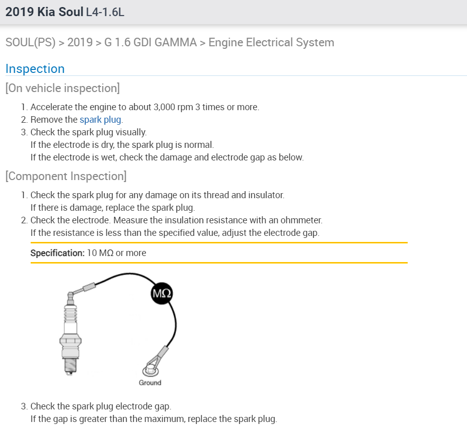

Yep, so the OEM spark plug must be used when doing the tune up, not a substitute spark plug, the resistance in the spark plug is important as it controls the ignition timing which most people don't know. Here is the part number of the plug you should be using and how to change them out in the images below. Also here is a generic spark plug replacement guide to help you with the job as well:
https://www.2carpros.com/articles/how-to-change-spark-plugs
2.0 Spark plug Type - SILZKR7B11
1.6 Spark plug Type - SILZKR6B10E
Gap (0.035 ~ 0.039 in.)
