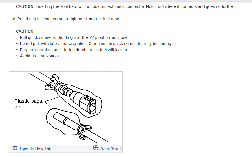

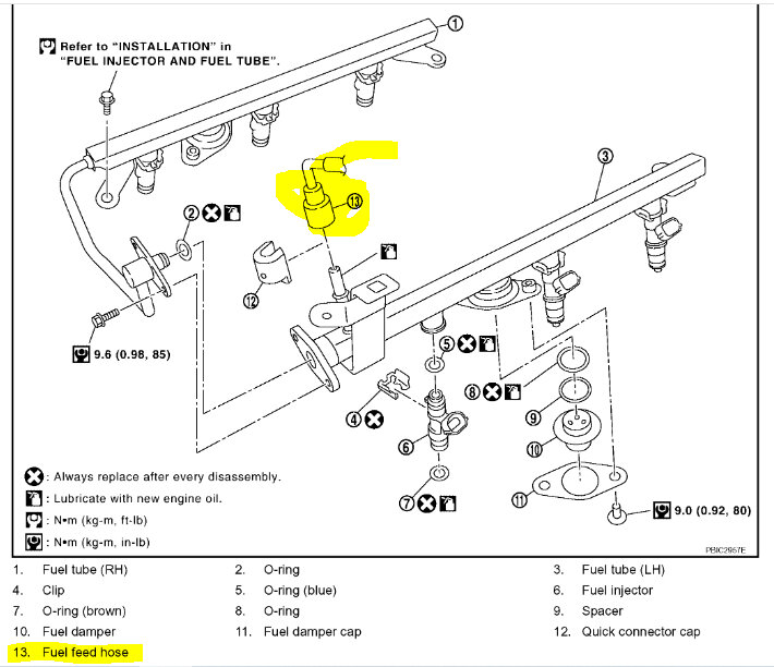

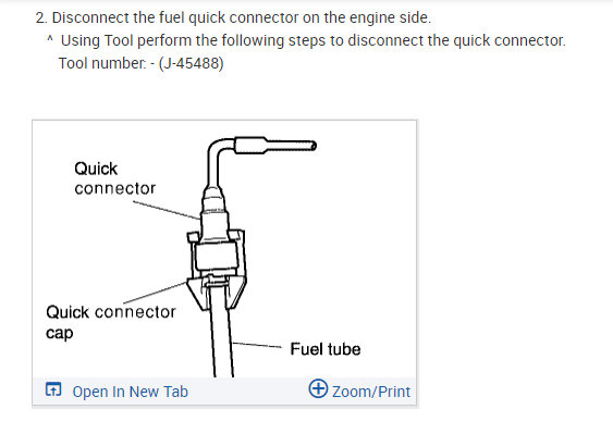

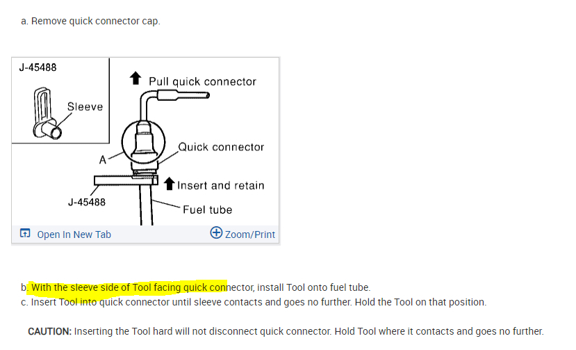

Hi Jerry,
I attached a pic below showing the fuel rail and I highlighted the supply connector. Once the fuel pump is removed and the tank is empty, you can blow air back through the supply hose to the tank.
To disconnect it, a special tool is required. I attached directions for disconnecting the line starting at pic 2.
Let me know how things turn out for you. I hope you had a good Christmas as well.
See pics below.
