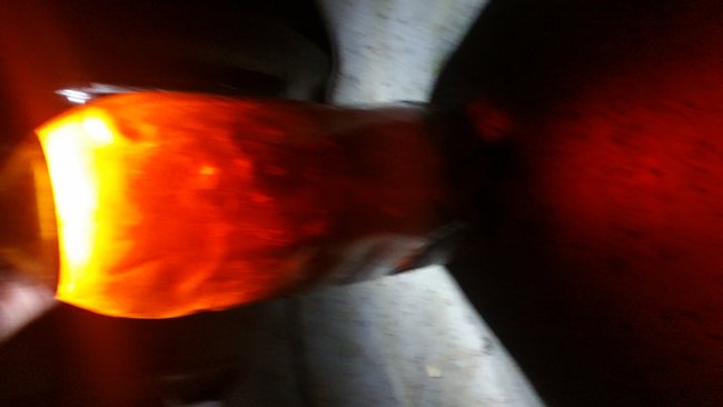

I changed my fuel pump this past winter. when I pulled out the fuel pump assembly out of the tank and i notice that the gas looked blood red and a subsist that looks like oil, but it's not oil. I don't think. I don't know what it is. Any ideas? What should I do? I've never seen gas look like this before.

Can you post a picture of the fuel? I want to see it. It sounds like it is contaminated with something.

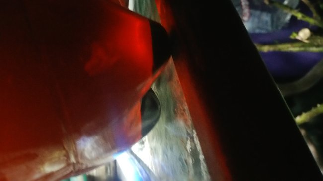

These pictures were taken at night in the garage, clear 2 litter pop bottles are the containers I held a powerful LED flashlight behind/above etc. The second picture I was trying to focus more on the black/brown substance pooled up at the very bottom if you look closely you will see what I'm talking about. I've replaced a hand full of fuel pumps in my time I've never seen gas look like this before ever!
Apr 27, 2019 at 8:22 PM
That is contaminated fuel. You need to drop the tank and flush the tank of all debris.
