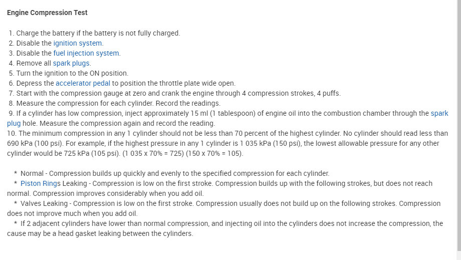

More than likely this is a failed engine. However, a few tests will tell us for sure.
Let's start with a compression check. I suspect the rings are gone but this should be the first sign. If the compression is no good then we will need an engine.
https://www.2carpros.com/articles/blue-smoke-from-engines-exhaust
