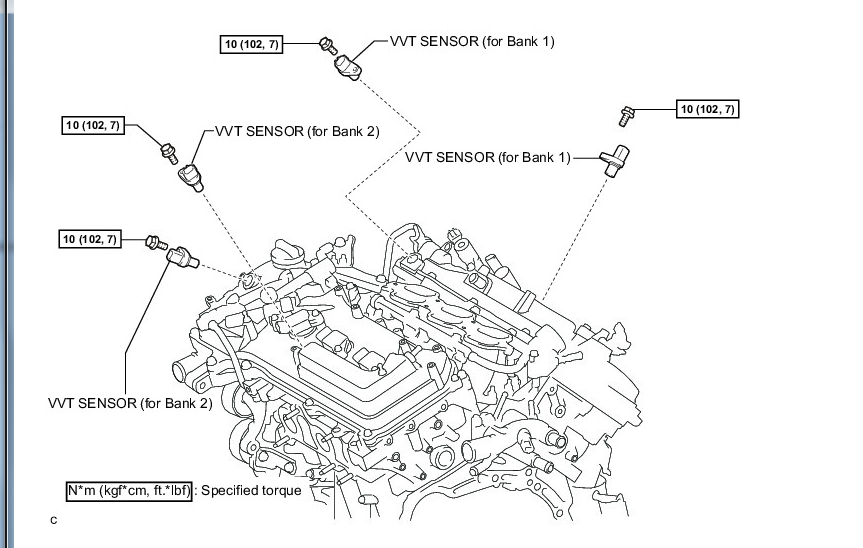

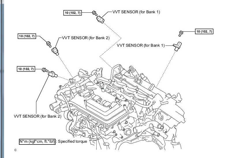

Can shaft sensor bank a was the code. replaced sensor, after driving a few miles light came on again. three one I replaced facing engine was on the back right.

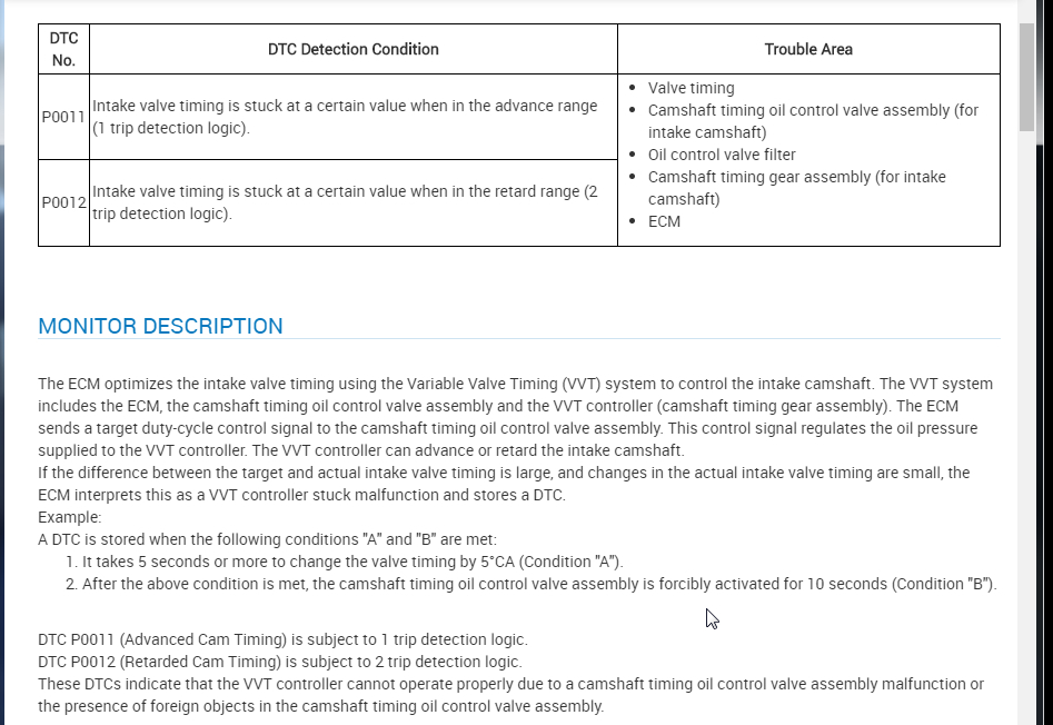

P0012.. i just know it's a 4 cylinder.
Sep 14, 2020 at 12:29 PM

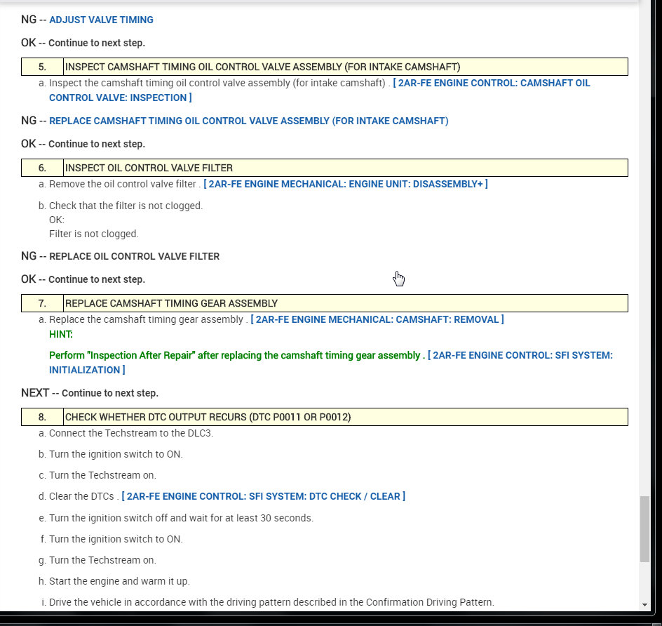

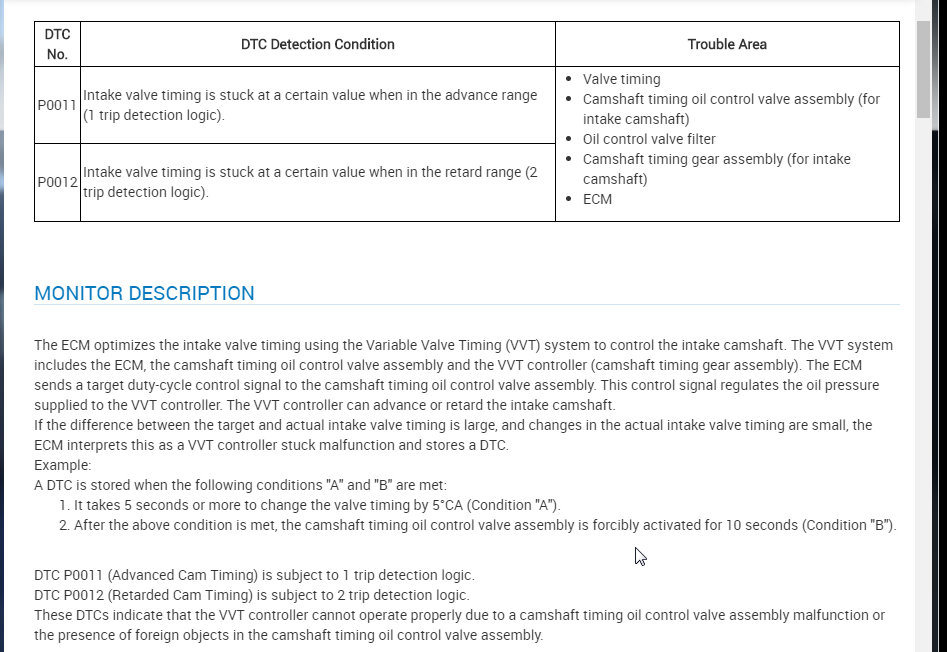

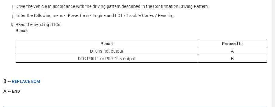

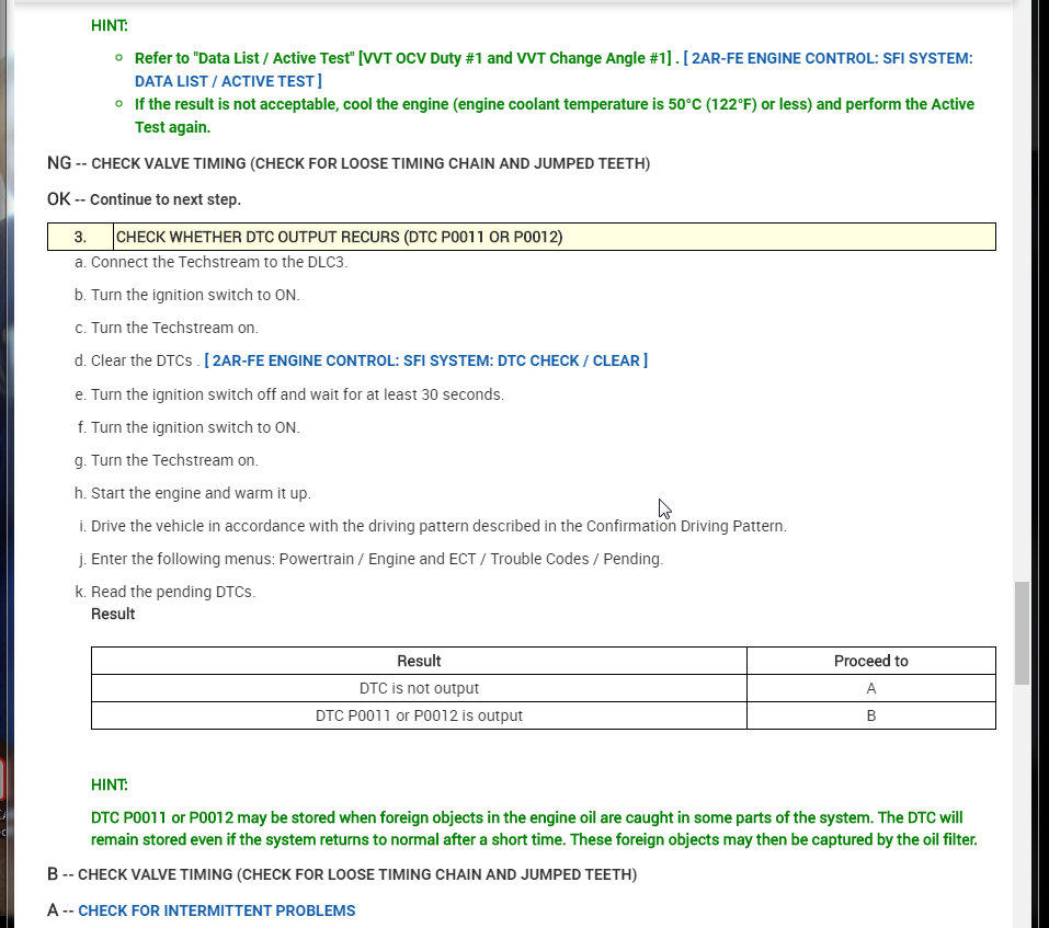

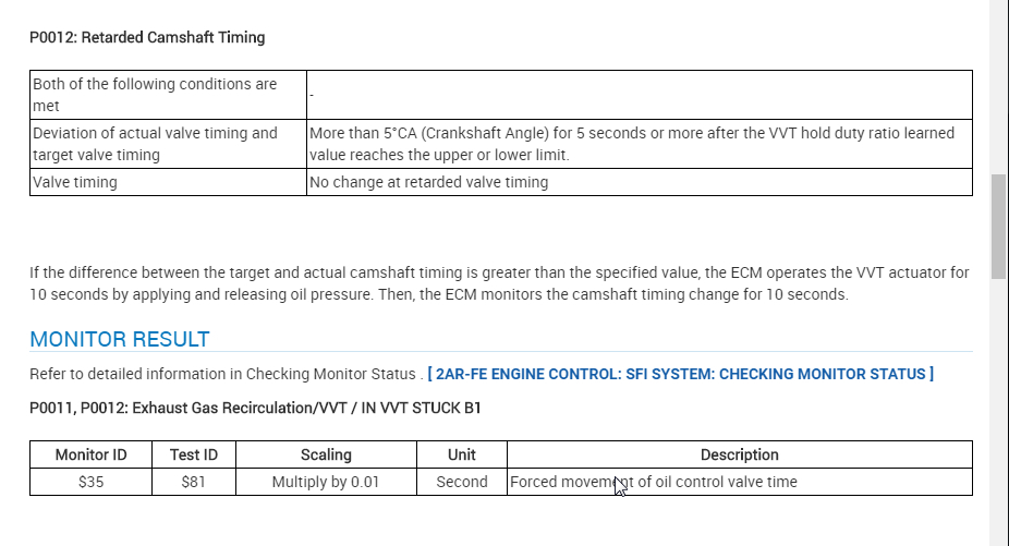

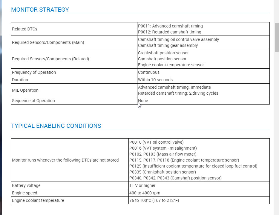

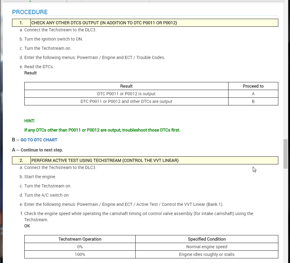

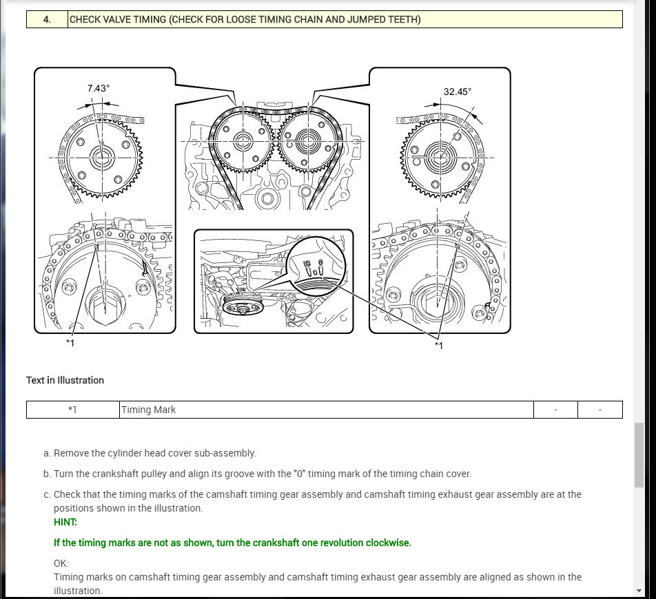

Okay. I attached the testing. More then likely you jumped a tooth in the timing and it is setting this code. We need to run through all this testing and see what happens. Clearly we can't guess at it as there is not a next most likely cause. Normally it is a sensor but we need to run through this to find out where the issue is.
Let me know if you have questions. Thanks
