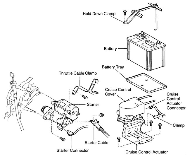

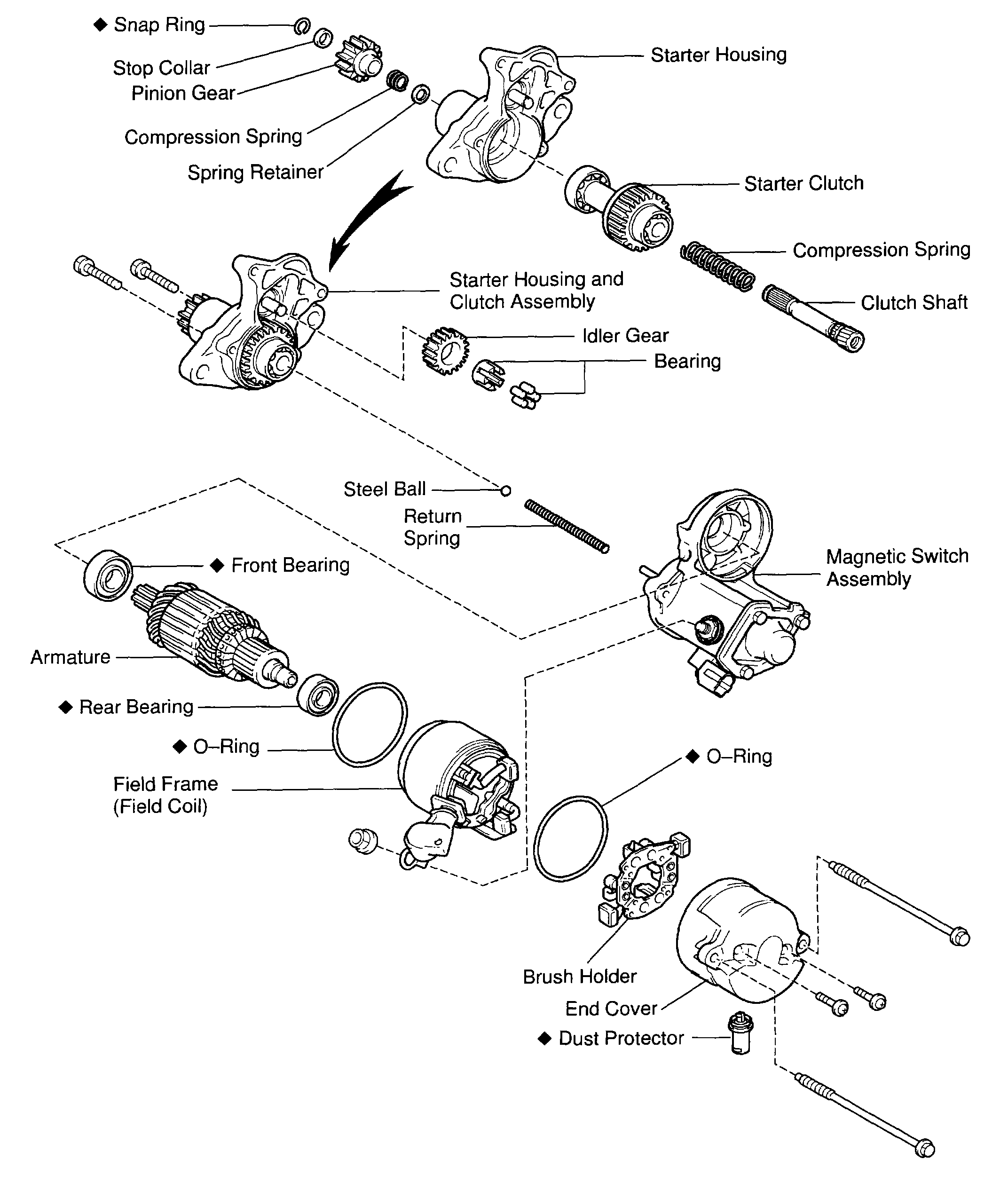

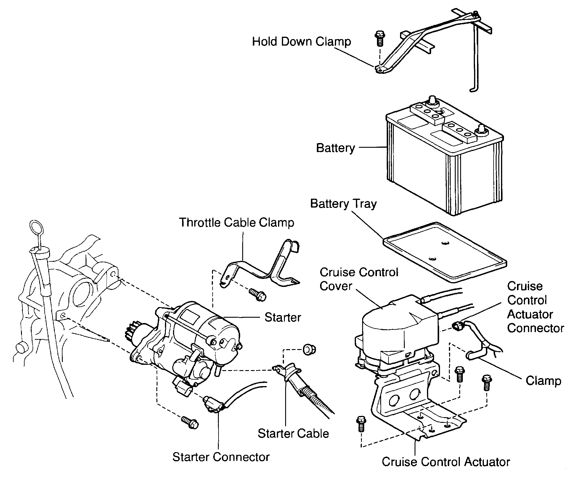

Here are the directions for removing the starter. Also, there an exploded view of the starter so you can see all components.
I really feel it is a bad connection (ground at engine) or other connection or the starter itself is bad.
ON-VEHICLE INSPECTION
NOTE: Before changing the starter, check the following items again:
- Connector connection
- Accessory installation, e.g.: theft deterrent system
COMPONENTS
REMOVAL
1. REMOVE BATTERY AND TRAY
2. W/ CRUISE CONTROL SYSTEM:
REMOVE CRUISE CONTROL ACTUATOR
a. Disconnect the actuator connector and clamp.
b. Remove the 3 bolts, and disconnect the actuator with the bracket.
3. REMOVE STARTER
a. Disconnect the starter connector.
b. Remove the 2 bolts and starter.
c. Remove the nut, and disconnect the starter cable.
Torque: 39 Nm (400 kgf.cm, 29 ft.lbf)
INSTALLATION
Installation is in the reverse order of removal.
