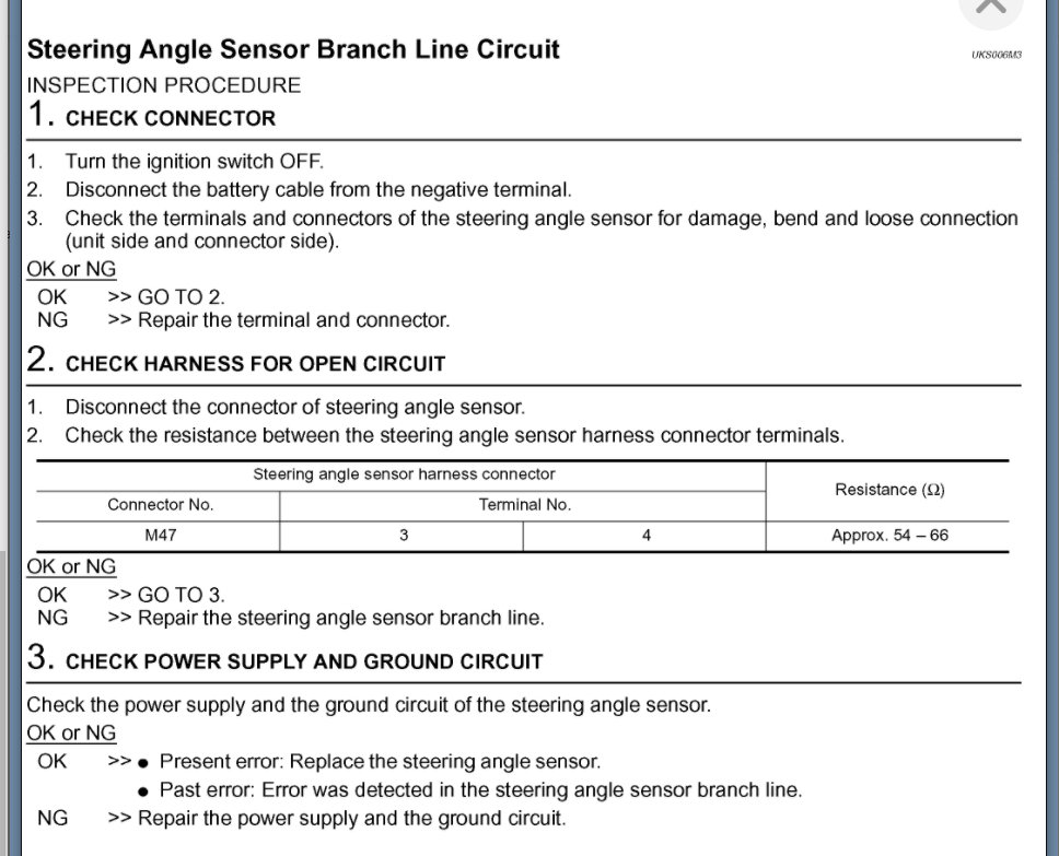

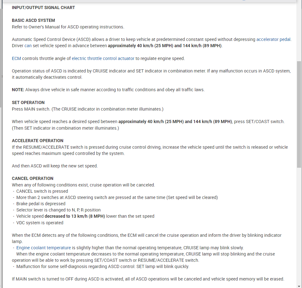

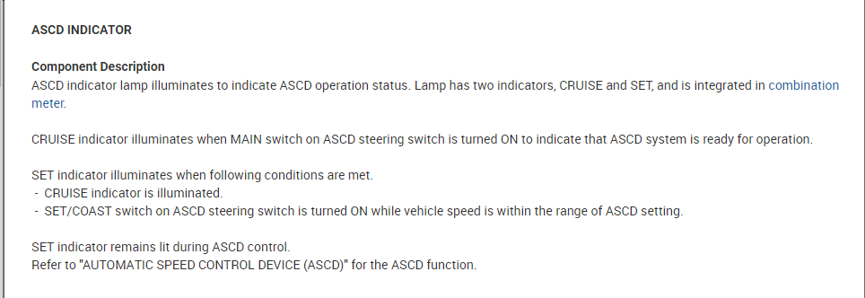

It sounds like, what they have done is test for voltage to the steering angle sensor to try and find out if it is faulty. I attached the testing below that I suspect they performed.
The only thing that gives me pause is that if the steering angle sensor is reading 0 degrees that is clearly what is causing the issue. This is because the sensor is telling the ABS that the wheel is not being turned but the wheel speed sensors are changing when in a turn and the Yaw rate sensor is changing as well indicating that you are in a turn. This conflicting data is causing the ABS to think the wheels are slipping so it applies the ABS to try and gain the control back that it thinks it lost.

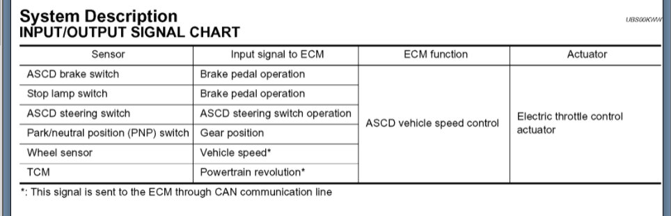

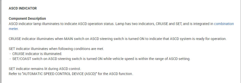

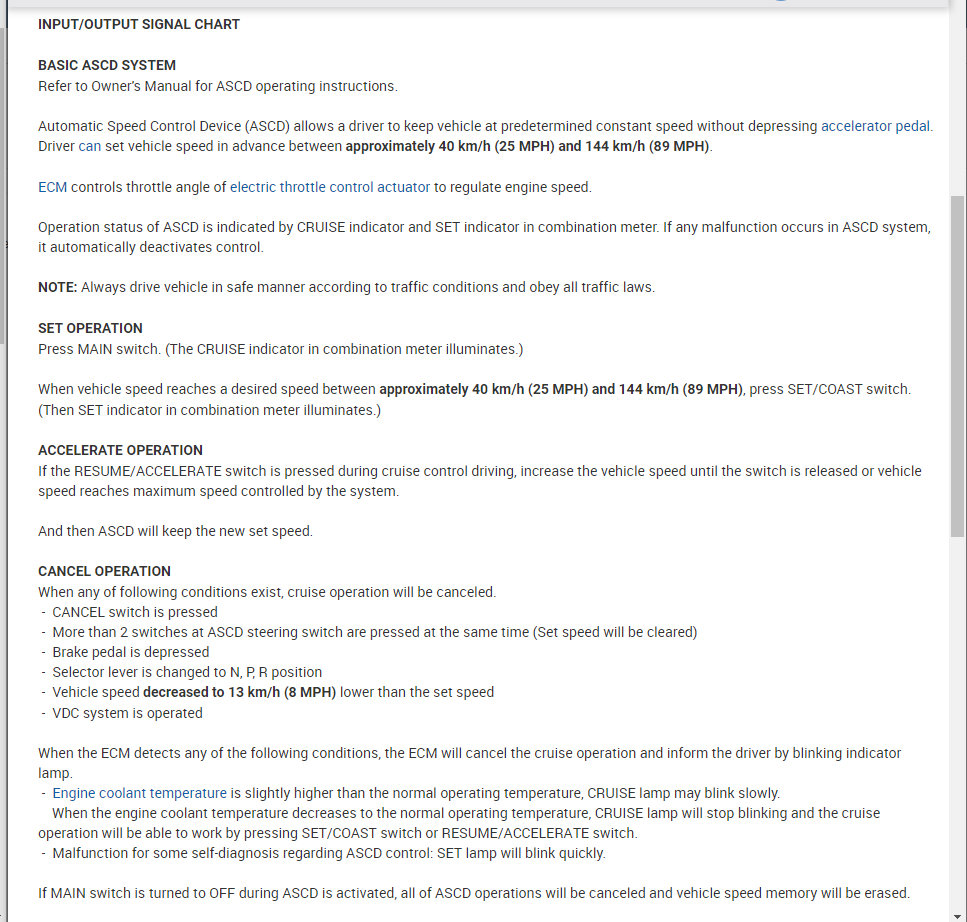

So if you read through the testing, they must have found an issue with the ACSD in order to not condemn one of the other parts such as the wiring, connectors, or the sensor.

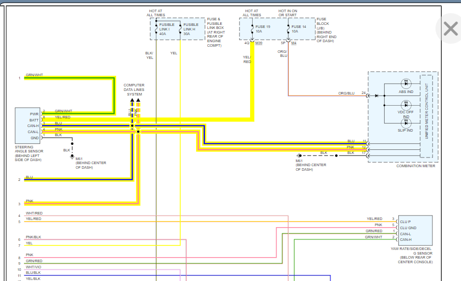

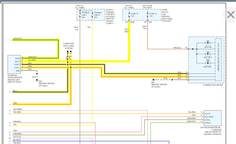

I think your instincts are correct that this is most likely a sensor issue and not an ACSD issue. The only thing that has in common with this system is the data communication lines run through the ACSD. So if the control module is not getting the signal and remaining at 0 degrees then we simply need to find out how they tested the sensor to determine it was okay.
Please run through this material and let us know if you have questions. Thanks
