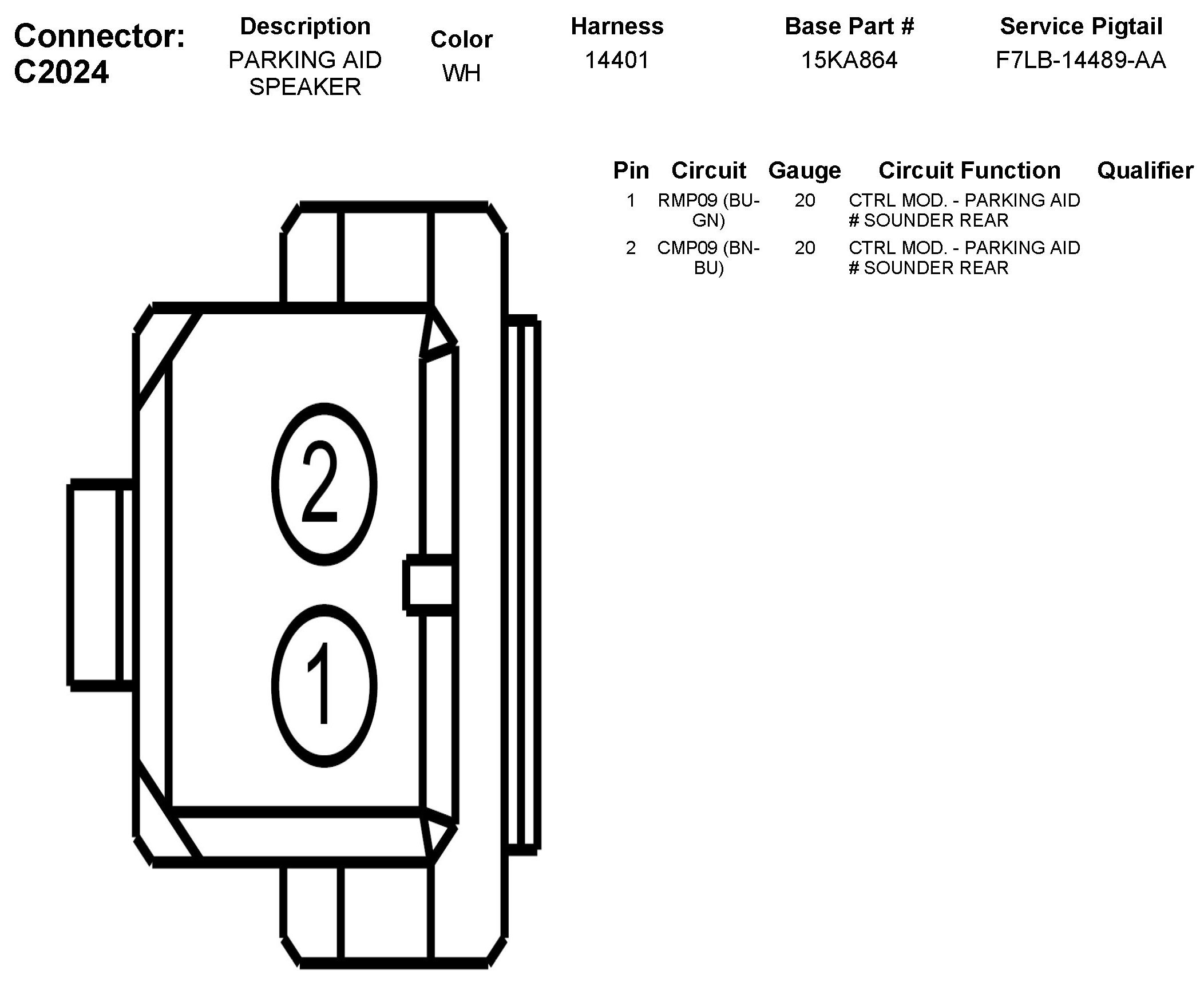

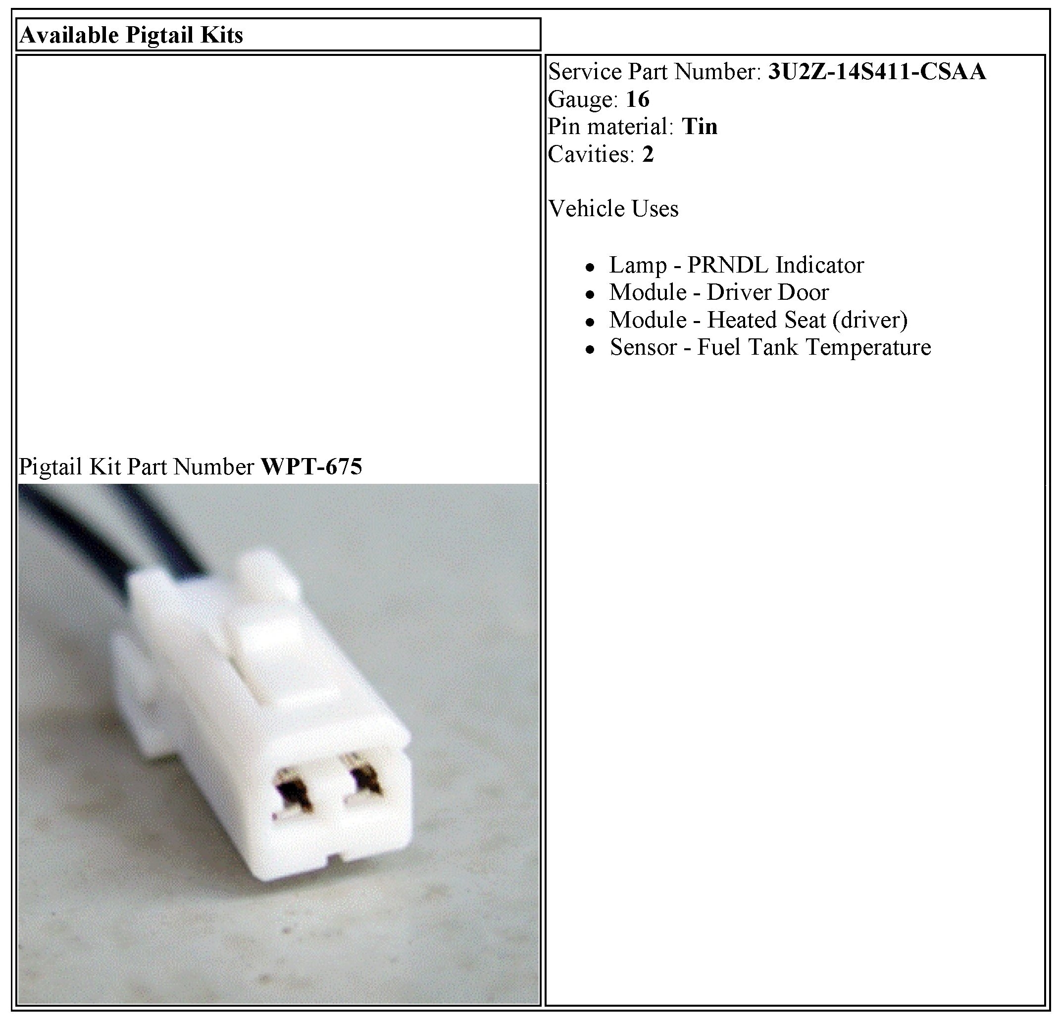

This may be a tricky one. The speaker is located in the instrument panel above the left hand cowl side trim panel near the parking brake control. There is a chance that the connector has come off or has become damaged.
It will be a two-pin connector. I attached two pics below to help you identify it. Check this first.
Let me know what you find.
