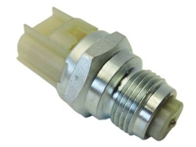

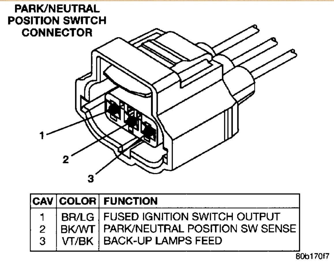

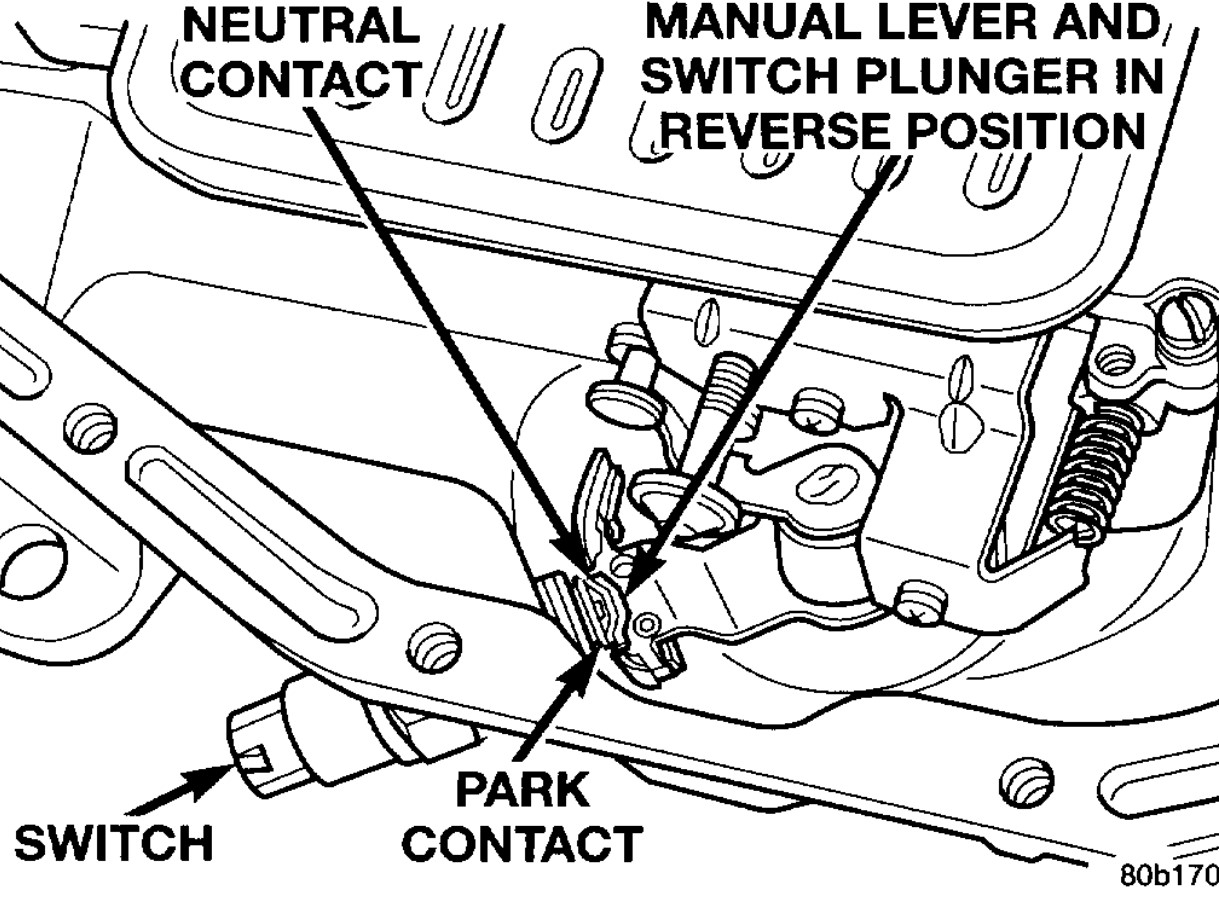

Need location of backup light switch and is it combined with neutral safety switch?
Apr 14, 2025 at 6:06 PM
STEVE W.
  • 15,113 POSTS
It screws into the transmission case next to the manual lever on the side. You put a drain pan under it; disconnect it then remove it. Screw the new one back in and verify it works.
It is tightened to 25 ft lb.
